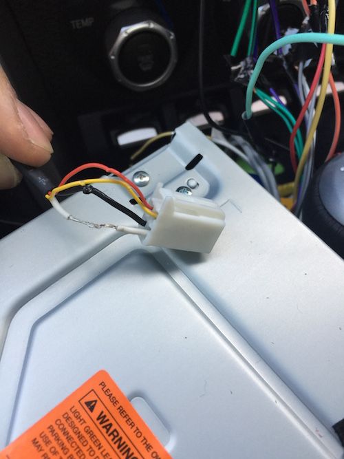

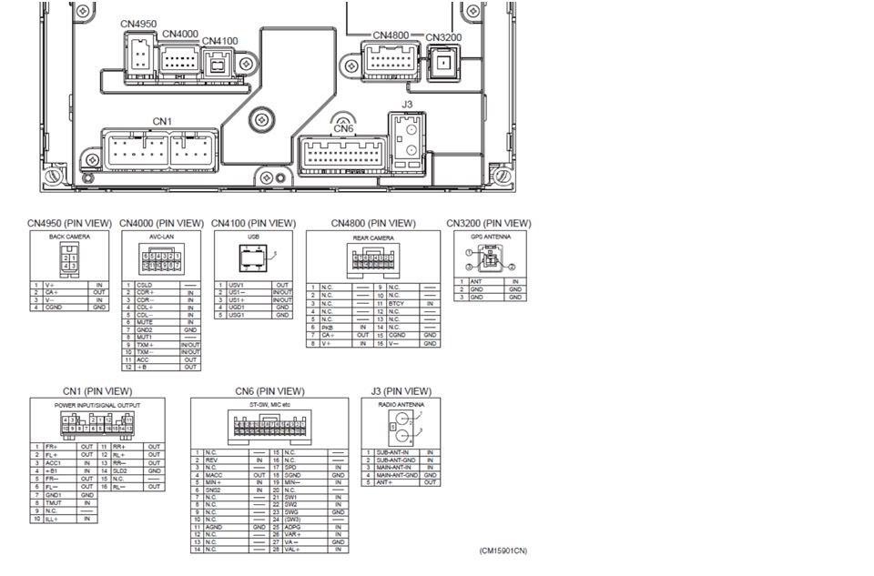

Issues are with the reverse camera. Below is a pic of the cable (CN4950).
Here's what I've tried:
1. Hooked up the black wire to the chassis negative grounding wire on the harness (using a 12v to 6v converter)
2. Hooked the yellow (VA -) and white (VA +) to a male RCA cable and direct feed in to the HU
I'm not sure where to connect the red wire (CA +)
Or have i got it totally wrong and the ground should stay with ground 12v and the red should be connected to the 6v converter?
Also, how do I set it up so it knows that I'm reversing and shows the reverse camera?
I was using the below for my wiring harness set up (Metra).
Thanks in advance.
