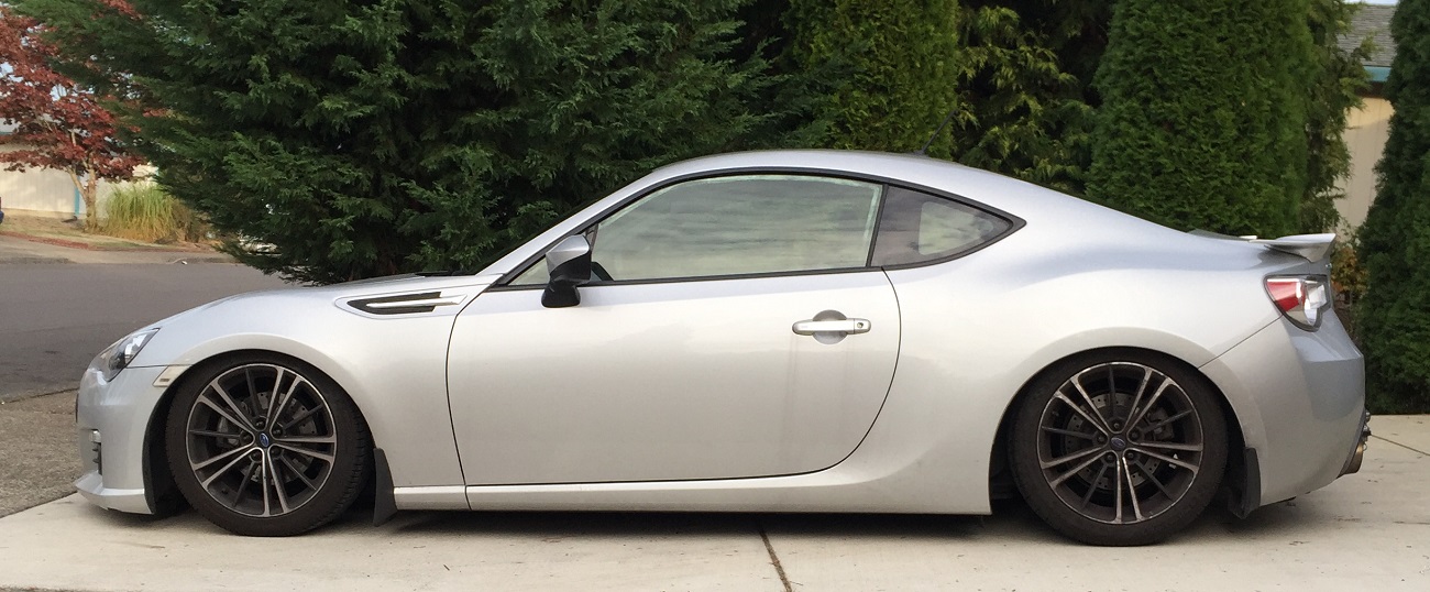

On another note, I finally figured how to get the dropped height even. First I adjusted the fronts as low as I could, just touching the fender liners. Then I adjusted the rears as high as they recommend, threads just showing in the holes. Voila dropped height is even. Any other adjustment is too high in front, or too low in back. That means there is only one adjustment with an even drop. So adjusting is simple, drop the fronts till they just clear the fender liners, and raise the rears so the end of the threads is seen in the holes. For some reason the height on my right rear is unequal to my left rear strut, so my right rear threads are at the end of the holes, and my left rear is at the beginning of the holes.
Here is a pic of the my car dropped.
