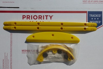

Ok, so yeah who here hates bottoming out your front bumper cover on those unavoidable entrances but doesn't want to raise the ride height on your car?
I myself never really wanted to add a lip spoiler or anything to the front due to the fact that my BRZ has a great body line and looks awesome when lowered.
I came across the ProTekt Bumper Skidplates on MotoIQ.com
http://www.motoiq.com/MagazineArticl...kidplates.aspx
It totally reminded me of the old Powell Peralta jaw bones, rib bones and tail bones.
Since they worked so well back in the day I wanted to check it out for my BRZ. Placed the order online and 3 days later had my BRZ kit ready to go ($170 shipped is cheap insurance to save my BRZ bumper).
I however took a different approach on the install from MotoIQ since I was pulling my bumper cover to do a oil cooler install anyhow.
Here is what I didn't want to see after pulling my bumper cover. I knew they were there but still, yuck.
Anyhow brought it inside and got to work (drill needed and some basic hand tools).
A portion of the holes line up directly with those already existing. With that said you will need to drill a few. Just remember to line it up how you want it to fit and snug it down prior to drilling the other holes in your bumper.
Install on the bumper is a breeze. It also helped stiffen it up a bit.
Now time to let pics speak for themselves.
Such a close fit
Here are also some daylight pics too
So far it has saved me from a couple more gouges in the bumper already in the 1 week I have had it on. I am really looking forward to seeing how well it helps the bumper survive cone hits also when autocrossing too.

The skid plates are made from 3/8 thick HDPE plastic, and are specifically designed to scrape the ground over and over, and keep looking good!
Also, all the mounting hardware is fully countersunk, and are nuts, washers and bolts. (No drywall screws or self tapping stuff)
I've been selling these for a little more than a year, and I have never seen one worn out, even when they are abused.
