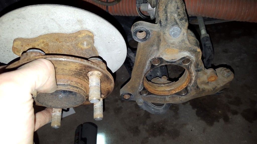

For those of you lucky folks that don't have to endure an Iowa winter...here's what it does. Keep in mind I had this apart when I installed the ducting for Sebring in January. I had these parts so clean you could eat off them. So this is 4 months on the car, and maybe 1-1.5 months of a winter.
