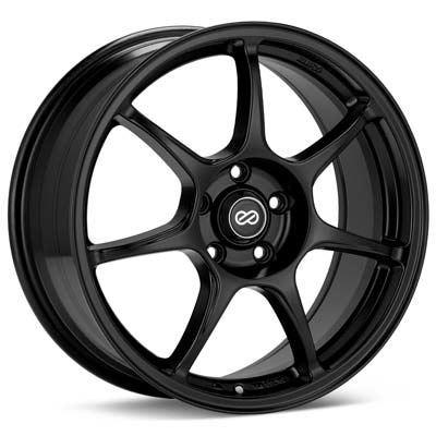

I have gone through loads and loads of posts and really haven't quite found my answer so I figured I would post here... Starters I never really have cared about wheel fitment. But since i'm trading in my 2011 STi for this FRS I want to go for a certain look. For now I'm prob going to run the stock tires on a 17x7.5 then later go to a 225x45. I've been shopping around for some decent wheels that will somewhat flush out to the fenders. I'm quite the fan of enkeis and wondering if these 17x7.5 40 offset would be a good candidate? thoughts? advice? input? I'm really not looking into spending more then 1k for a set of wheels atm untill I save up to buy coils.... already going to be dumping $$$$$ on a full exhaust from Nameless Performance. Headers back... coils come next... Wheels are kinda just a get by if you catch my drift. Oh yea the FRS is going to be asphalt grey. So i'm deff going black.
http://www.tirerack.com/wheels/Wheel..._19&sort=Price

7.5" and ET 40 will push the wheels out approx. 14 mm (slightly more that 1/2") compared to stock. I guess you will be pretty flush in front and have a little gap on the rear wheels. I planning to buy 17x7.5" as well. I wish RPF1 could come with ET40. Now they are only ET48 mm.
Anyone, correct me if my calculation is wrong.

That's correct, but remember the tire is often the widest part of the package. If he's using the stock tires, they will only be 8mm closer to the fenders.
