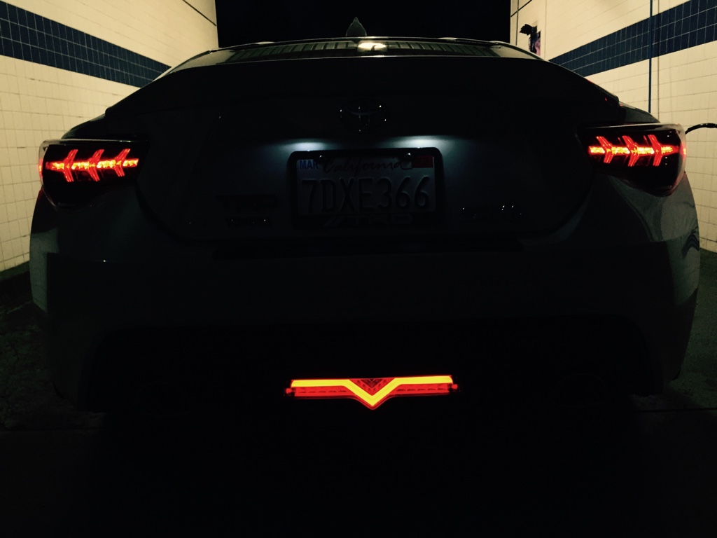

Bought this from the iJDMToy store in Los Angeles.

Got the V light to be running light and brake light to function now. Name:  ImageUploadedByTapatalk1435638520.600905.jpg
