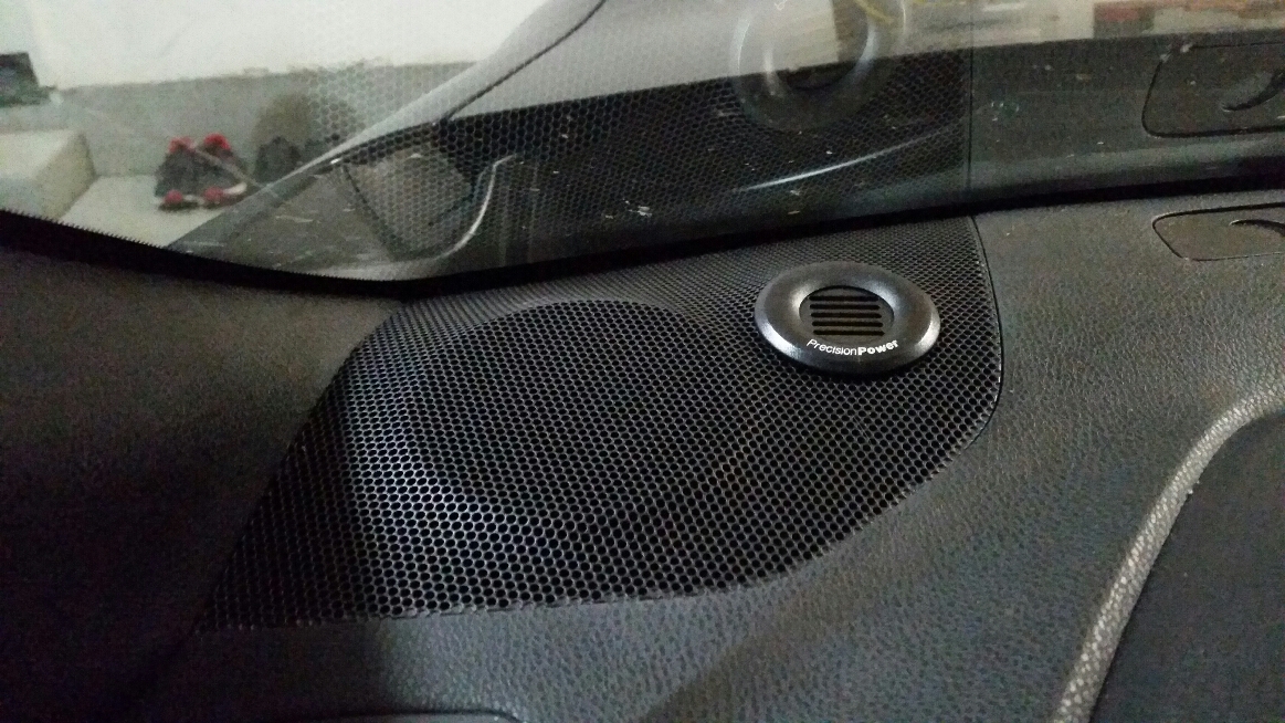

Happen to have any install pics? I've been eyeing those PPI components but the tweeter looked like may have a hard time fitting in the stock location.
The tweeter was the only thing that I mounted in a spot that was same location as stock, but flush mounted.

why not relocate tweeters if you're going custom? Those dash speakers are in a bad sonic location.. right up against that pane.
