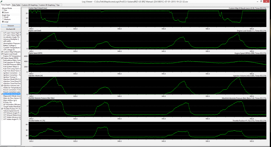

I'm under the impression it's a software bug that they didn't notice. Judging by the datalogs it looks like anything below 0C rolls over to the top of the scale instead of into the negative scale. Case of programming error. I'll check tonight if there are any RR updates.

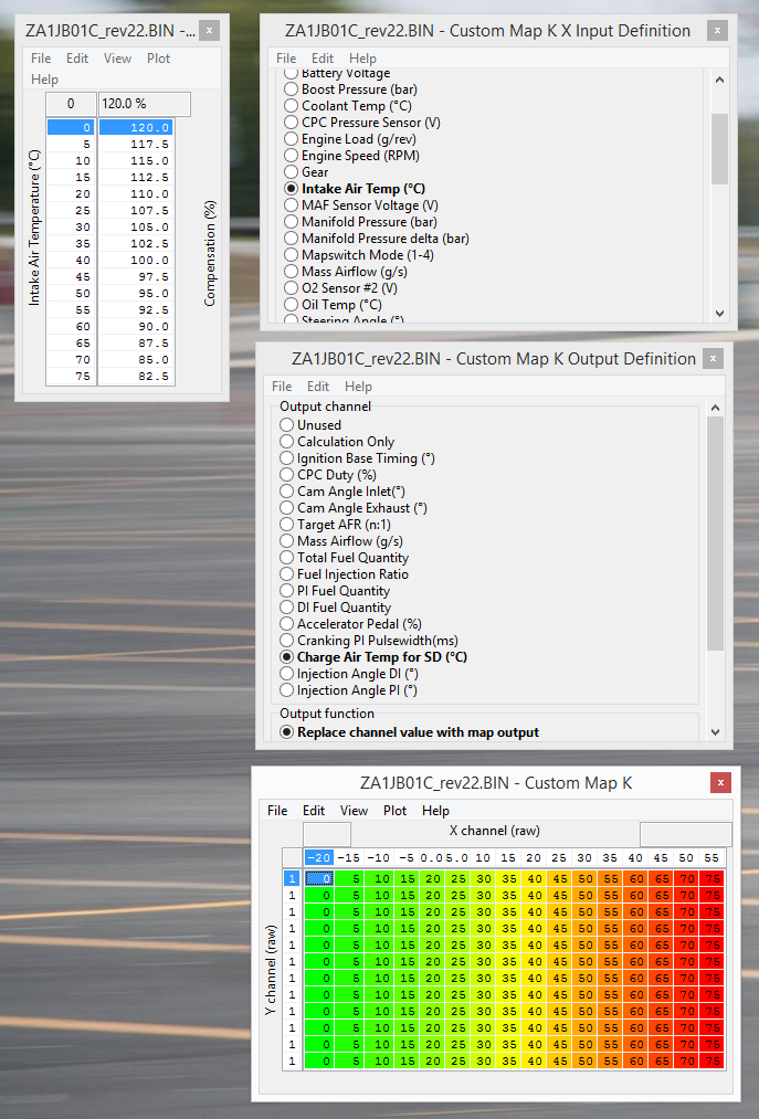

I may have come up with a workaround which should work during the interim until we get the official fix, as I don't think the retail customers have received it yet (at least I haven't).
Originally I had planned to mess with the IAT sensor scaling but that'd produce issues with anything else that relied on the IAT/CAT values. I noticed that RaceROM custom maps were able to replace the SD CAT value, so I decided to just add 20 degrees to the SD Temp Compensation table IAT values. Then I created a custom map telling the ECU to lookup the +20 value based on actual CAT. This gets around SD using a negative number for calculation since they're all positive technically. By using a custom map this only modifies what speed density calculates airflow with and leaves anything else that relies on IAT alone.
It's worked for me down to 26F (-3C) so I'm seeing it as a potential fix. My AFRs were where they should be. I'm not sure about what function the SD Calibration Temperature does, I run a JDL kit and it's blow through MAF so IAT is CAT. If anyone else wants to try it out I've pasted the tables in a screenshot.
Granted these numbers will work down until IAT actually drops below -20C or -4F. Scale accordingly if you live somewhere exceptionally cold.

I know why he wanted the MAF Sensor parameter haha, because he probably saw the same dip as I did. I logged MAF parameter and you could see that held constant while the calculated MAF from SD dropped like a rock. I'm pretty certain now it's caused by a software bug transitioning into negative numbers. Incorrectly coded it would roll over to the top as opposed to scaling further down, I would assume. Just took digital logic design this semester . So far this little fix works at 20F (-7C) + 20 so I'm thinking it works as long as SD uses a positive number for CAT. It's a workaround until we get an official fix, but it works so I'm okay with it for now.
The latest V7 RRFF available to retail is svn14599 (other than some specific versions that have a later number). Nothing in the 15xxx.

What you did works fine with that custom map I think, the only downside is incorrect fueling calculations for the temperature, but it will be a small difference and certainly words better than a full on fuel cut.
