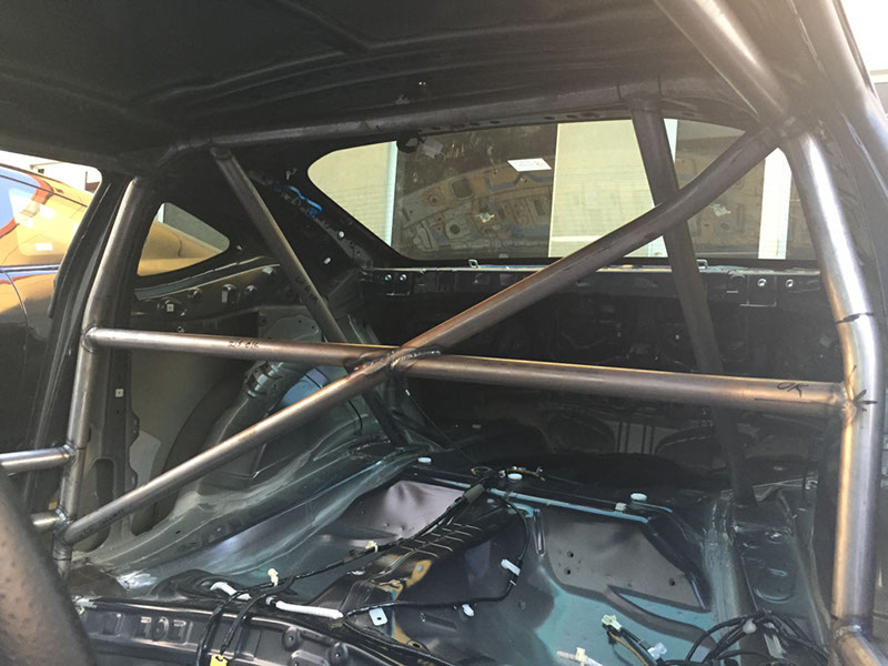

It's basically a stock rebuilt title car with a cage that isn't perfect (even a poorly done nodal point in one pic). 10-15k at most.

Even a poorly done nodal point in one pic
Can you elaborate on the cage nodal point ? I am curious to ear your feedback opinion on the cage build as I may end up keeping the car and building it more.
http://www.ft86club.com/forums/attac...1&d=1415065622
The cross bar should meet at the same point as the middle nascar door bar (stronger, the current way isn't "wrong" it's just not as good as it could be). Also looks like the cross bar is bent near the top over the drive, but that might be the picture. I wish they boxed in the back to use the additional sheet metal there, but that's not required.
I've never seen a diagonal cross bar bend like that? It's as if they realized the bar wasn't going to line up with the side hoop where it connects to the main hoop, and simply did a bend to make it align. Should pass tech for most sanctioning bodies (maintains the same plane as a the main hoop), unless in their GCR it says anything about bends in the diagonal brace.
