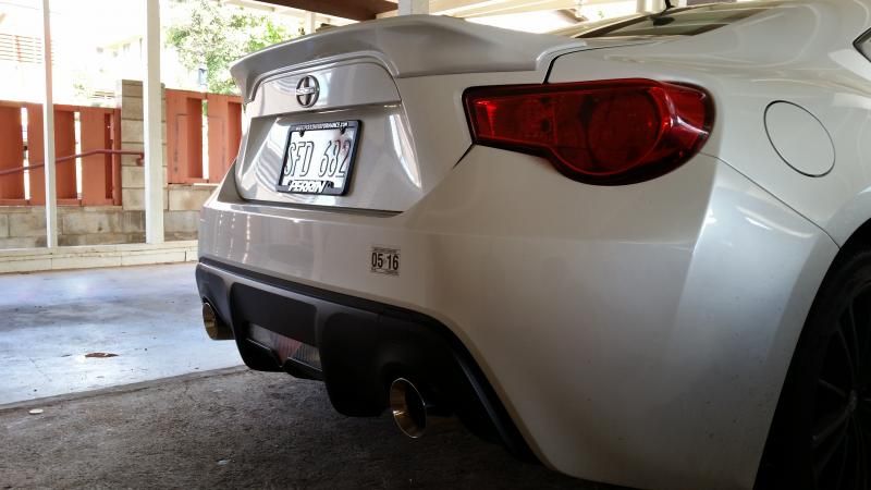

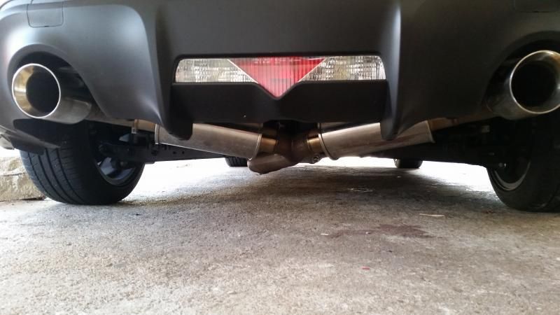

Here are some pictures of it installed :]
It sounds great! No drone at cruising speeds that a lot of people were complaining about. I am stock header with a K&N intake filter and a Perrin Intake hose. Fitment looks on point with the bumper. It pulls noticeably harder through the power-band. I was genuinely surprised at the power increase. A lot of exhaust mods on other cars I have done, have not yielded this noticeable of a difference. The system as a whole is a lot lighter than the stock exhaust parts. The piping looks solid and so do the welds. The slip on design is easy to work with. I would give it a 8/10.
