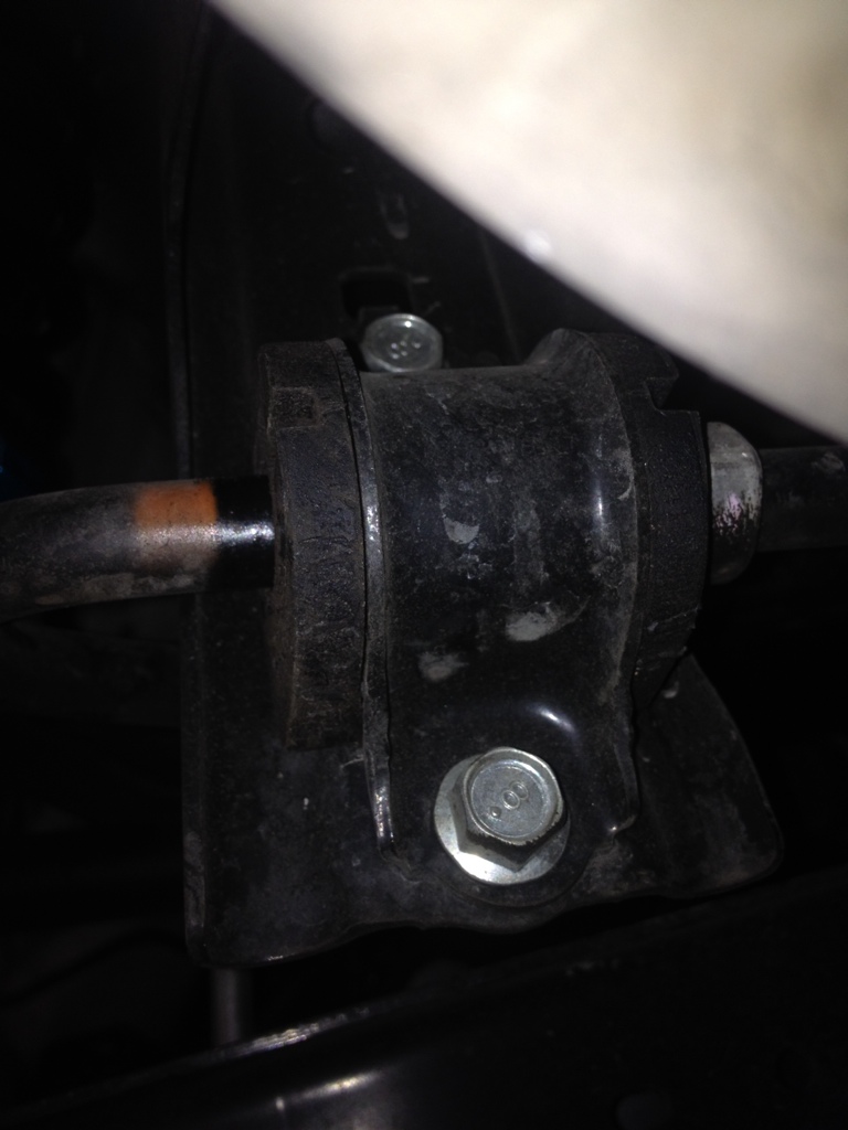

I'm trying to locate a poping sound in the rear of the car. While doing a visual inspection I noticed this on the swaybarName:  ImageUploadedByTapatalk1410975777.424349.jpg

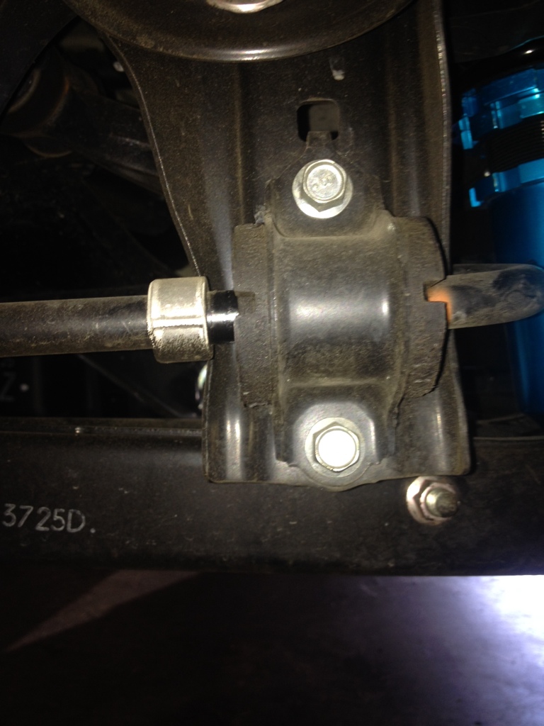

Just trying to put heads together to see if this is my culprit.

I have silver collars on both sides, looks like you lost one, and the bar shifted.

I have both silver collars still. But not sure how the bar is moving?? It's like I slammed the rear end into something and shifted that piece.

I'd even it up again, and make sure the collars are tight.

They float around a bit, that's why the collars are there.
In other words, it's normal.

Damn.. Kinda hoping it wasn't.. Now I gotta look at my coils again. Lol
