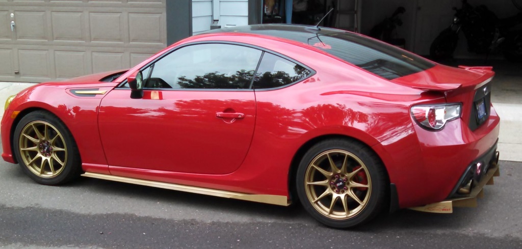

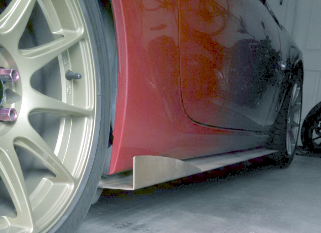

Hi. Since I know Carl @Wonderbar, owner of Driveway Labs (drivewaylabs.com), I got the early batch of the soon to be super popular, functional with form, side skirts. Unlike most people I elected to not have it powder coated black as it wouldn't go with my color scheme. I painted it with Grimmspeed gold paint as I've done with all the other silver pieces in my car. I installed the side skirts in my garage with jack stands. The rear rubber mini mud flap needed to be adjusted a little (cut a slit in it) and I'm not able to use my OEM front mud flaps anymore. Install was fairly easy. Just need a drill with a 8mm socket, flat head screw driver and maybe a philips if you need to remove the front OEM mud flaps. I only had 1.25 cans of Grimmspeed gold paint left and I think I could have used 2 full cans as the paint doesn't look perfect. The side skirt itself is a solid piece and of a quality cut. If I designed it I probably would have rounded the front a little for a more progressive front edge, but that's just a minor thing so no big deal. Goes great with the rear diffuser I have which he also made (V1). All in all I would highly recommend this product over all the stick on plastic or fake carbon side skirts I've seen in person. Maybe he will have a type 2 version the is a little less aggressive, sticks out less, and is slightly more rounded in the front. That said I'd still keep my version 1 as I like a more aggressive look.

Name:  Gold Side skirts.jpg
Name:  Gold Side skirts1.jpg

How are they mounted? I'm sure the skirt itself can take the occasional step, but if these are just screwed into the underbody like the other kits, I gotta imagine that'd rip right out with the weight of a good sized American. Are these bolted on?

There's 11 sheet metal screws for each side. It seems really sturdy. I'm not going to stand on them like Carl mentioned as I'm too scared to, but if he stood on them and they are good then I'd believe they'd be at least able to handle the occasional "oops I put my foot on it when getting out of the car" or the "oops the squirrel just got decapitated by the side skirt blade".

These go in near the pinch welds where there are several layers of metal. I looked at a way to bolt them, but it would involve removing fenders and stuff, no need.
I'll post a video tomorrow on my Facebook of it supporting my body weight.
