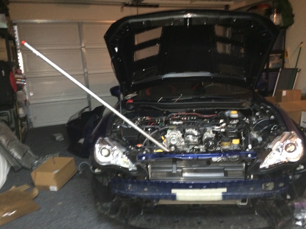

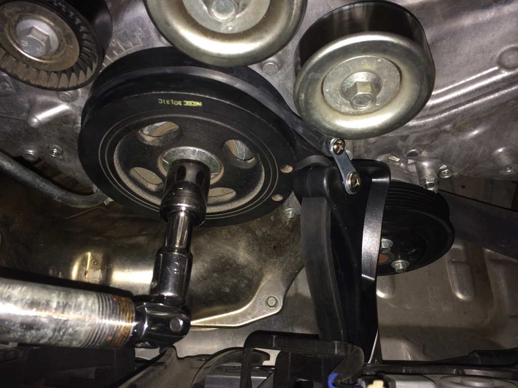

Size:  275.6 KBName:  ImageUploadedByTapatalk1407179939.168706.jpg
Size:  278.3 KBName:  ImageUploadedByTapatalk1407179947.520449.jpg
Hard to see what's going on but I pulled the strap tight then slowly turned until it wedged itself. The strap is in on the groves until the handle part where it came out to the outer smooth edge.
