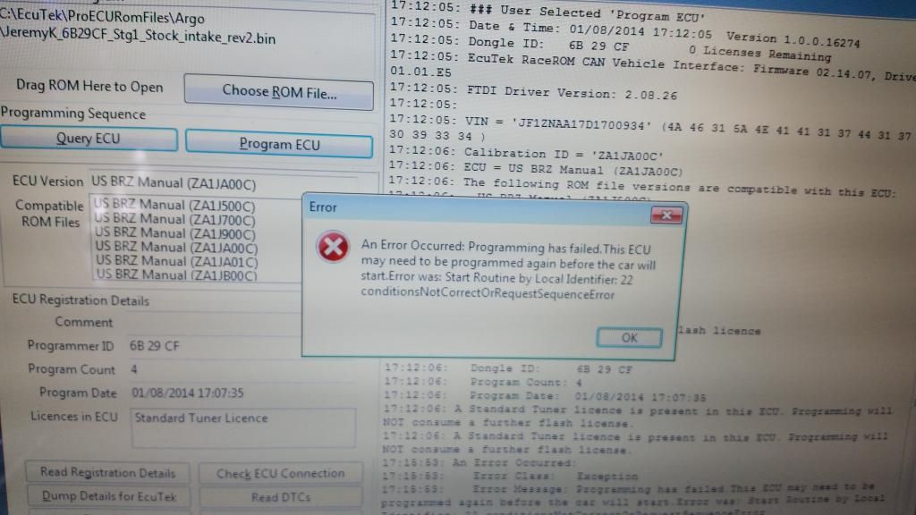

I'm fairly new to ECUtek, but I've got a problem and was wondering if anyone knew of a fix/solution.
I was using a previous edition of ProECU and loaded my inital rom from my tuner fine, had no trouble. I datalogged and sent it to my tuner to be revised. I received the new revised rom, and updated everything with the ECUtek app downloader, which updated to a newer version of ProECU. When I went to flash my car, I got this error. It errored out when you would normally cycle the key off.
I tried the same rom again and got the same error. I checked my cables and tried the initial tune, and received the same error. Hoping, I tried to start the car, and it started. So I tried to flash the revised rom again, got the error, but the car starts.
Is there any way to verify which rom file is loaded into the ECU?
What is causing this error and can I correct it somehow?
Will this prevent me from loading any revisions in the future?

After resetting the ECU by disconnecting the battery I still get the same issue. Posted on a Facebook group, and Adam Kennedy (Revolution Performance) said he ran into the issue on a customer's car. He contacted ECUtek about it being a possible software issue with PROecu 1.0.0.16274.

I have the same error, I emailed Bill (Delicious Tuning) about it and he said it's a bug in new ecutek build, we will have to wait for them to fix it. Try informing your master tuner about that, maybe guys at Ecutek will fix it faster if they have more complaints.

I'll be sure to pass it on to my master tuner (Graham at FT-86SpeedFactory). I emailed him Friday but it was already after close of business. I figure that ECUtek will be quite aware of the problem bc I'm sure a lot of people encountered the issue over the weekend. Definitely sucks.
Is it possible to revert to a previous version of ProECU, or to uninstall/reinstall it with a previous version and flash that way? Would it mess up the licensing?

Spoke with EcuTeK about this, this morning. They are releasing an update that will be available tomorrow to everyone for download that resolves this issue.
