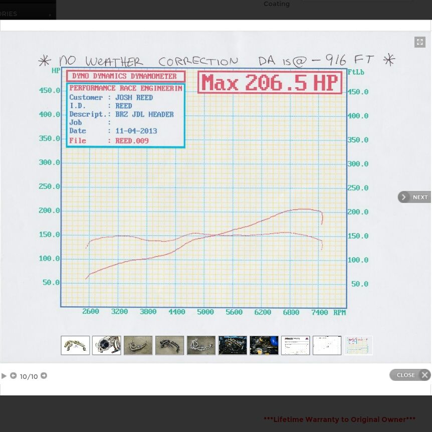

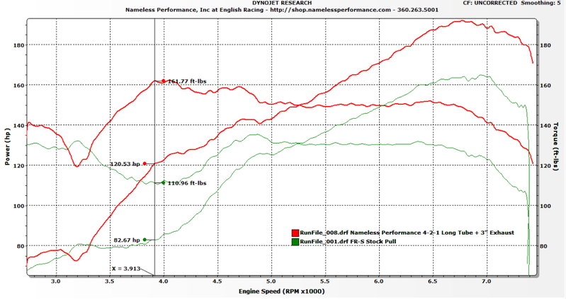

I'm kinda at a stand still at this point. I can't decide between the nameless ELH and the JDL UEL. My long term goal is to go with the innovative supercharger kit and lightin up the rotational mass. Overall just have a fun daily driver with plenty of low end torque.
Whatever header I choose will be paired with a 3" perrin resonated catback and a 3"nameless cat/resonated mid/overpipe and tune.
The numbers look good on both. The JDL looks to have a more even torque curve and has a good price point. On the other side the nameless has phanominal workmenship and appers to have more reasearch and development behind it. The thing that worries me about the Nameless is the dip in the low 3000 RPM range that go's below the stock numbers. Is the dip even a valid concern and is it even noticeable?
JDL 2.5 exhaust 93 tune
Nameless 3" exhaust 93 tune

You used my dyno results without my permission! I don't care so no worries. That day I did my dyno was extremely dense air day so those numbers are very unlikely to be repeatable unless you're in a cold rain forest. For the right price perhaps I'll sell my Innovate, headers, intake, charge pipe, etc...
Sorry man, took it off the JDL website. Figured it was public knowledge since they were advertising it. So I guess it safe to say you wernt happy with the set up?

It's not a myth. I tried using the 3" exhaust with a JDL UEL. On top of being a raspy fartcan of a sound, the low end power suffered. You could definitely feel the stutter at very low RPM till it finally gets the flow going. Went away quick when I swapped over to an Invidia N1 setup and catted FP.
Stick to 2.5" for N/A. 3" for turbo. Hell, even 2.5" for S/C is fine unless your plan is 450 whp or above.

Yes. Nameless dyno plot is about how my car felt after tuned. The low end was sluggish, but the top end was pretty intense. Pipe diameter is too large at very low RPM. I didn't have a chance to get it on the dyno unfortunately.

3" is fine with a supercharger. It's what I run on my car. N/A it might hurt but once you go FI, you'll be fine. Here are 2 dyno's with almost identical setups using the Nameless header. Only real difference is that the top graph uses a 3" Nameless exhaust with stock intake and filter and the bottom one uses a 2.5" Nameless exhaust and has the Perrin 3" intake. Both are using the Innovate supercharger with 70mm pulley and on E85. The 3" made slightly higher numbers but it's almost negligable. I think if I had the Perrin intake I could squeeze out a couple extra hp. I went with a 3" because later on down the road I plan on going with the 335 Sprintex unit once I can get my hands on it.
But in regards to the OP's original question, you can't go wrong with either. Both are high quality headers that will yield great results.
