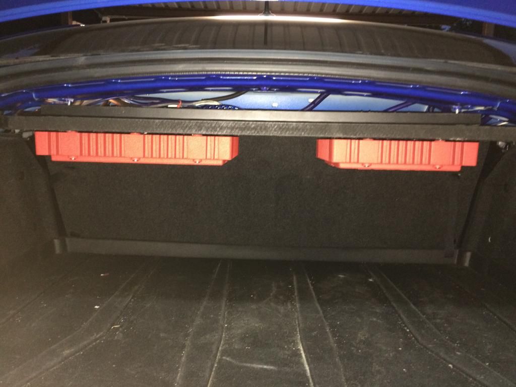

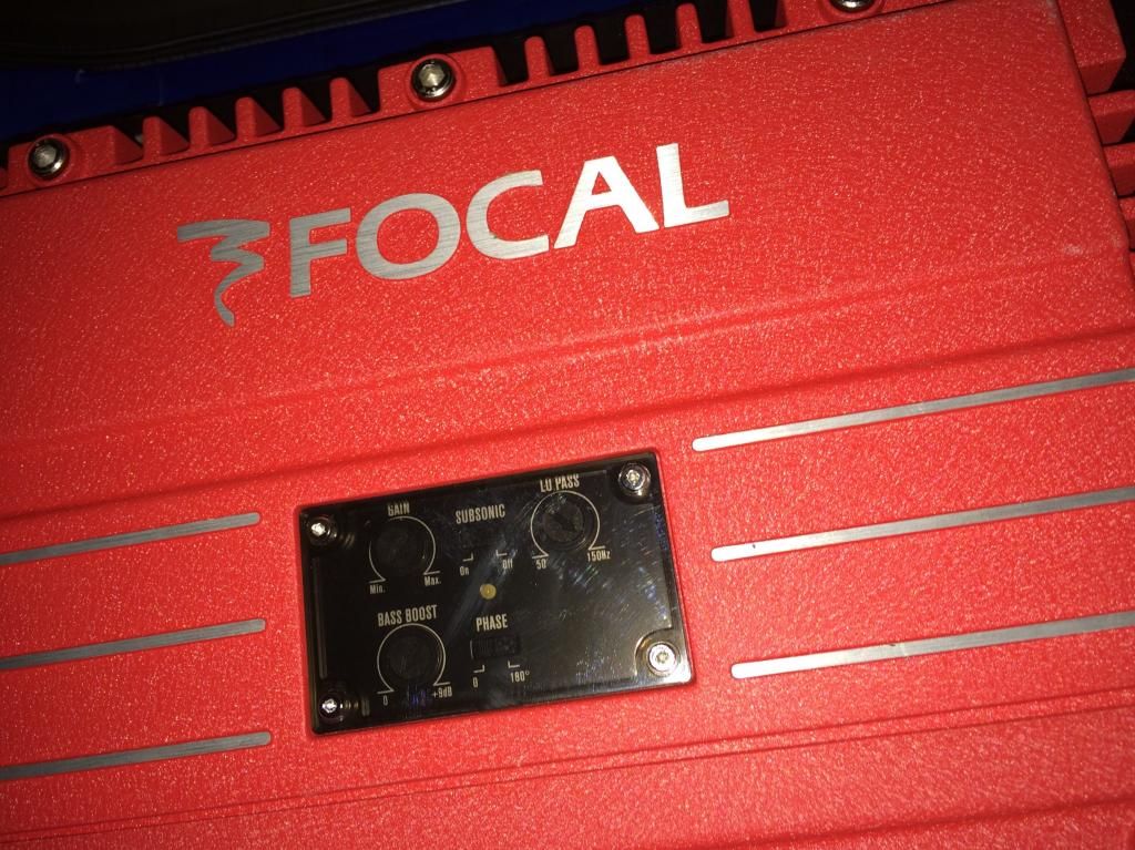

So my helix amp blew up after a week so I got some focal amps. Just finished amp and rack install. Sounds incredible; can't wait til sub box is shipped

Amp mounting looks nice. Can you share any info about how you secure the mount to the rear deck?

I drilled 1/4 holes and used 1" 1/2 screws into those plastic flex things that i inserted into the holes. Then a dab of silicone on each one to make sure they don't back out after the sub starts vibrating everything. The amp rack is just 3/4 mdf painted with Plastic Dip, which is basically rubber coating in a can. I put two 1" rails on the bottom side of that to secure it all to the deck.

Where did you get the plastic things to screw into? And what did you use for rails. I really want to mount on the rear deck

I used standard brackets similar to this except black. Cut them to the length i needed.

and anchors like this except with 1 1/2" screws.
