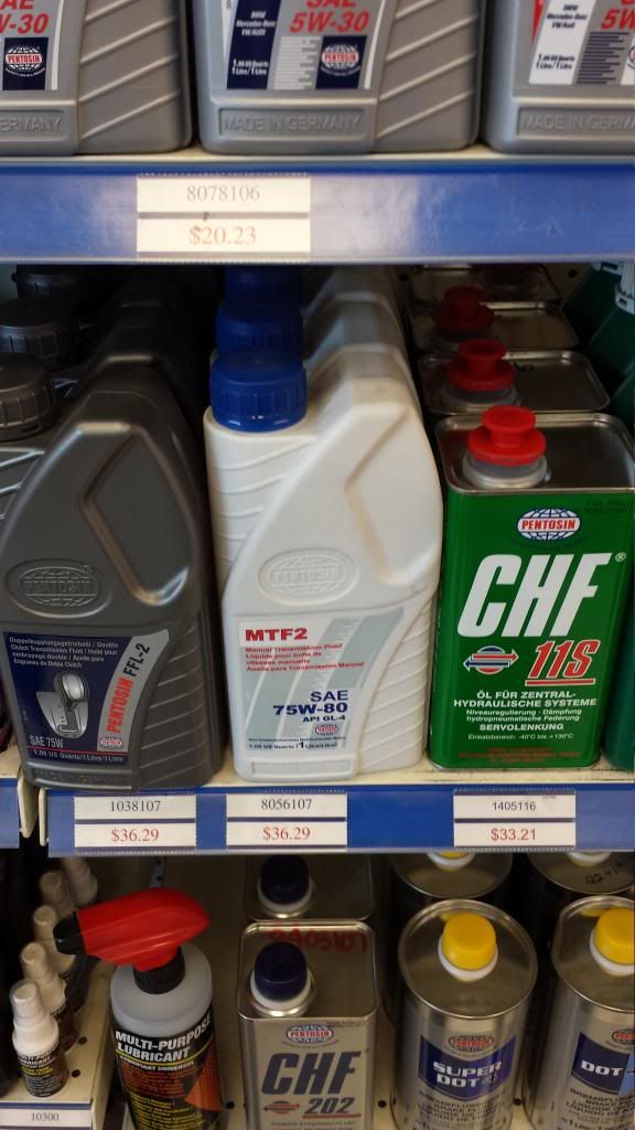

Was just in Lordco auto parts in Maple Ridge here just outside Vancouver and noticed they had this stuff. It's the right stuff yes?

That's the stuff. My bottles were/are grey rather than white, but the label says the right things.

Yup that's the tranny goodness gold.
