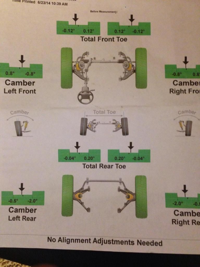

My 2013 BRZ keep going left and right constantly and I have to keep correcting steering wheel to drive stright on highway. There is no wind and interstate is smooth, no grooves. Anyone having similar issues?
I took it to two different dealer but one dealer didn't bother to take it to highway and 2nd one says it's normal because of low profile tires...... yeah right!
Alignment is straight. I am worried about steering wheel linkage or springs. Any help or thought would be greatly appreciated! Thank you.

Thats an oversimplification regarding alignment.
This might mean that you have no toe in.
Toe settings can make the car "wander"

What are your alignment numbers?
mission2toilet is offline   Reply With Quote

Are those figures on the sheet for a FR-S/BRZ? I remember a thread where someone took a twin in and they used WRX specs because they didn't have the specs for the twins in their system, which is completely wrong. Looks like you are toed out in both the front and rear. What are factory alignment specs per the shop manual?

Originally Posted by White64Goat View Post
. Looks like you are toed out in both the front and rear?

Originally Posted by Ernie L View Post
Looks like it says Toyota MR2 03-06 at top left of the screen.....????? Any explanation why it says that?
