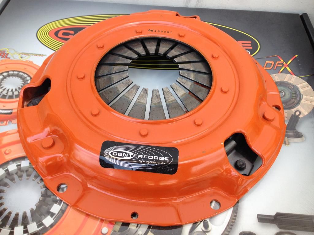

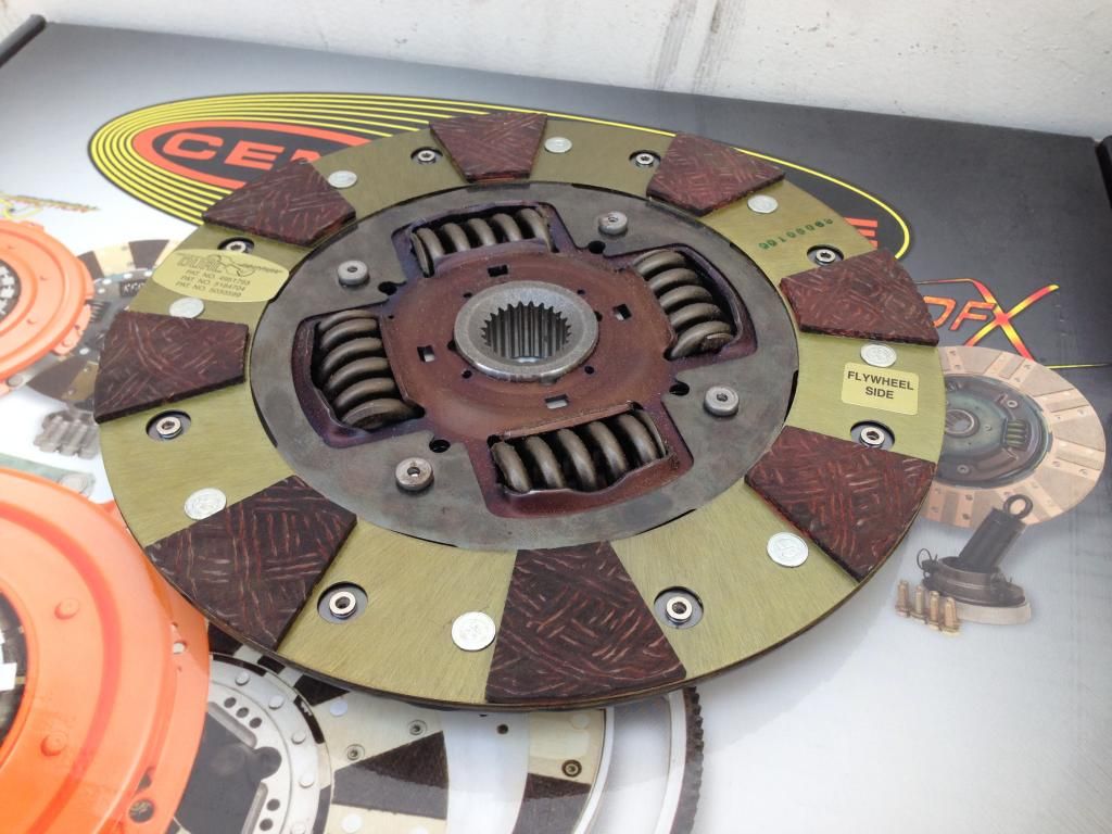

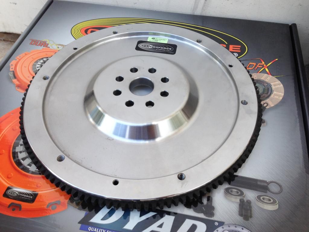

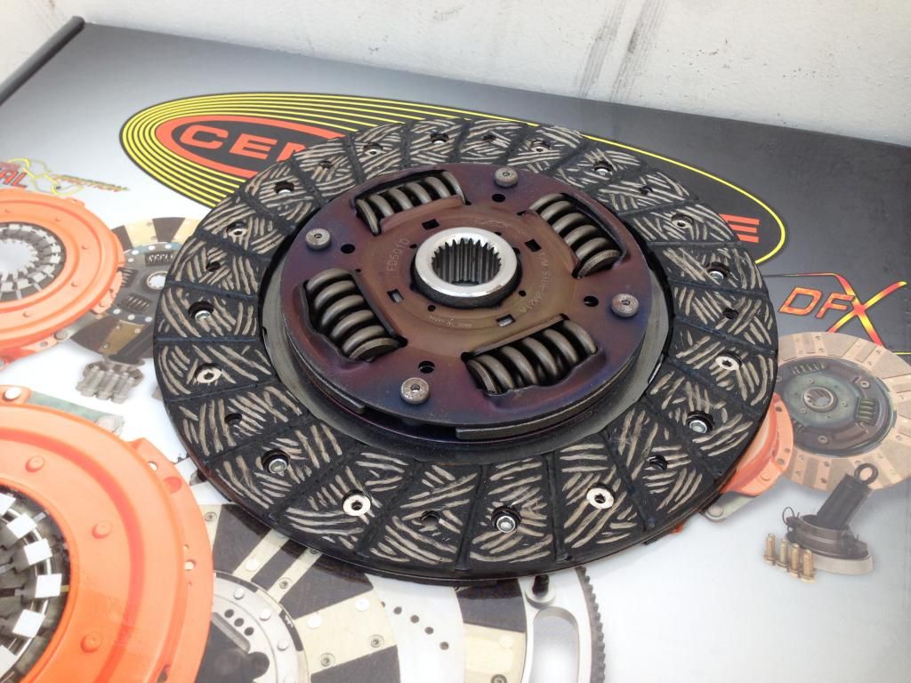

Centerforce Dual Friction Clutch and Steel Flywheel
Centerforce P/N DF834749
Link to their blog about the clutch and flywheel: https://www.centerforce.com/blog/blo...r-s-subaru-brz
So I received this about a week ago, drove over to my buddy's shop and we got it installed without a hitch. Just know that if you have access to a lift and tranny jack, life it so much easier. I used the method outlined in the DIY using the jackstands. Lets just say that removing the interior pieces and shifter were very unnecessary if you have access to a lift.
Once in, we bedded the clutch in and then I took it for a spin. Pedal effort was minimally increased, less than 10% I would guess. Clamping didn't seem much different, no chatter upon slipping and rev'd maybe a little free-er (Is that a word?).

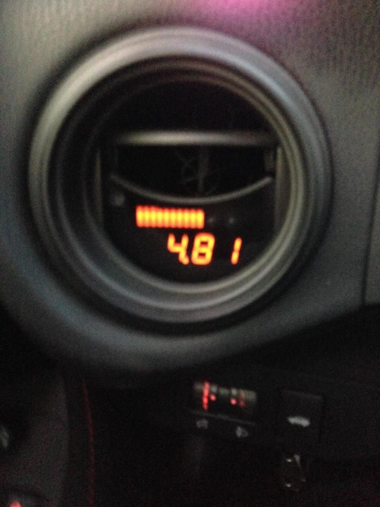

I put about 400 miles on it slowly ramping up my load and power. When I felt it was time, there was a patch of road on my way to a gathering near another friend's house in the country (no all of OK is considered country), so once I got over some railroad tracks I gave her hell. My P3Cars gauge said I pulled a 4.8 0-60. I was very pleased. The launching and slipping of the clutch worked great.

Rev matching for corners and such is also smoother. If I tracked this car a lot, I might have wanted a slightly lighter flywheel. Since it's a daily and a hoodrat shit car, I figured the steel flywheel will take the abuse and make the shifts smoother.

Oh, got the blurry 0-60 readout from my gauge. Kinda shocked me.
