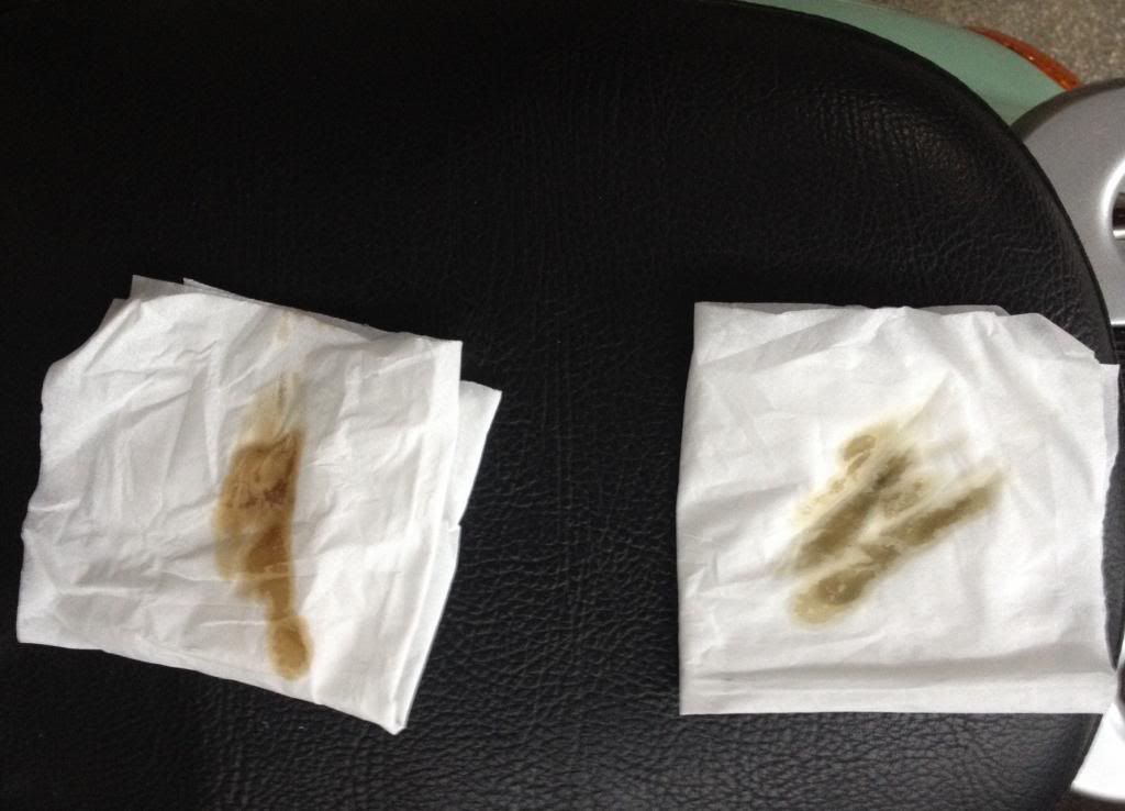

My oil smells like fuel
I was checking my oil level today and I noticed that the oil smelled like fuel. It was also light brownish-green in color. I don't think it's coolant because I'm not losing any. The fuel I am using is blue so that could explain the brownish-green color of the oil. It smells like the blowby oil/fuel I am catching i my Radium catch can.
When I checked the oil in my other car, which is also running the same brand oil and viscosity (5w30 synthetic) and has run roughly the same mileage (1,000 miles) it was medium to dark brown in color and smelled like regular used oil.
My mods are Vortech SC, DW 700cc injectors, DW65c fuel pump. According to my AEM wideband gauge, AFR drops to 10.7 then ends at 11.3 at redline when I go WOT. I also read that direct injection engines are notorious for fuel dillution in oil. What are your thoughts?

Here's a photo of the oil from the dipstick. On the left is the sample from my other car (BMW M54 engine) and on the right is the one from my 86. Both oils are the same brand and viscosity and roughly the same mileage on them
