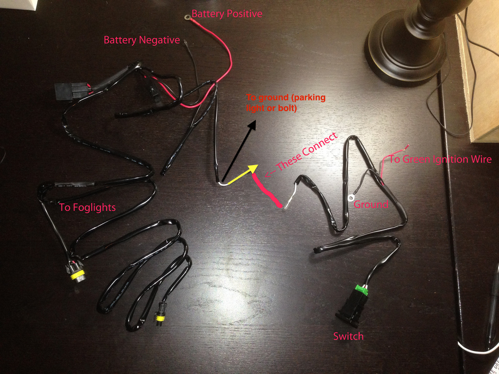

Ok so since some of you have PMd me asking to detail it once I figure it out - here it is:
In the end you wire it up exactly how all the DIYs say but with DD kit (since there are 2 signal wires - black & red) you have to hook the black signal wire to a ground (I did the parking light ground wire since it was already hooked up) and then the red signal wire goes into the signal wire on the switch
See this for clarification:

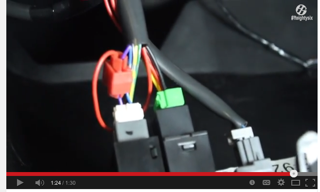

And this is where I tapped in for the switch power (it's the power wire for your cabin dimmer):
Name:  Screen Shot 2014-05-31 at 12.54.14 PM.png
