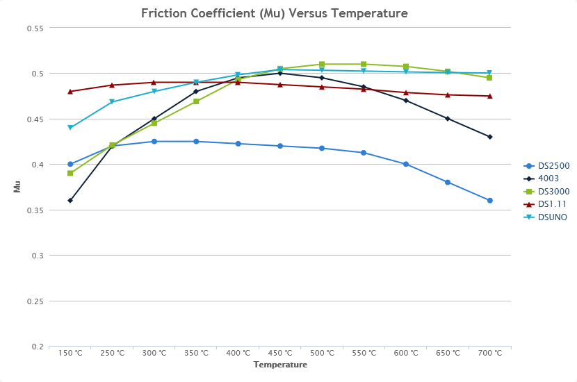

I wonder if the Ferodo DS1.11 isn't the pad you're looking for, assuming it's tolerable under DD conditions; pads from the same manufacturer frequently have similar bite & release characteristics:
That's an enduro pad... I wouldn't recommend it for street use at all. Within Ferodo, DS3000 or DSUNO would be a better match.
Is there a way to understand that just by looking at the chart (e.g., the high Mu at low temps)? The data make the 3000 & UNO look like they would be very similar on the track - is this the case?
Unfortunately not; you'd have to dig a big deeper into the compound and metalurgy.
