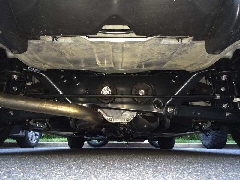

I used mine to divert air from getting under the rear bumper.

When I removed the stock muffler, I didnt want the air to catch the bumper, so I simply pulled the rear of the heatshield level with the bottom of the bumper.
I got some pieces of metal strips thats used in car audio mounting and bolted it in place.
Its very simple.
Then I saw the way the heatshield was curved! i decided to flip it around left to right.
I liked that way better.
David

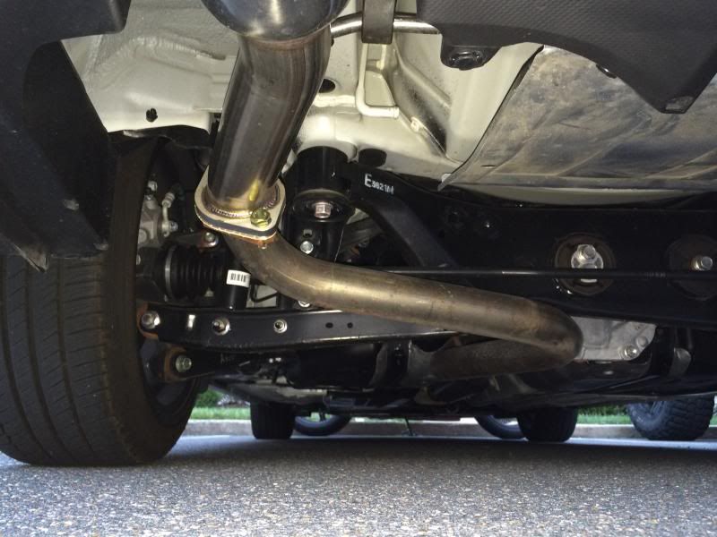

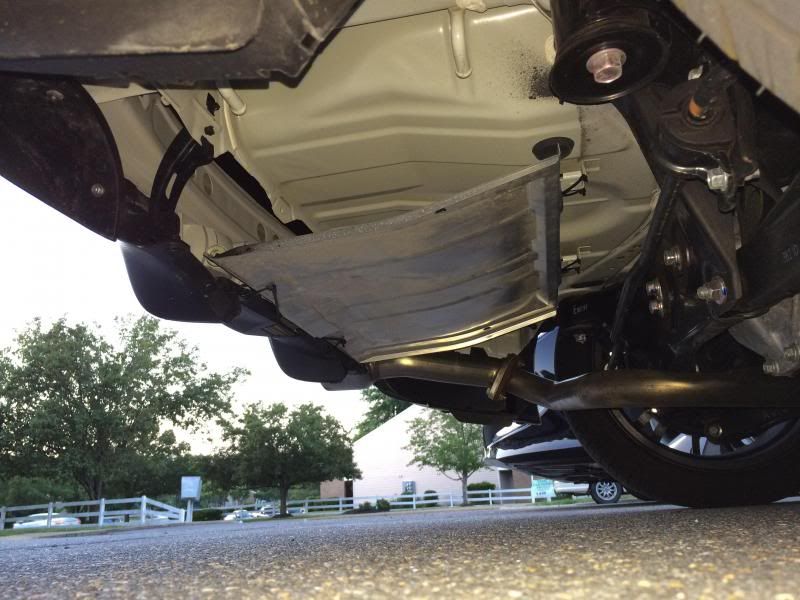

Finally did this tonight. I set mine up very slightly differently I think but I didn't want to remove any of the parts holding the bumper plastics together. Now that I see how this works I might get some sheetmetal and try to come up with something a little more form fitting.
