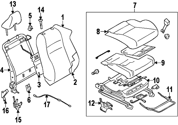

I don't know how it works in the twins, but when I had racing seats in my M3 all I needed was the passenger occupancy sensor. A spare cost me around $110.
Unplugged the car battery, removed the passenger seat, installed passenger recaro, placed passenger occupancy sensor under the cushions of, guided the cable for the sensor through the bottom hole for the 4 or 5 point racing harness, connected it to the car, reconnected the battery. Didn't have a fault light or code and fully functioning passenger air bags.

It looks like you'll need the piece on the right that is sandwiched between 8 and 9. I haven't been able to find a part number, but maybe your local dealer can help you find it.
