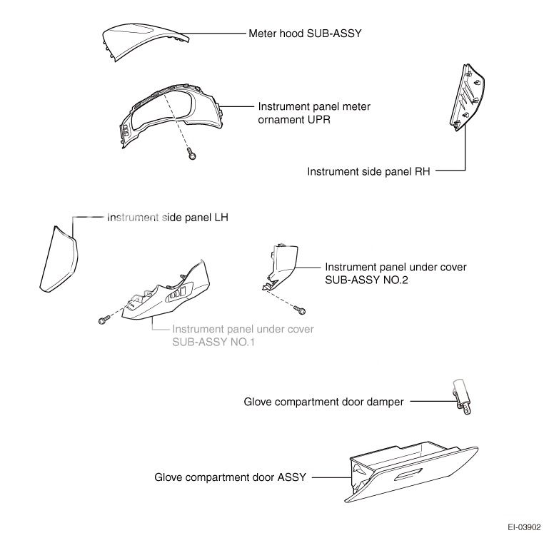

Originally Posted by fitcious View Post
How do you pop open this assembly?
The shop manual shows it coming off as a single large piece.
Shouldn't be too hard to get to. The lower dash below it comes off with 2 or 3 bolts and the side panel just pops off in your hand. Looks like it's just one screw in the side of the panel once those are out of the way.

DO NOT DO THIS.
Pop the plastic trim off between the dash and the door. Take out a couple of screws or just one iirc and that whole piece comes off.
