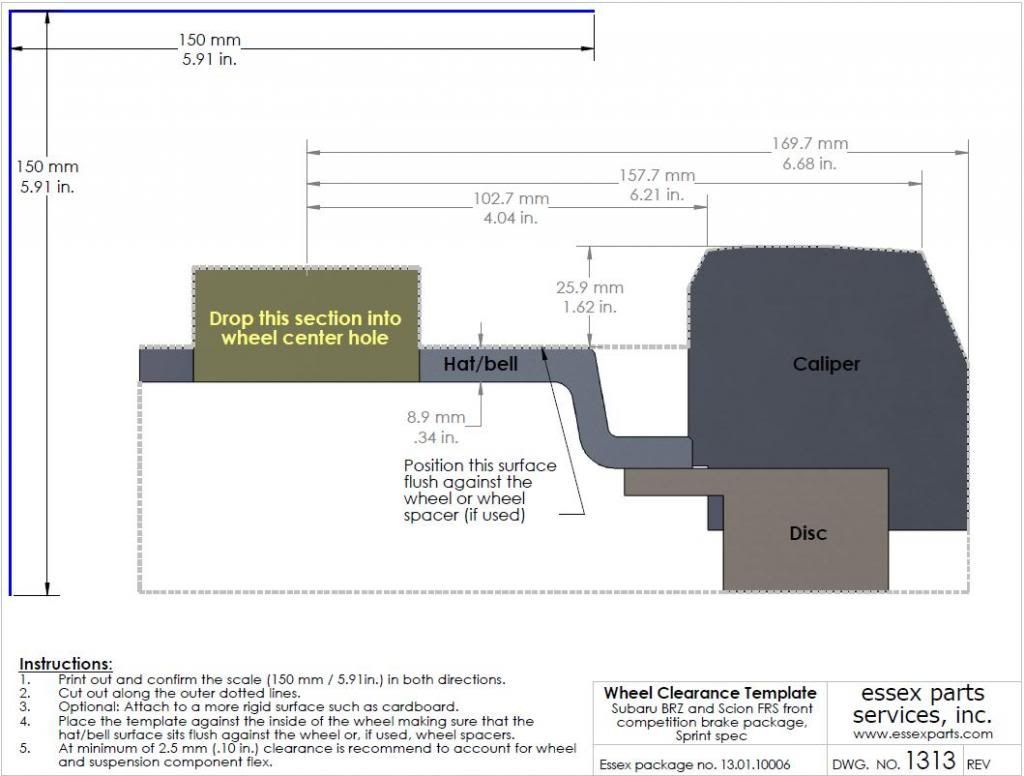

Quick rule of thumb:
Rotor Diameter + 4" = Required Wheel Diameter
I think you're going to need 18" wheels to fit those kits.
To know whether or not a kit will fit a given wheel, someone needs to get the wheel fitment template for the kit, and then fit it to the wheel. Then you will know for sure.
Thanks! I am trying to get the template for the kit but the Wheels are special order so it would suck to get the 17" wheels and then not have it fit.

There's a link for the front kit's template in the first post of this thread:
http://www.ft86club.com/forums/showthread.php?t=3440
This template for Essex Parts' Sprint Kit has instructions:
dradernh is offline   Reply With Quote
