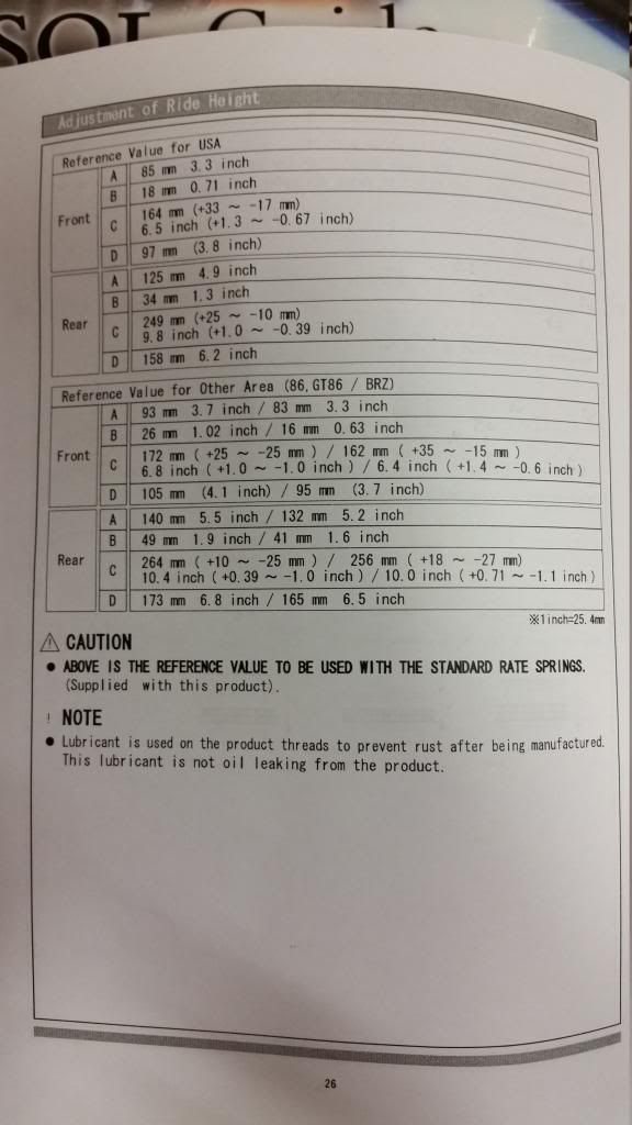

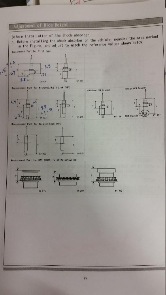

What! Yours was in English? Do you still have it? If you do and can scan it to me that be amazing haha.
Sure! The only strange thing is my ride height doesn't match theirs even though the initial setup was pretty much on spot. Who knows, maybe they are measuring a bit different for ride height. I don't think I could go any lower without suffering performance issues.
