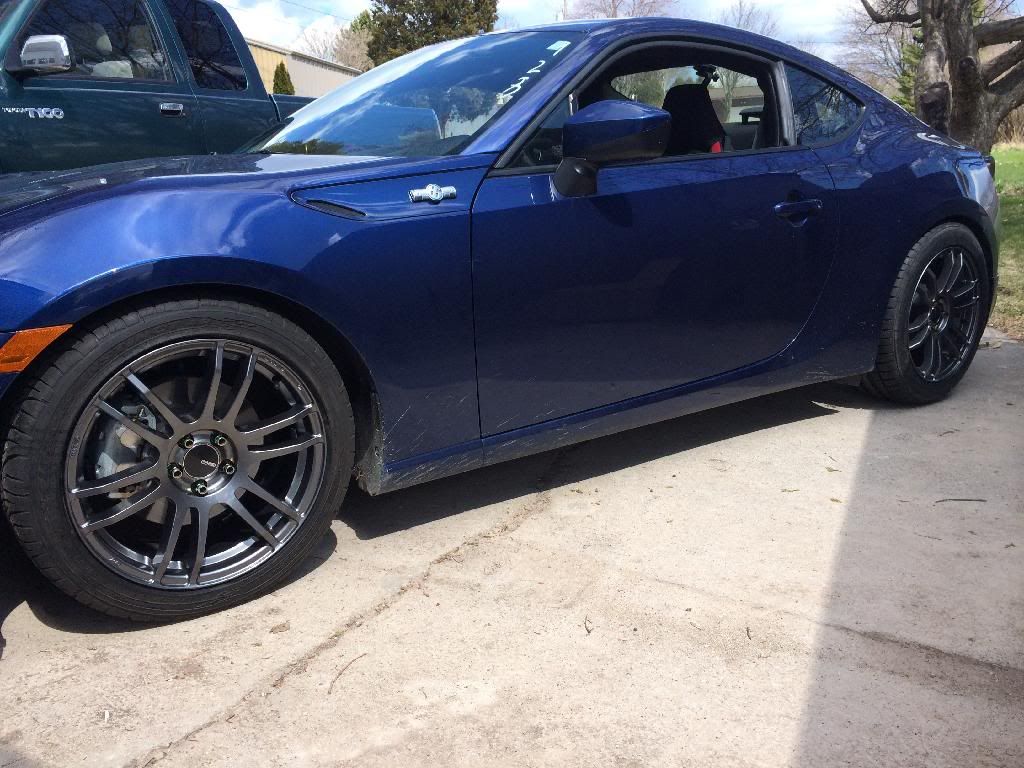

Wheel Directory: Enkei TSP6 17x8.0 +45 / 17x9.0 +45
Both +45
225/45/17 f
255/45/17 r
No rubbing but planning on getting 5mm spacers to give me more room in the rear. Too close to the ebrake cable bracket for my liking. Post pics tomorrow
Ill post better pics later

Wow they look real nice.
8.5 front and 9.5 rear?
Please post more pics!

8f 9r
