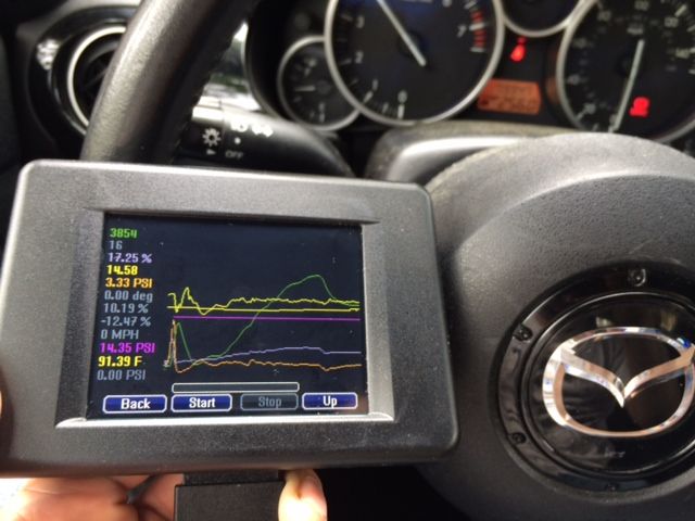

Smile OpenFlash Tablet: Multi-Gauge Function and FLKC logging
As shown on an MX-5. But works the same on the FA20, BMWs, RX8, Mazda 2, etc,.
[ame]http://youtu.be/Aar9SyK3Uwc[/ame]
Facebook Page

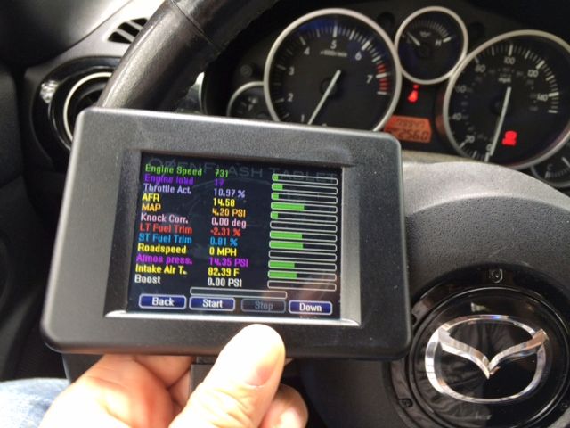

Why buy add-on gauges when the OFT can do it all? Pick what channels you want to view in realtime and with multiple viewing options. Fine Learning Knock Corretion (FLKC) has also been added to the list of available datalog channels. Right now, FLKC is only functional on USDM ROMs but next week we will add support for nonUSDM ROMs next week.
Free update to all you OFT users out there. Just connect your OFT to your laptop and run OpenFlash Manager software with an available WIFI connection. It will automatically update your OFT to enable Enhanced Data-logging and Multi-gauge features. You will also need to upload the new Template file to your OFT. You can download from our website here: http://openflashtablet.com/products/...ads/index.html

@shiv@vishnu noticed COMMANDED AFR has been removed from parameter list was useful for maf scaling AFR actual still there ?
It's still there. But at mis-named as "Equiv RC". I'll fix that and release another template file later tonight. Thanks for catching that

Is FLKC supposed to be either 0 (usually) or 100 (rarely)? Seems like it may be logging wrong?
It will be zero most of the time. And them go slightly negative or positive depend on IAM/fine learning.
Hmm, we'll it looks like it's logging incorrectly on my old 700C ROM. It's either 0 or 100.
You'll need to load an OTS map for it to work.

so fine kcl should remain at 0 to show no signs of knock?
