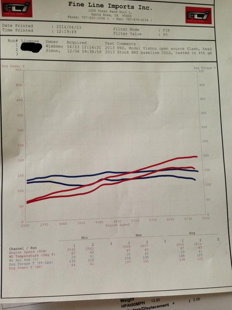

199whp on 91 Openflash and Bolt-ons
Had a day off today and finally had some time to get my car on a dyno. I really wanted a baseline before I pick whatever FI I will go with.
I stopped by Fineline Imports here in Santa Rosa, and luckily they had an opening.
Car did 199whp.
Power Mods:
Perrin Drop-In Filter
Perrin LTW crankpulley
Modified Intake Snorkel
Revworks UEL
Nameless 3" AxleBack
OpenFlash Stage 2 UEL Tune 1.42(Ive been running it for 4 months) @shiv@vishnu
[ame="http://www.youtube.com/watch?v=uhsG3B8Arbk&list=UU_UJly0APIdF8i6sZ7PTdjA& feature=share"]Scion Frs on Dyno - YouTube[/ame]
Blue is a stock car they had in on a very cold day

199 whp =/= 200!

instaban for claiming 200whp when car really did 199whp!
jk, awesome results! Nice to see dyno sheets with 91 and headers!

haha, it looks better in the title.

Whoot whoot! Great results.... and nicely modded car

Impressive numbers. Was the tune modified or is it the OTS version? And how modified was the intake snorkel? And stock overpipe, frontpipe and midpipe?
I'm asking all this because I'm eventually getting something very similar. My OFH, OFT and Perrin drop-in is coming and I have a catback already, although not a 3", but with the stock pipes in between that and the header, I'm guessing the restriction is the same even though you have 3" for the axleback.

Completely stock exhaust minus the axle back and header. Intake snorkel has the resonators removed thats all. Basically it has 3 holes to pull air from instead of one.

by intake snorkel you mean the inlet hose right?

Look again.

What type of dyno? Looks like a mustang. And if it is, looks like it reads high. Anyhow, great stuff!
