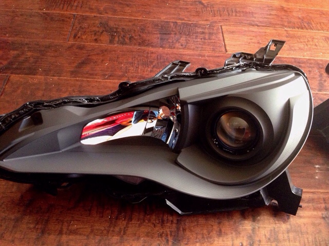

Followed the DIY, but didn't black out all of the reflector.

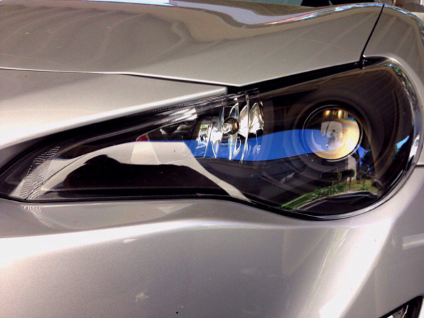

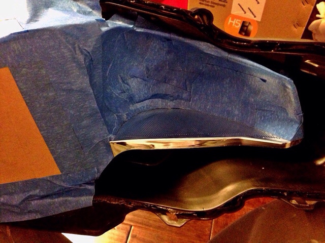

I painted the bottom of the high beam reflector so that when your looking at the light from above (which is always), it looks completely blacked out.

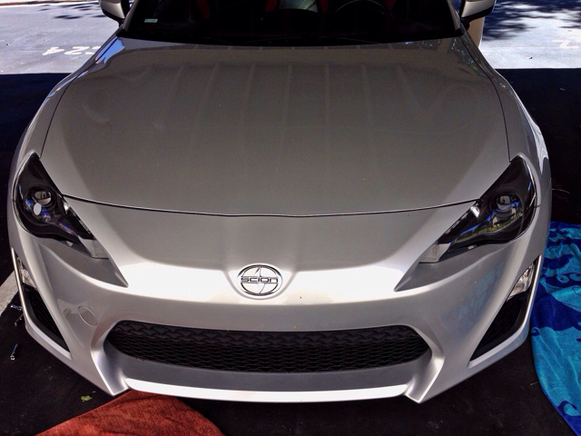

High beams are only slightly dimmer. Wouldn't have noticed if I didn't know.

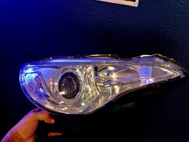

Thanks. It was way easier than I thought it would be. I was worried about baking the headlights, but that was the easiest part. I couldn't find anything that would clean the reflectors without leaving whitish haze and streaks. Tried rubbing alcohol, pure alcohol, glass cleaner with paper towels, cotton, microfiber. Nothing got it completely clean.

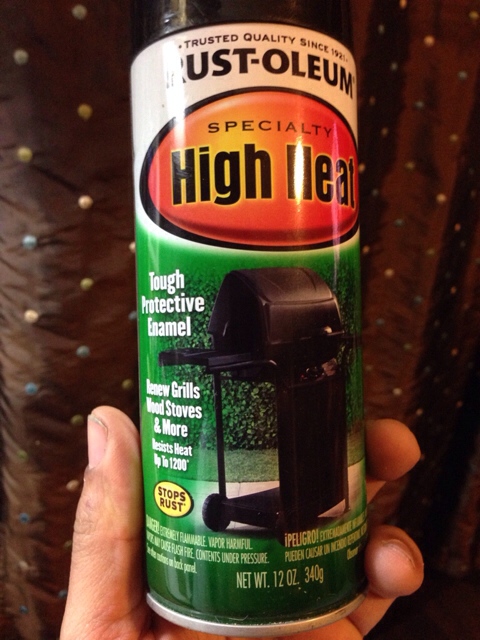

what type of paint did you use?

Pcporo I used this stuff just caus' I had it on hand and it was flat black. Name:  ImageUploadedByTapatalk1394512763.997852.jpg
