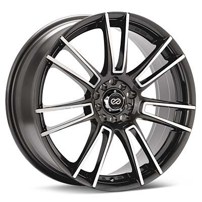

Thank you guys, Ive been looking a lot and I think I did actually find the set for me. lol, its funny because they look A LOT like the stock rims which I like so much, but even a little better AND a little lighter :o)
What do you think?

Enkei Fujins are in your budget, and are lighter with better fitment than the T-Forks (+40mm offset 17x7.5 wheel weighing 17.1 lbs versus a +45mm offset 17x7 wheel weighing 18.2 lbs)...

Ok, so I checked out the titans and theyre not bad. I like them in both black and hyper black, but I dont think they will work with my tires? (PSS, 215 wide) Also, the fujins are a model that I was considering for a while and theyre not bad either but they just dont do it for me :o/ same thing with the RPF1, I mean obviously yes they are a really good choice and TONS of people are using them but for whatever reason I just dont care for the looks of them. I guess Im like 60% form 40% function on this. Im still really digging those T-forks, almost certain thats exactly what Im looking for. I do appriecate all of your help and sugguestions, and Id like to hear some more if anybody has any.

Thanked 7 Times in 5 Posts
I am curious though about when you say better fitment, CAN 215 wide tires be fitted to 7.5 wide rims? and if the offset is 40mm isnt that further away form oem than 45mm? Im not gonna lie, I have never purchased aftermarket rims before in my life and I really want to get this right, and hopefully learn a bit along the way. Thats a big reason Im trying to keep everything as close to factory as possible, I dont want to just go "modding" my car without understanding exactly what Im doing and why Im doing it. Also why Ive decided 'what the heck, I had better start asking around no matter how dumb I might sound lol'
As far as I can tell, and correct me if Im wrong because I very well could be, the factory rims are 17x7 48mm offset. So if I go with 17x7 45mm offset, that is only 3mm away from factory, and its actually 3mm wider than factory, so thats a good thing, right? Or if anything a nearly inconsequential thing.
If the 215 tires do fit on 7.5 wide rims and the offset is 40mm, wouldnt that make it 8mm wider than factory? Possibly creating the 'poke' stance that people (myself included) want to avoid?
Im trying to learn and 'see' as much as I can using the fitment calculator in the sticky but as good of a tool as that is I just need more practical insight, I suppose.
