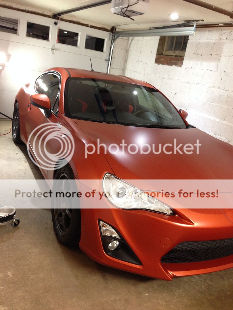

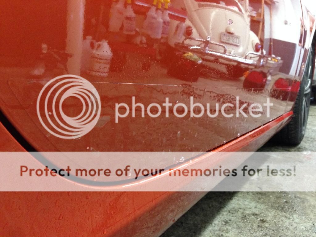

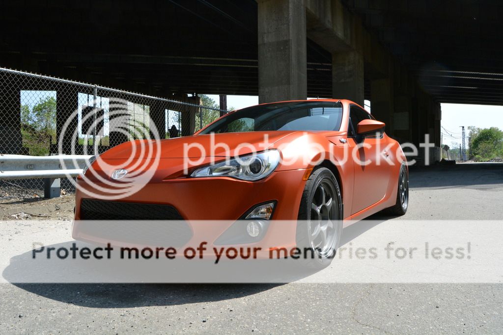

***UPDATE

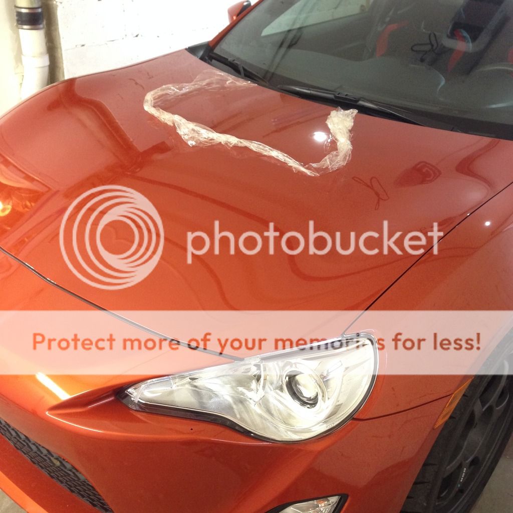

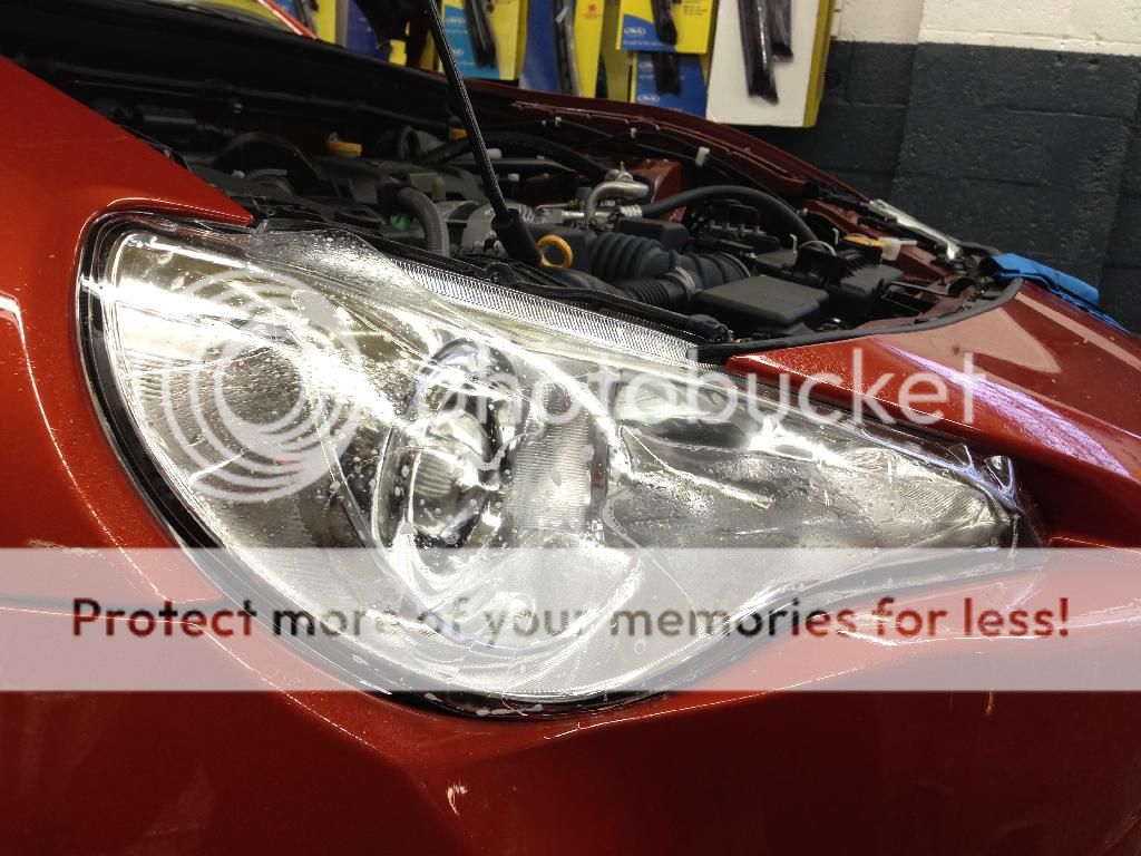

We went through with it and wrapped the whole car in xpel stealth PPF. Removed all of the old film and removed as many parts off of the car as possible. Only thing I left was the headlights because I didn't want to remove the bumper and I knew I could tuck in the film in the edges around the light.

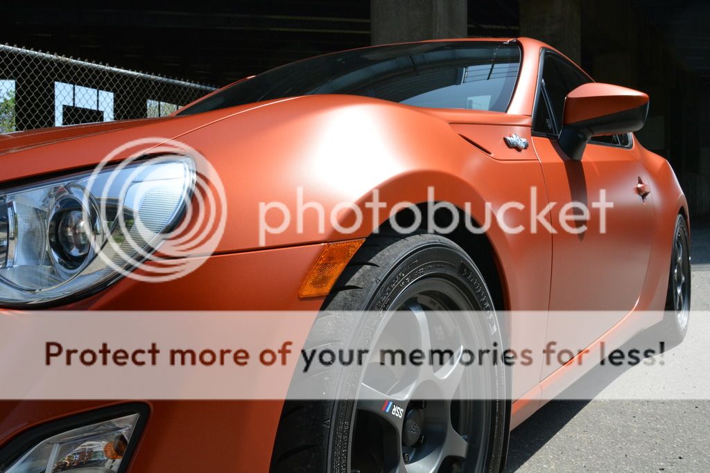

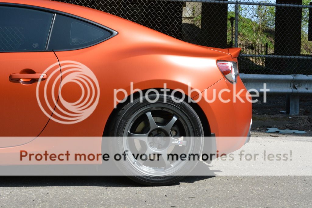

Finished pics
Pics of the process

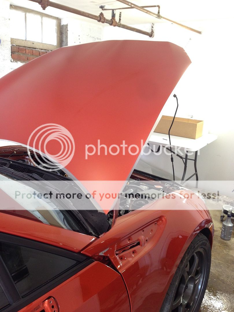

Removing the film off of the hood

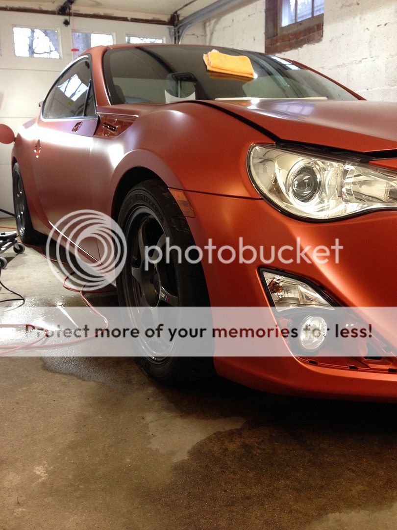

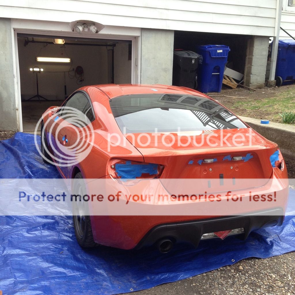

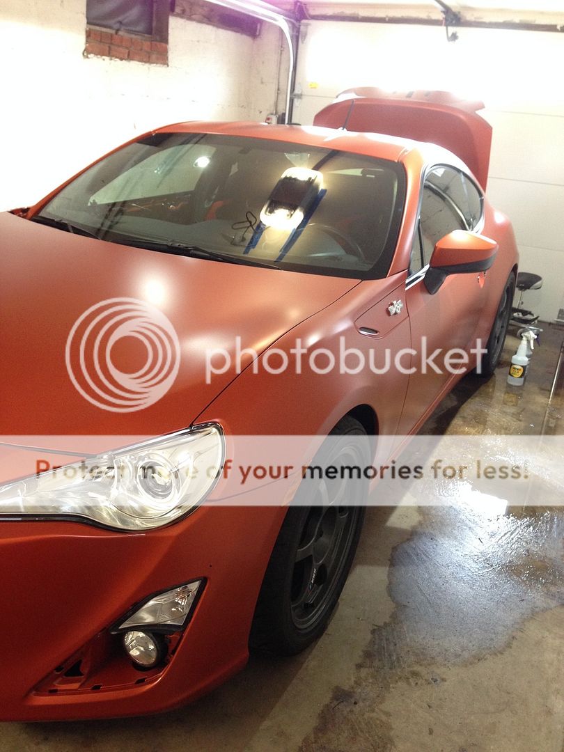

Prepping for a full wash and clay

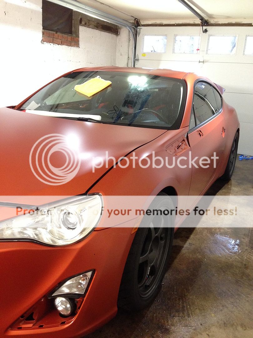

Dried and ready for surface prep on sections that film will be installed

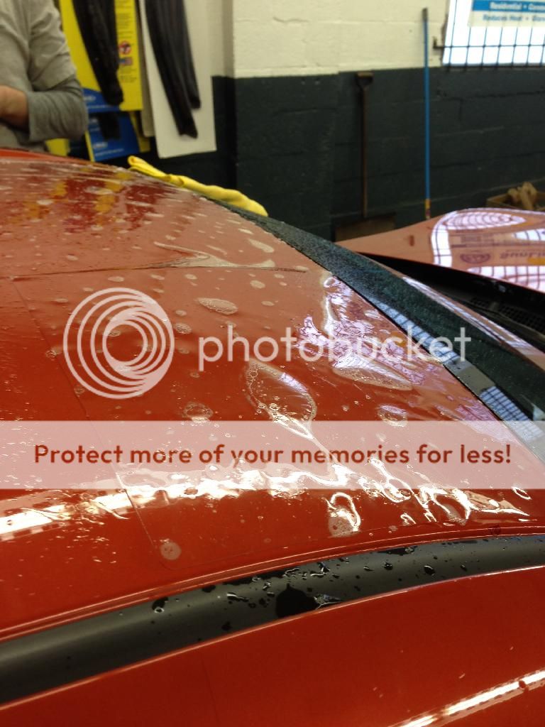

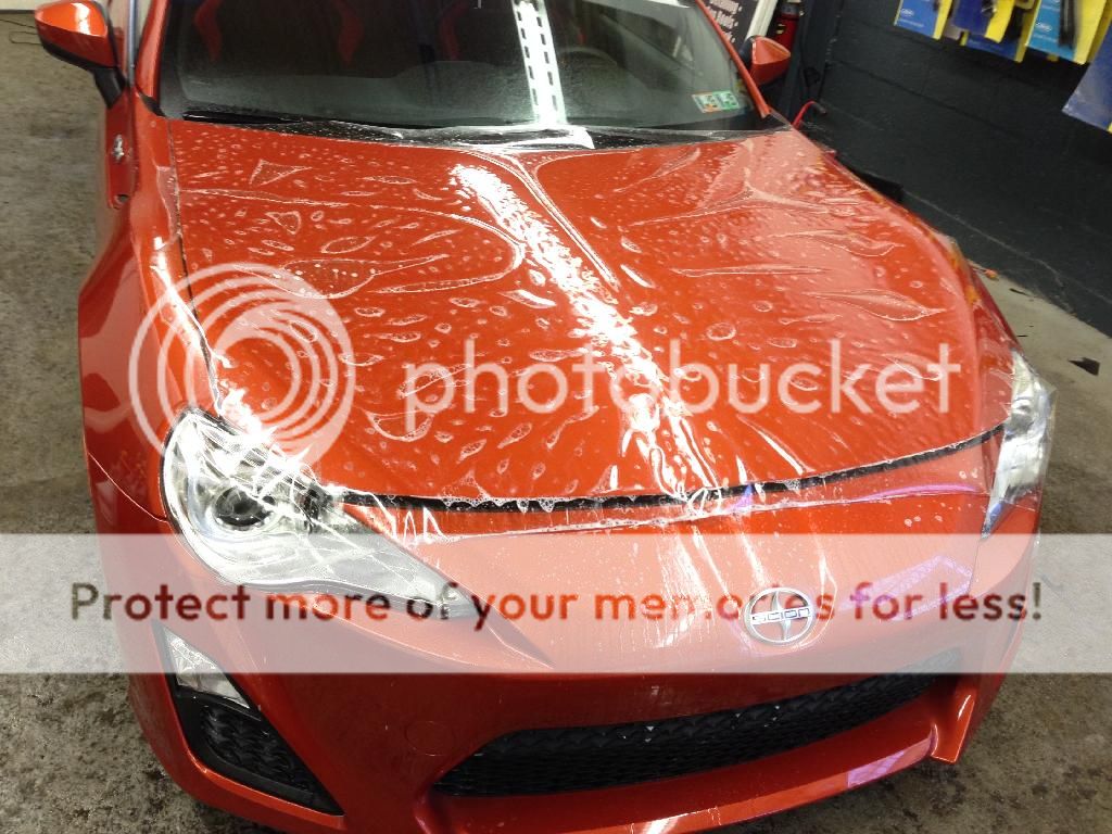

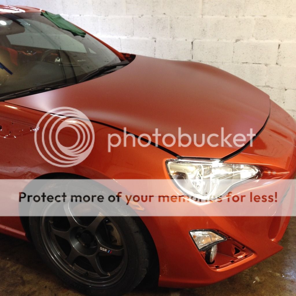

Hood piece going on
Edges trimmed and waiting for them to dry to wrap them over
Hood done and on to the next piece
Driver side quarter done
Different angle
Close up

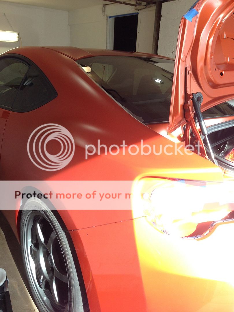

Roof, door and fender done. Let them dry for the next day to trim
One side done

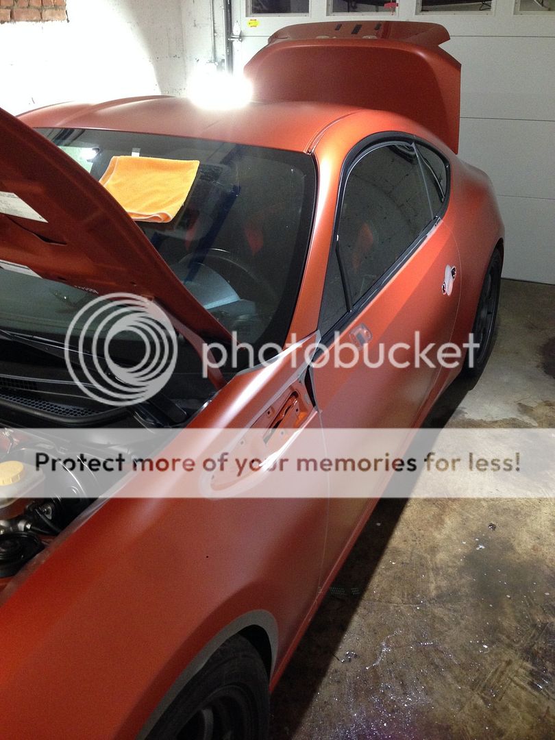

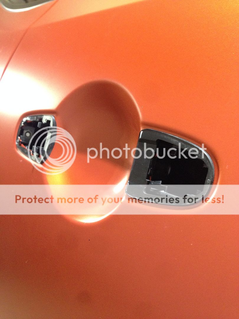

Front bumper and other side
Close up of door handle area

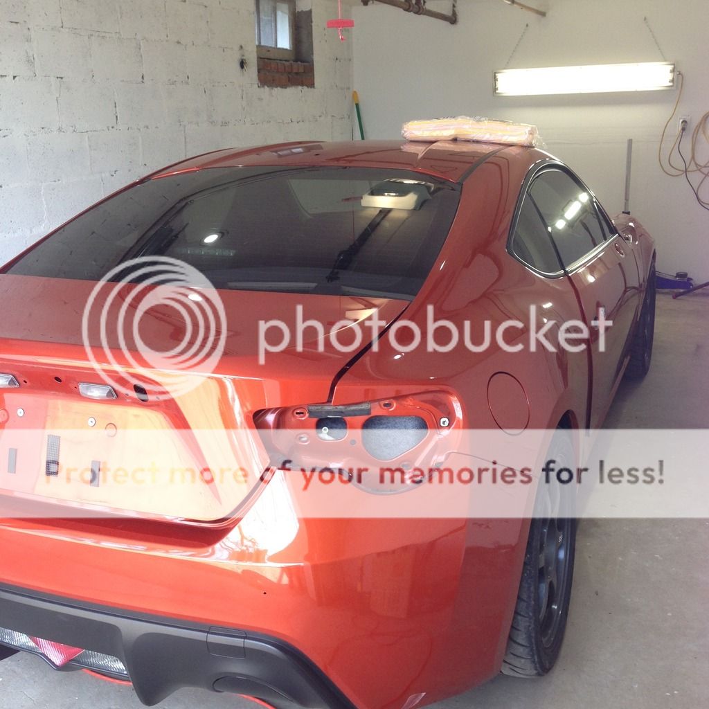

All done and going back together

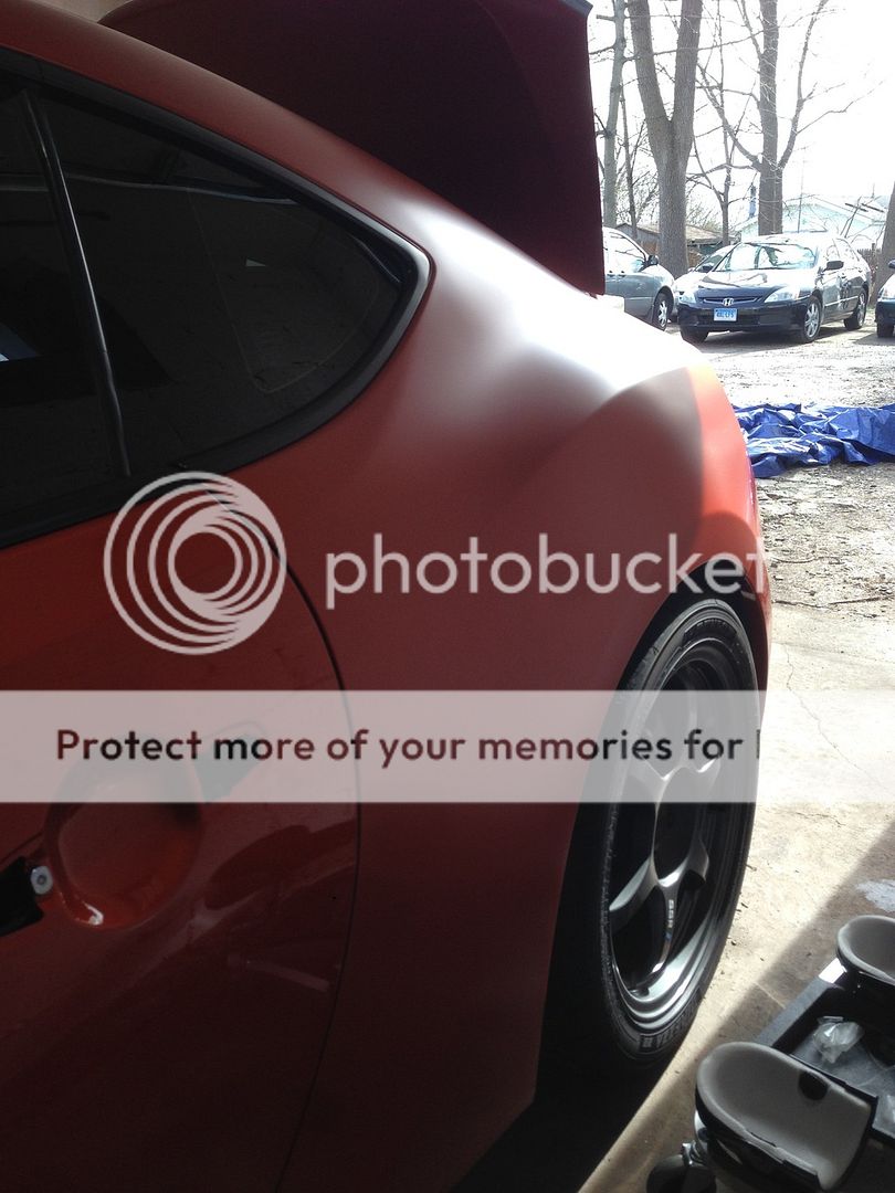

So 3 days after taking it home, we decided to "wrap it up" as we say. Luckily this is what I do for a living so it didn't cost me anything. At first I was thinking of wrapping the whole car in matte-clear because this is an awesome color for it but the film wasn't available at the time and I wanted it protected asap so we decided normal film with the most protection possible.
The film used is Xpel Ultimate, everything is pre cut-out expect for the hood. We like doing hoods by hand because its faster and easier. List of parts protected (don't have a picture of everything):
-Full hood
-Full fenders
-Headlights
-Bumper
-Mirrors

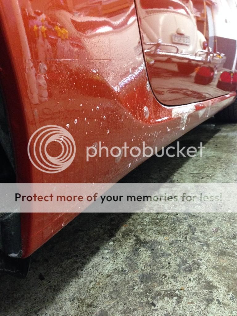

-Rocker panel
-Lower door section
-Door edges
-Door handles
-A pillars
-Roof section
-Rear wheels arches ( behind rear wheels )

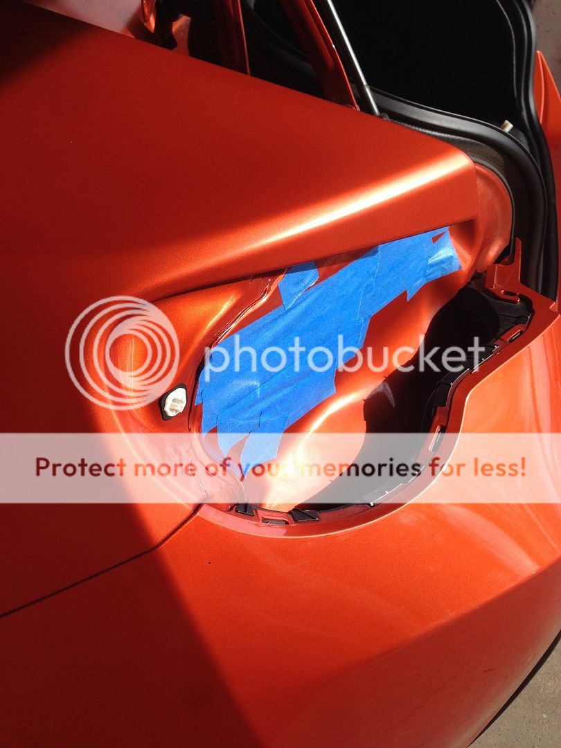

-Rear loading area

So did you end up doing the headlights?
When I bought my BRZ I went to a few places to get this done eh
most places said they couldn't do the side mirrors and didn't recommend the headlights?
BlueSky is offline   Reply With Quote

^I have both my mirrors and headlights done. I cringed when the xpel ultimate was removed. I'd love to have my entire car covered.
