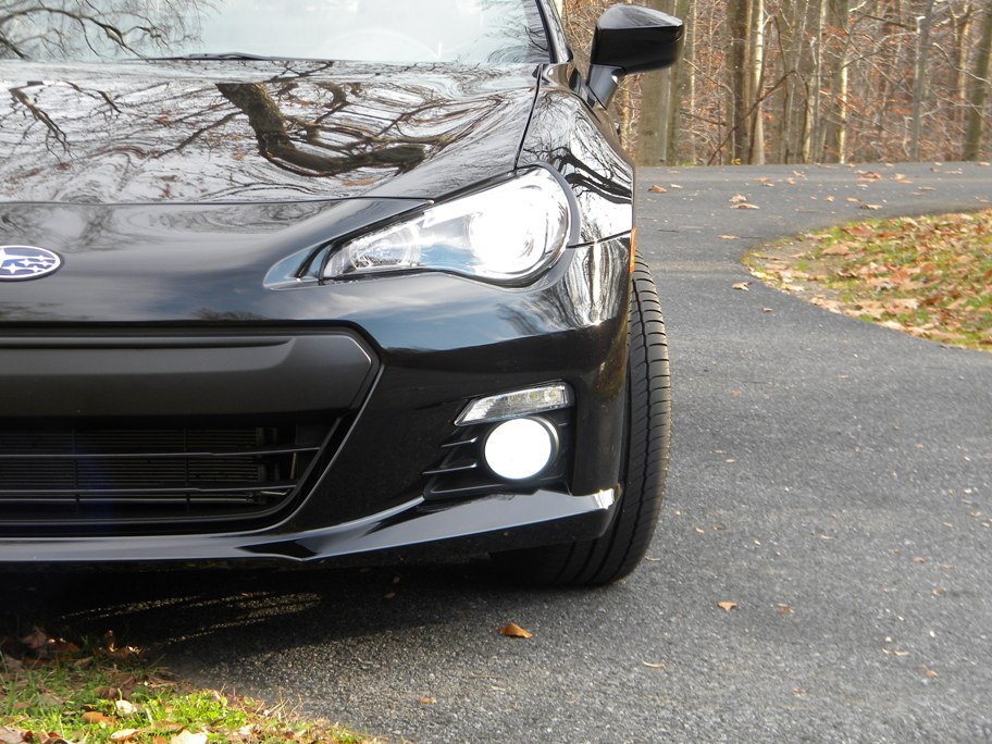

I'm not sure what 'K' the factory BRZ headlights are, but here are my fog light LED's from HID Powerhouse and they match. I'm sure Ken can tell you what these fog replacements are. I know the FR-S is set up different as far as lighting goes, but he can probably tell you what 'K's' are what and get you matched up.

OEM HID color temperature is 4300K.
