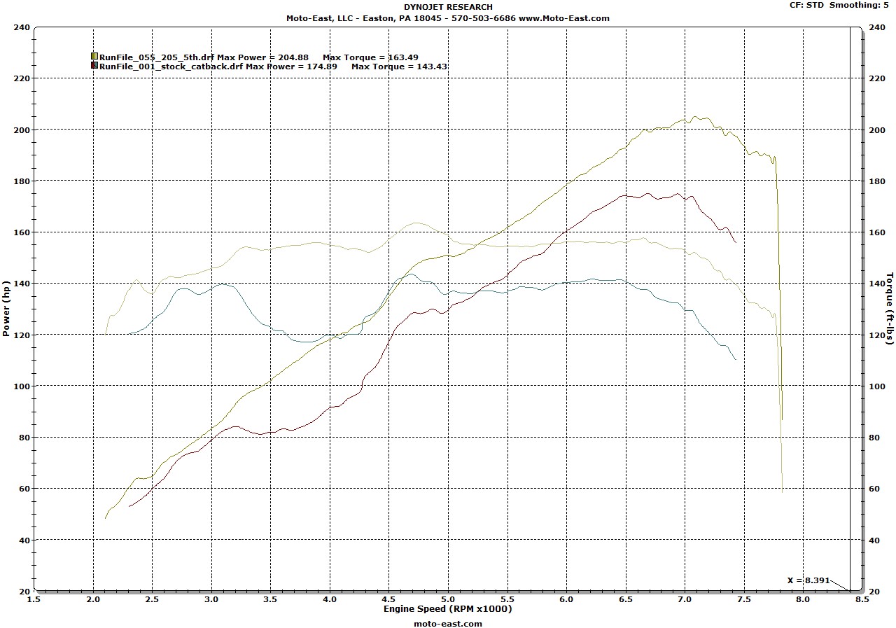

Header comparison. NO E85
RevWorks header + full nameless exhaust + drop in perrin filter.
FA20CLUB 4-1 Modular Header
E85 only. Waiting for a pump gas dyno
P&L Header Green line is pump gas I guess.
JDL header Only has been tuned on e85... doesn't really count...
Borla UEL header
Nameless Header
Now everyone do me a favor and look at the torque curves.... Look back at the revworks.... Yupp.... thats some awesome. I'll get some better dyno's of the RevWorks header soon. And some comparisons. Everyones thoughts?

Everyones thoughts?
My thoughts are the only dyno graph that looks remotely realistic is the P&L one. Since when did changing an exhaust component give you a proportionate increase in torque across the range? (ignoring the remap tweaking in the torque dip).

I thought the P&L green line was pump gas too. Only difference was the red line was no tune and green line was Visconte pump base tune.

No comparison really until you get them all on the same dyno, otherwise the variance in dyno readings could just as easily impact the results as the actual performance of the header.
Look at the scaling on the revworks dyno graph, for instance. The scale covers from 50-450 ft/lbs, of course a torque curve on that graph is going to look flatter than one on a graph scaled to cover 75-200 ft/lbs.

Ignore the darker line. That's with E85. The light line is on pump.
You got this one wrong. THe light colored lines are pump gas but they DO NOT include the header.
Originally Posted by FA20Club.com View Post
nope baseline was with 93 octane, fa20club cai & fa20club ecutek tune
Also, the P&L Green line IS pump gas with visconti map.
So, my thought is...
"You bought the wrong one silly"
LOL, just messing with you....
Most of the headers do allow for dip removal with tuning. stock cam timing around the dip is not optimal with a header since it is setup to try and get around the limitation of the stock header.
Your plot look great btw where did they put the temp probe and what correction factory do they use?
What he said.
I do like the attempt to compare without E85 though since a lot of the dynos we are seeing are skewed by using E85, but most of us can't or won't use E85 for our cars.

Each car is different, each dyno is different, conditions (temp, humidity, etc.) so all data must be normalized. A baseline run needs to be done which I don't see on the Revworks dyno, so the delta (in percent) cannot be calculated nor compared to the others. Consider adding notes such as UEL (typically uncatted) and EL (catted I'm assuming), which tunes they were running, and all known mods.
