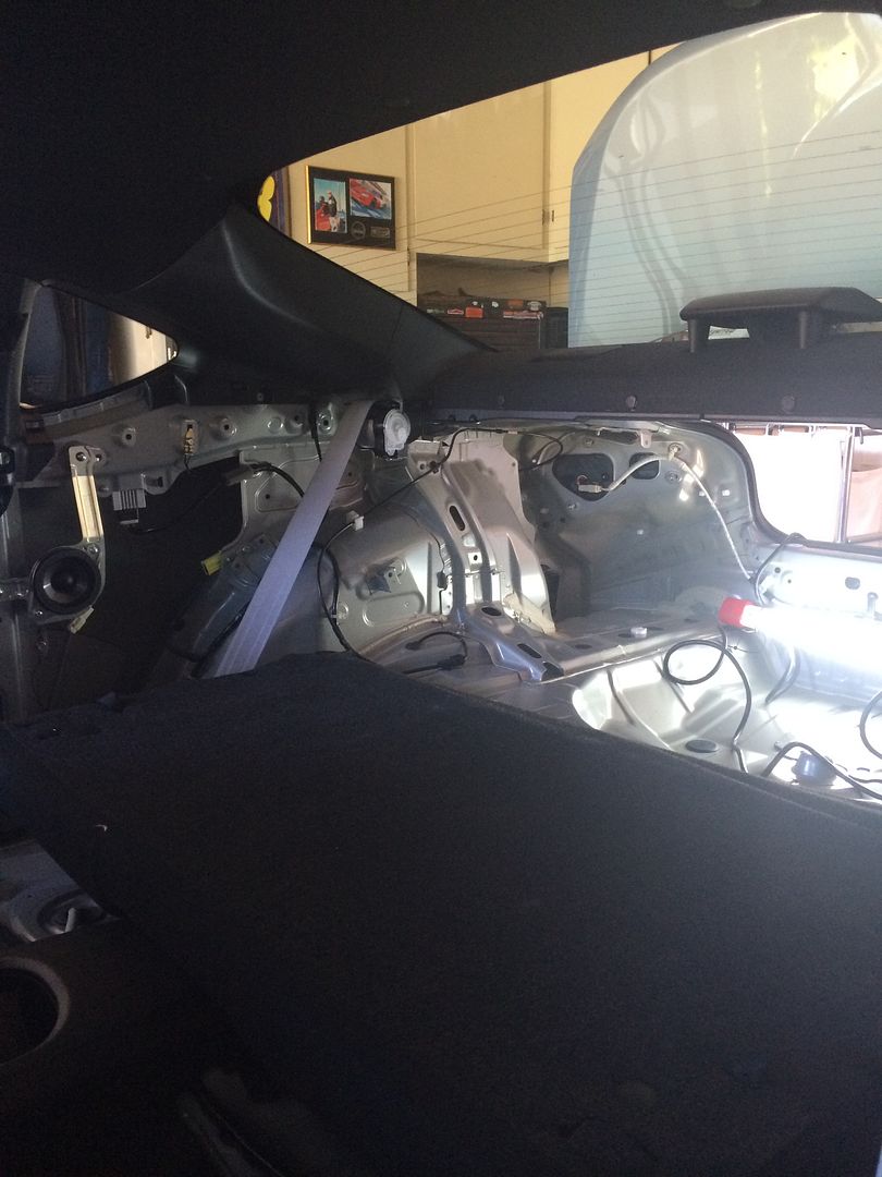

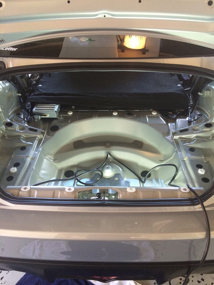

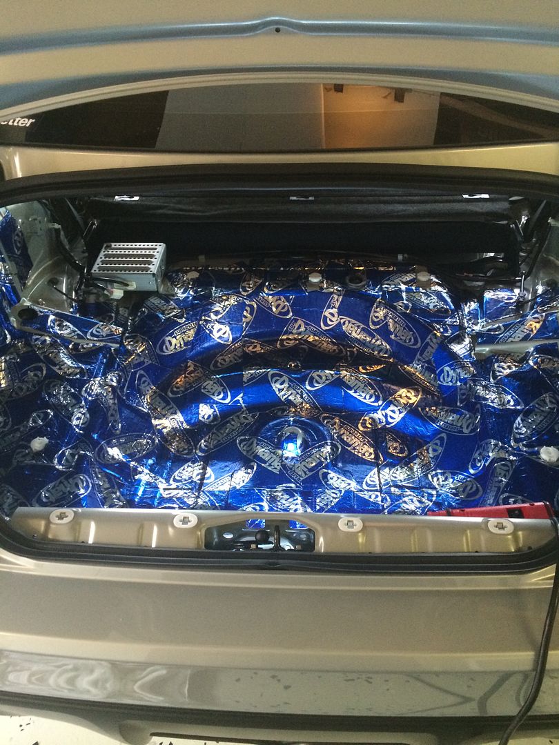

I have just hit 6,800 miles, and I have heard crickets since about 1,800 miles. Crickets aside, I have always wanted to have a dynamated car with a good stereo system, and I have to give a big thanks to @oemaudioplus I recieved my reference 400+ system as part of the recent group buy with super fast shipping and great service. Finally got around to getting the dynamat and system installed this saturday.
Before:

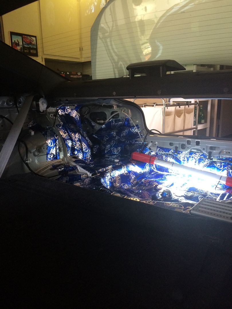

After:
For now I have just put the dynamat in the trunk area, when I took the pic I had a few touch up spots left, but I was getting too excited to hear the OEMaudio+ that I left the rest of interior for a later time.

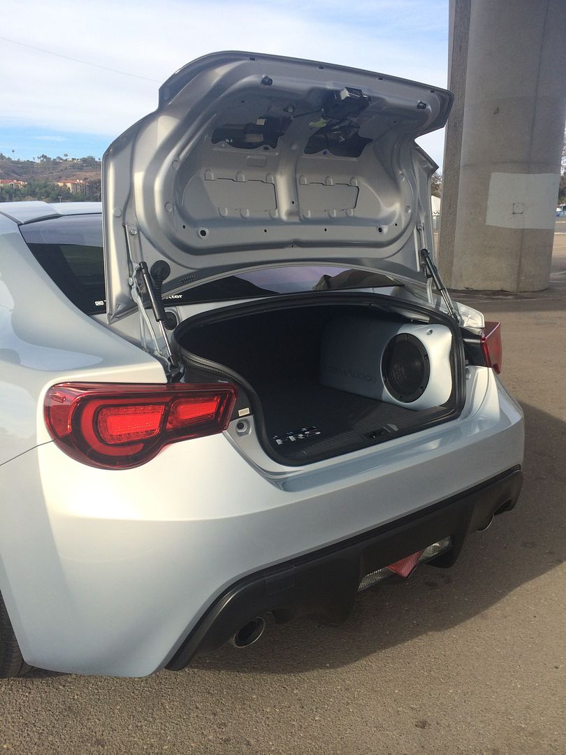

Finished product:
Took a nice long drive today and couldn't hear my crickets at all, I had nothing but the sound of sweet tunes.
I purchased the dynamat superlite bulk pack it has 48 square feet, in the trunk area I used about 20 square feet. the shipping weight of the dynamat box was 17lbs, and there was probably 1lb worth of packing materials, so I am thinking installing the entire 48 square feet would add roughly 15-16lbs total weight. I have not noticed any weight increased, however I have noticed tremendous difference in road/exhaust noise. I can't wait to do the rest of the interior.
Extra shot:

I've been toying with doing this for a while. I'd probably start with the trunk, but I don't know if the subaru cover will still fit on the inside.

I hope the subaru cover fits because thats what I plan to get before I dynamat underneath the trunk deck lid , I don't think it should be an issue the dynamat superlite is not overly thick. all the stock trunk pieces fit back into the clips no problem and the liners same thing.

it really is great stuff, my first experience with it, did you dynamat to your entire cab? I am planning to do everything under the carpet, and I have been thinking about doing the headliner but still unsure if that will be needed.

Nope, I actually just did the trunk + doors. I didn't have quite enough; and that was with 2x door kits.
If you know anyone that works for best buy, they get dynamat for WAY cheaper. I think the door kits are 70-80 bucks and he got them for 30 each

I thought the same thing at first, but after I did a google shopping search found this:
http://www.sonicelectronix.com/item_...ack-10648.html
only $168 with free shipping. doing the install yourself saves money too
I suggest getting a roller if you don't have one already makes the job go a lot faster.
