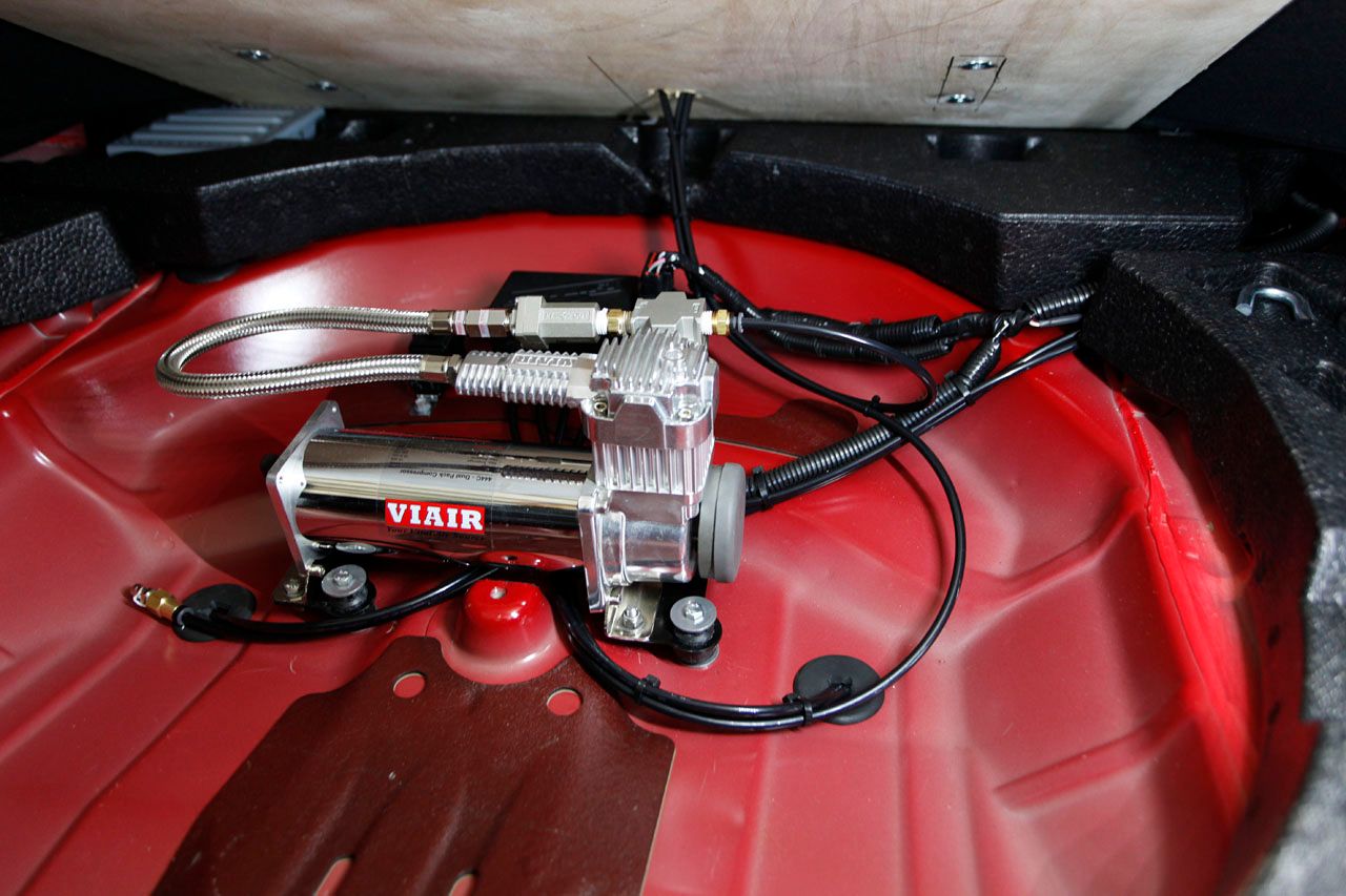

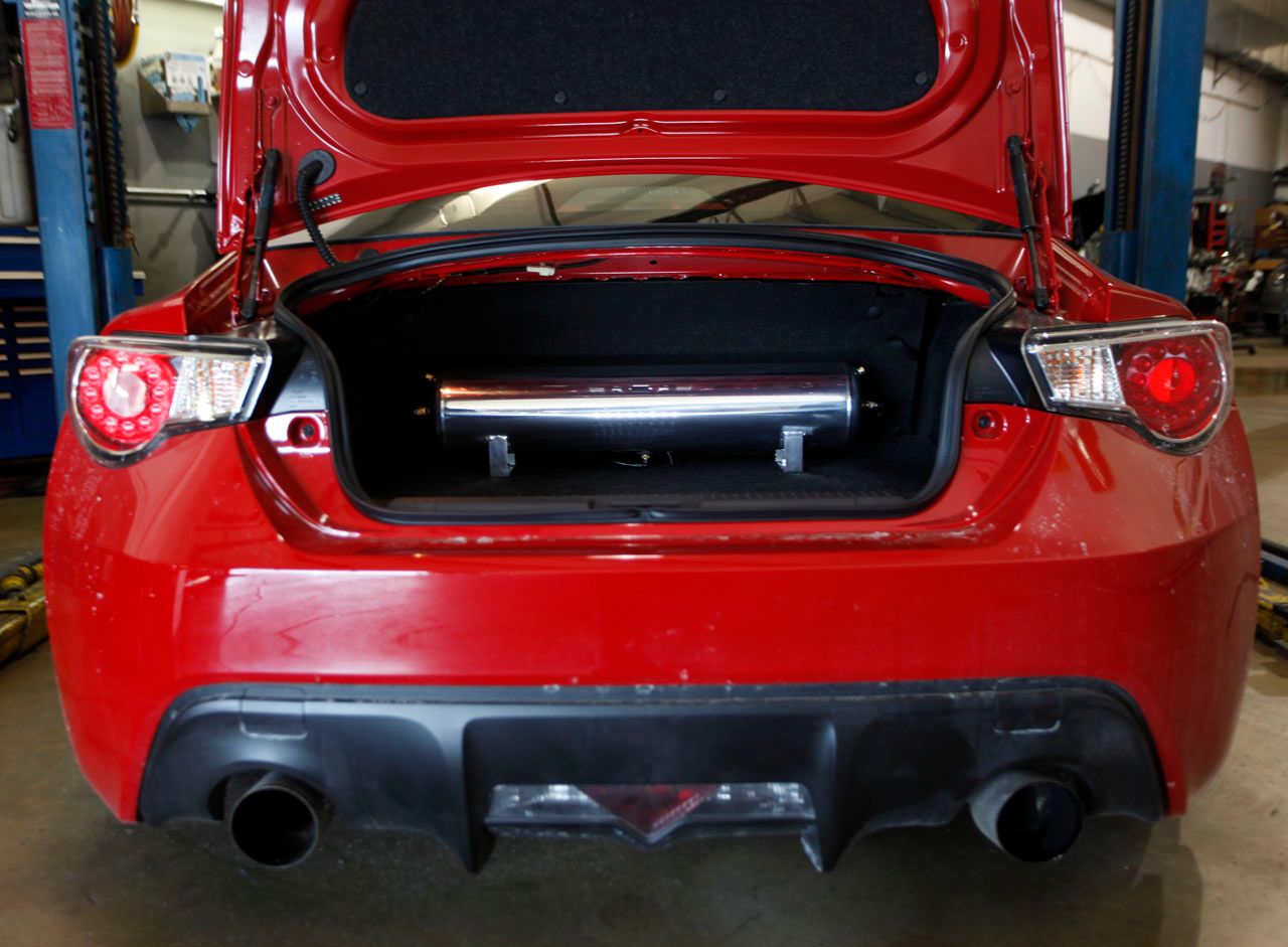

We installed the air tank in the hatch area and the rest of the air management goodies in the spare tire well. We made a false floor from plywood to cover everything up and look presentable.

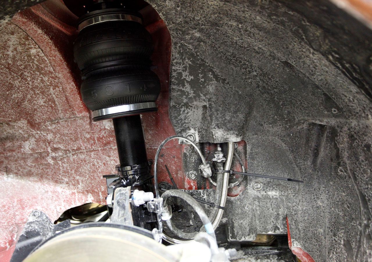

The air spring/strut units bolted directly in place of the stock ones. This is a front unit:
