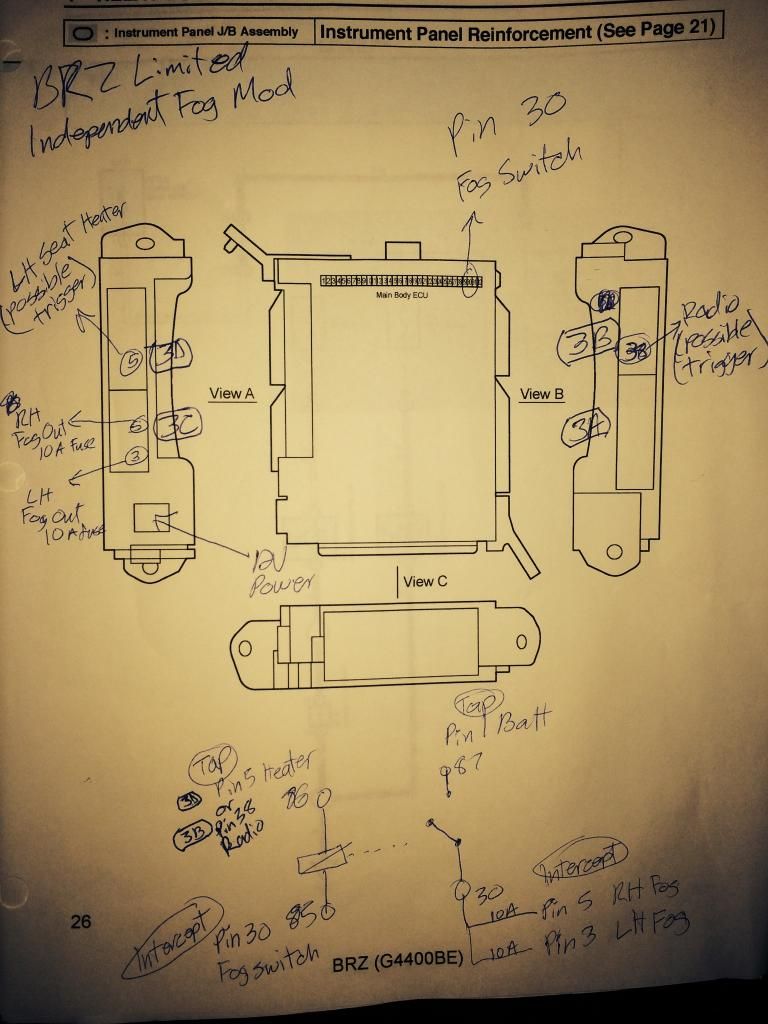

Hi all so im totally new to this forum and have done some research and totally couldnt find anything on this. so my question is has anyone done independent fog lights on their subaru brz because i know that the frs guys got it down now [sad face]. so if anyone has any input on this that would be great.

after reading through the FSM, I found that the relay for the fogs is built into the body computer. I actually bought another relay and was gonna bypass it so I can still use the factory switch, but I decided I didnt want to hack up the stock wiring for now. FRS guys can do this because they are adding the system onto their car with another relay and a switch that would be next to the trunk popper.

Thanked 58 Times in 35 Posts
FWIW, this is what I was working on before I quit.

Originally Posted by Imperius View Post
I did my HID FOG lights using power from a side marker and On/Off switch next to trunk opener fully independent
ya thats the other option. My diagram allows you to use the oem switch on the stalk that comes with brz limited's.

independent fog light means they can be turned on and off with or without headlights being on...which the brz limited cannot do...afaik, no factory foglight car comes with independent fog lights.
