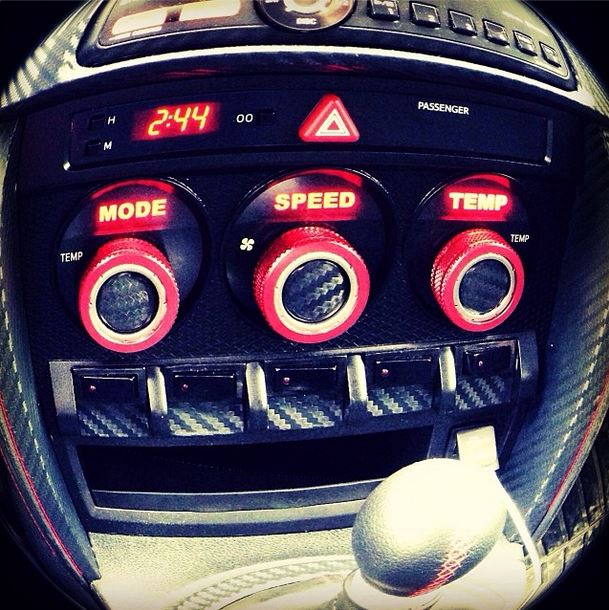

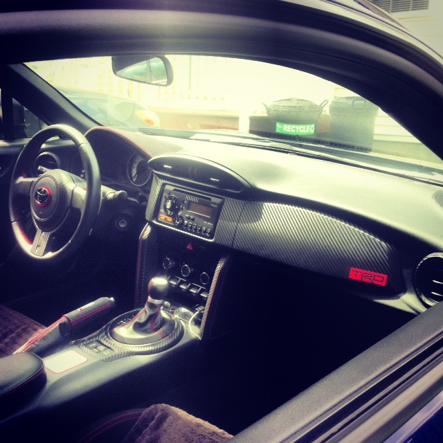

Nice write up! I would HIGHLY suggest using 3M Primer 94 Adhesive Promoter to help the vinyl stick and not peel/bubble.
I did this almost a year ago...
