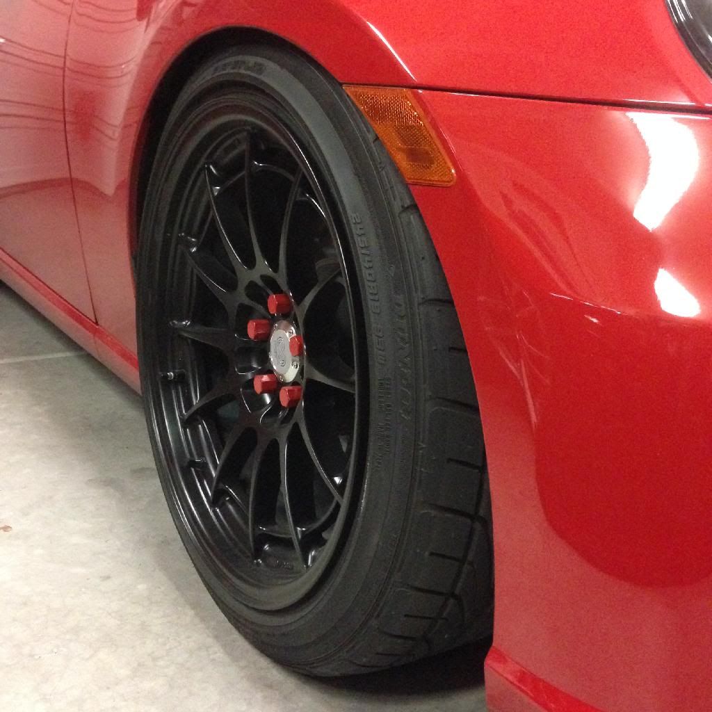

First of all, I have stance coil overs and stance LCAs. I can't say I love them, but they do their job. The main advantage of stance (over the STs that you are comparing against) is its adjustability since it comes with camber plates. When you run a wider/more aggressive wheel setup (I am running TE37SL 18x9.5 square), the camber adjustment comes in handy. Like a lot of DDs, once I set the height on my coils, I leave them as is, so the rebound adjustment is not particularly useful, but its nice to have it I guess. I have had many sub $2000 setups in the past on other cars (KWs, Tein Basics, SMAs (a lesser known Korean brand). The stance were neither the least bouncy or the most quiet setup I have, but you get what you pay for and I can live with it on a daily basis.

I'm not sure how low you're looking to go but I have stance coilovers on my BRZ with 18x9.5 +40 wrapped in 245/40R18. The height I have it adjusted to is 24.5" from ground to top of fender well. (and there's still room to go lower) No fender work done and very very minimal rubbing on a hard bump.
