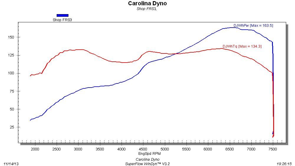

We did a baseline on our AWD Superflow Dyno. One thing we noted both driving these and running them on the dyno is the very choppy feel. The dyno graphs I've seen in person and online all seem to confirm a rough running condition. We will be working to try and solve that ASAP.

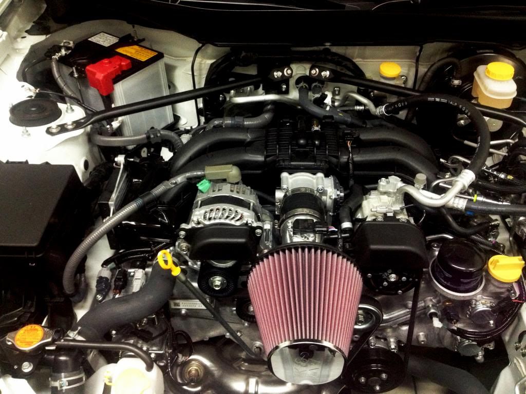

Here's what we came up with for the intake:

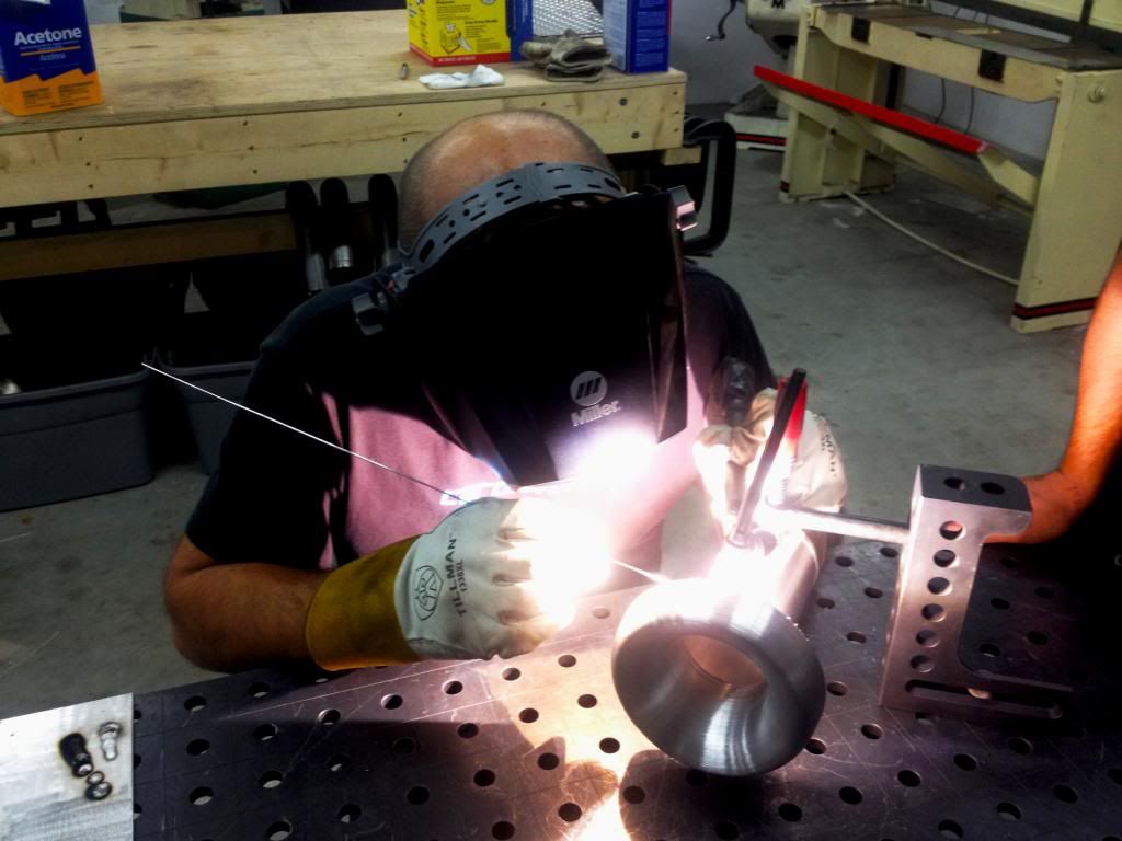

This is what the velocity stack looks like under the filter. We build all our parts in house on our Bluco jig table.

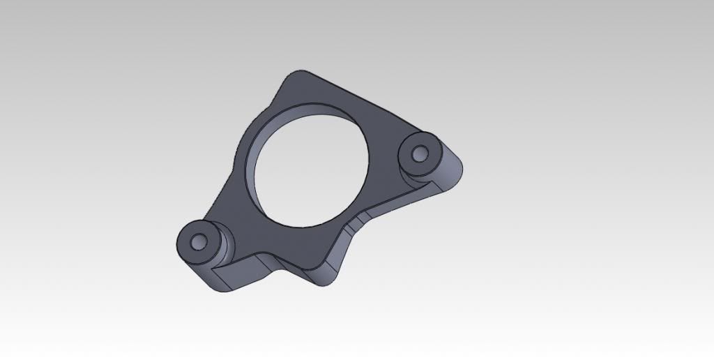

We will be making a lot of solid bushings but we figured we would start with the ones most directly connected to the steering feel.

have you tested the gains with that intake yet? looks like it might suffer when the engine bay is hot

We haven't quite gotten EcuFlash working yet so we haven't done anything besides the baseline.
A fully shrouded intake like the Takeda would probably be best if you plan to stay NA. The idea behind this intake is that it's way better than stock and when we build our turbo kit it will simply be turned 90 degrees and clamped to the front of the turbo. We try to keep our customers from having to buy anything twice (whenever possible). This way you can buy a nice intake at a good price and later if you upgrade to our base model turbo kit you can save some money on the turbo kit and order it with no intake.
