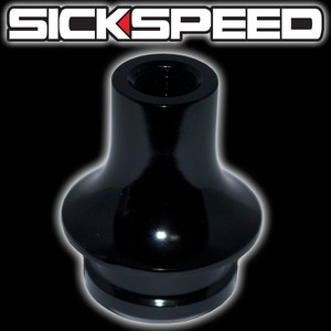

After 2½ years loving my AT GT86 I decided on the following:
1. Don't like the shift knob. I rest my hand on it a lot (bad habit, I know) and it just doesn't feel good in my hand.
2. It's showing tiny signs of wear. I'll store it in a bag so if I want to sell the car it can look pristine.
3. Don't want a metal shift knob, they feel cold to me. Especially in winter.
So, I bought these of the "Gumball Series" from Sickspeed.
They feel like billiards/snooker balls and seems to be of excellent quality.
They came with 10x1.25 adapters and fits just fine, except they don't hold the boot up.
So I also got this:
They informed me that it would not fit an automatic ZN6, but I figured I could modify it somehow.
On inspection the diameter was way too big. There's enough metal so it would be possible to grind down the lip, but I don't have the tools.
I also found it to be too long for my taste.
It is nicely threaded (10x1.25) on top, so it won't rattle.
I cut it in half and grinded it down until it takes about the same amount of force to pull the boot over this as the original knob retainer.
Ended up with 3 parts:
Screwed the first two on like this, and slipped an O-ring down just to seal it a little better.
Finally, the gear knob:
And finally, honouring a sacred pact with @Ultramaroon
The yellow one will go in my truck, though. Along with the shiny Sickspeed stickers.
