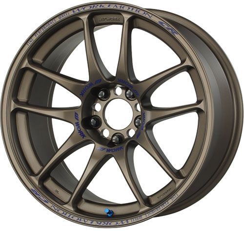

Nice looking wheels! Which ones are they? And are those Hyper Black finish?

They look like Work Emotion CR-KAI in matte gun metal. They don't come in hyper black
What sizes and offset did you use?

Thanks! Theyre Rota Torques and yeah they're hyper black
They're 18x9.5 +35
