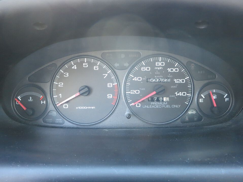

Yeah.. that's it. She has about 163K on her (had an ITR cluster in for ~10-11k to keep warranty a bit longer...) and until recently she still had both original axles (still has one of them!), the distributor has had rotor/cap/screw replaced as preventative maintenance but otherwise is 100% original, original main relay, etc. Maintenance wise.. yeah she's had a lot of parts and was maintained mechanically in my normal fashion (stuff gets replaced regardless of need and in batches, etc).

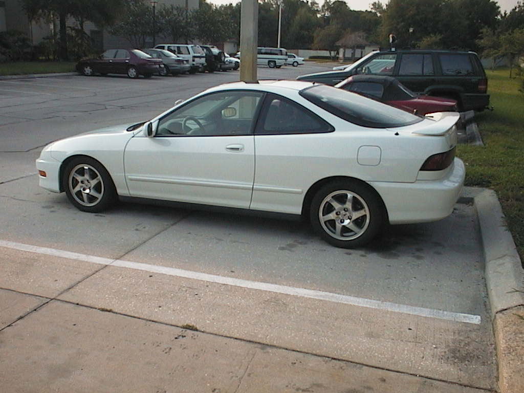

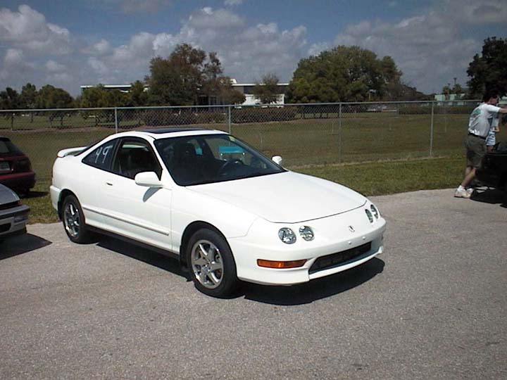

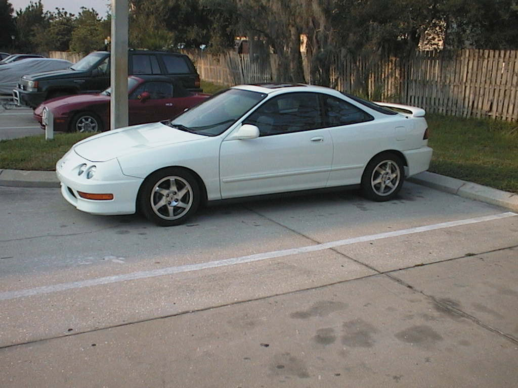

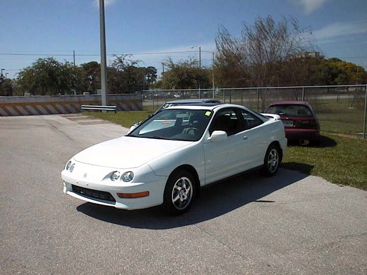

Back when she was new...

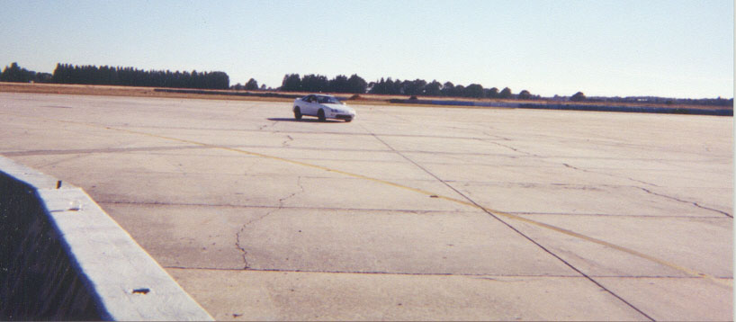

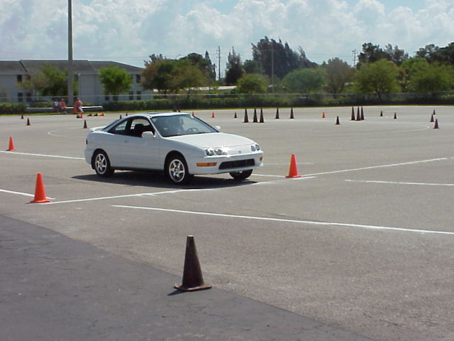

The first autocross.. 852 miles IIRC.
Second suspension mod (first was a comptech rear sway bar, pics are shit so I didn't bother) - H&R Sport springs on Bilstein HD dampers:

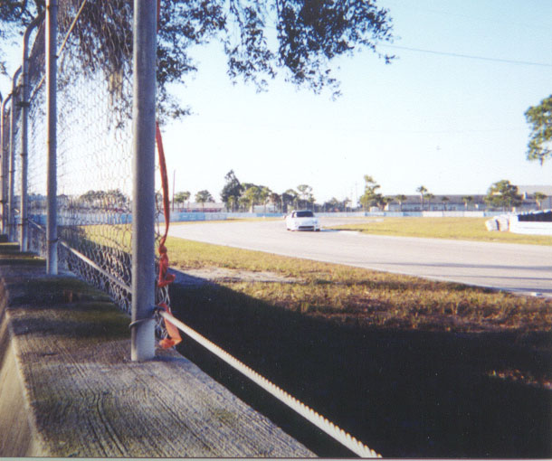

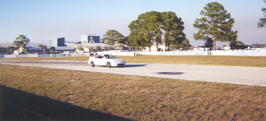

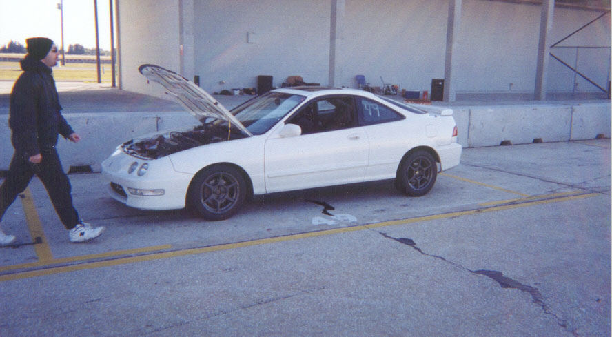

At the track - Sebring - Circa late 2000/early 2001:

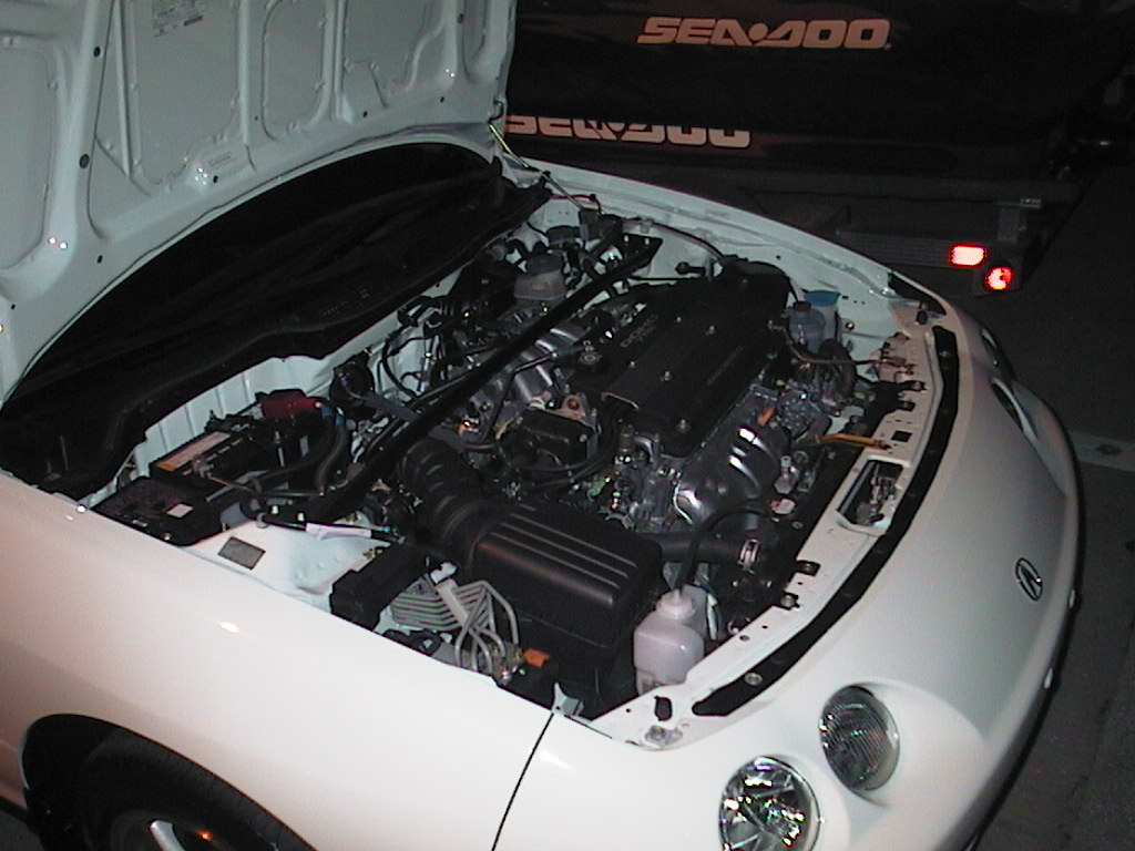

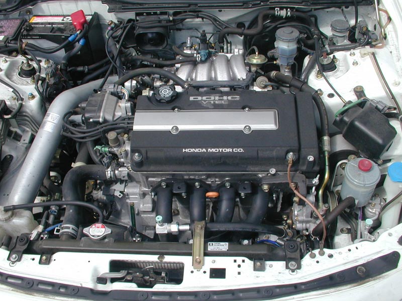

Some engine mods - at this point it was putting down 163/121 on a dynojet - about the same as a stock ITR.

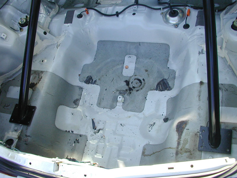

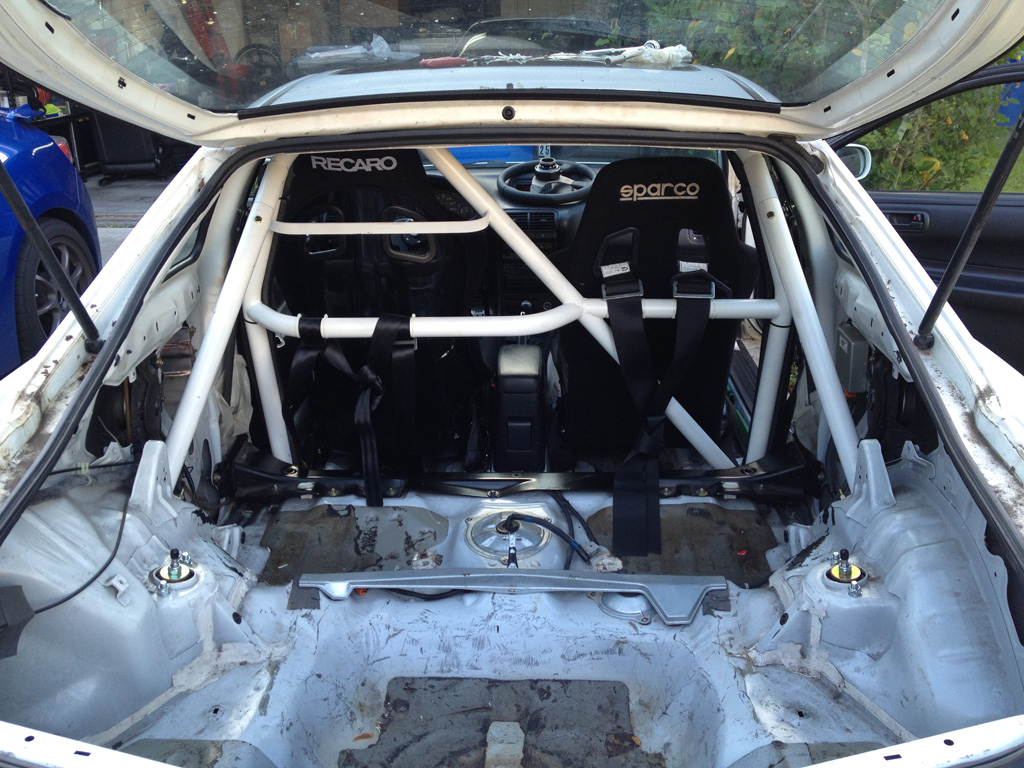

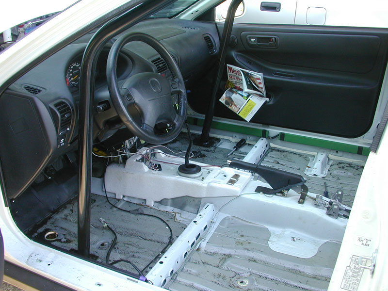

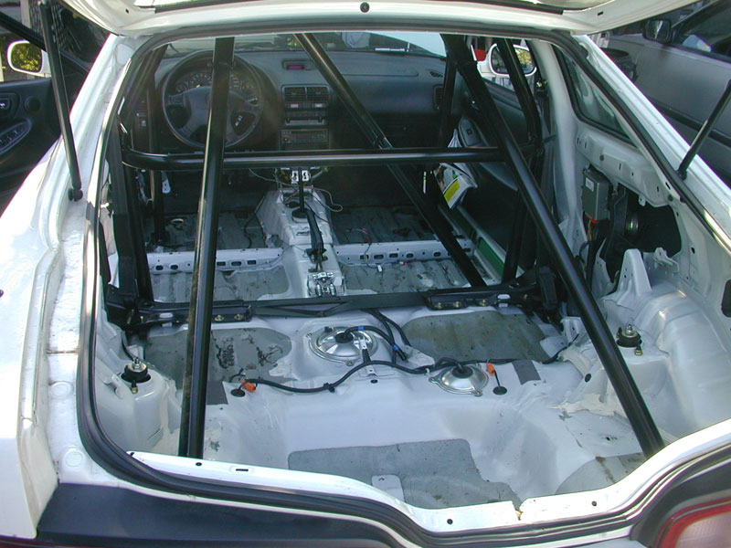

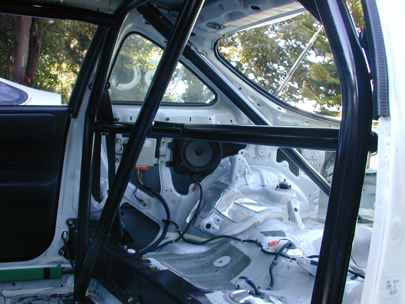

Ahhhh.. roll cage.. leather seats.. yeah back in the day...

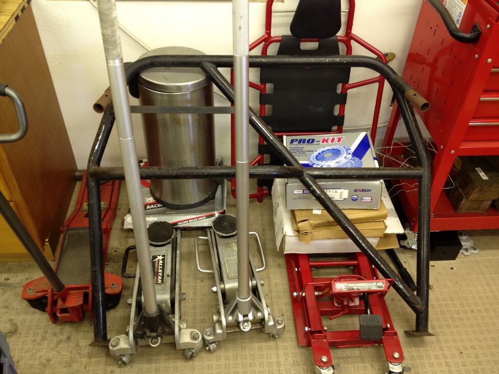

And then it was wrecked a bit.. cage sold to D.. some mods removed.. eventually subframe damage.. not washed for 6 years or so at a time..

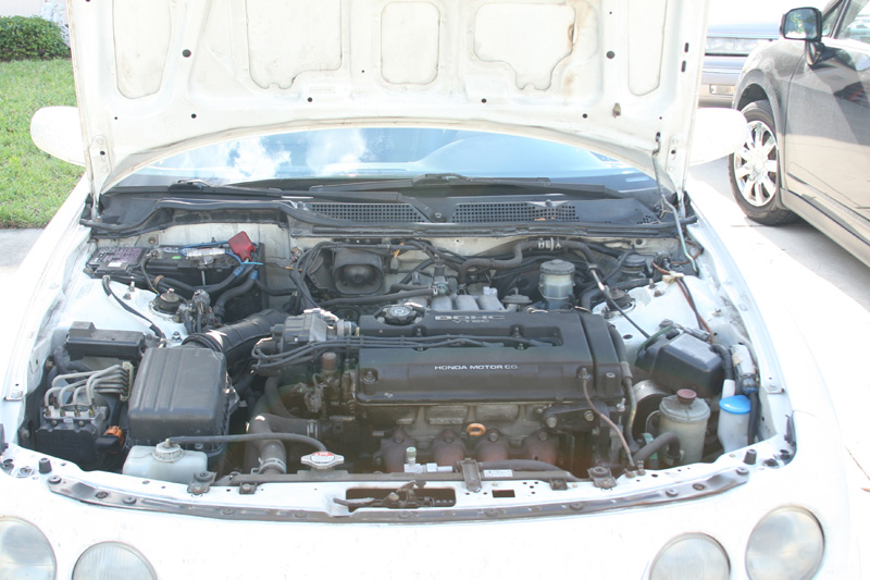

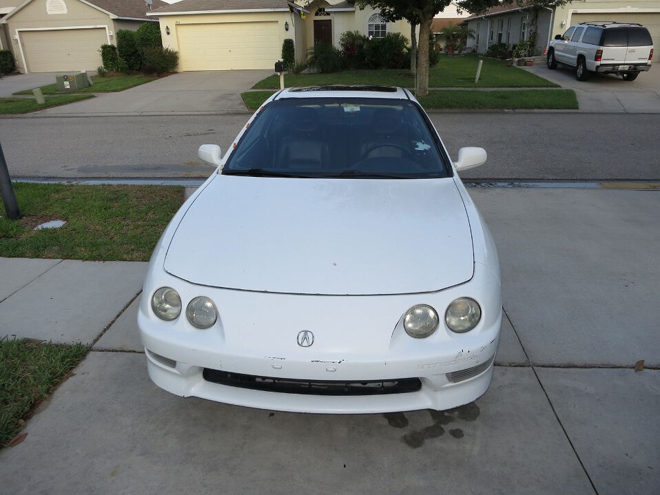

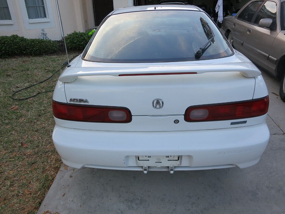

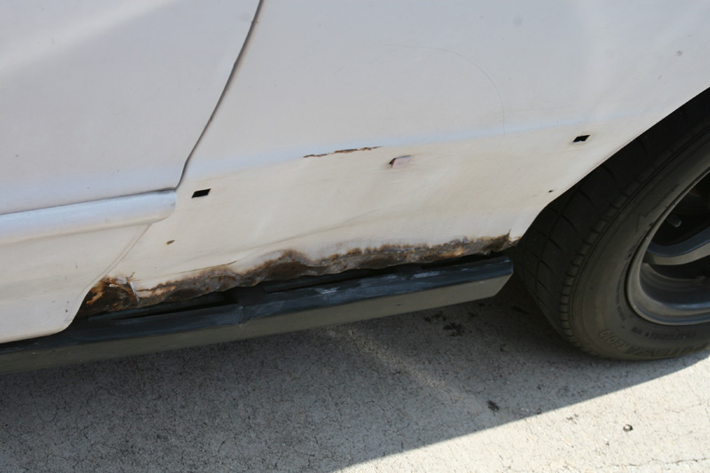

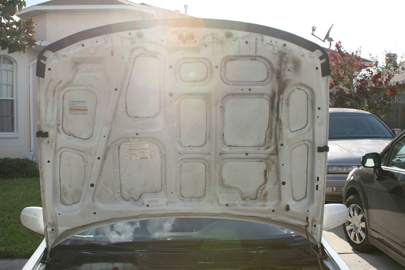

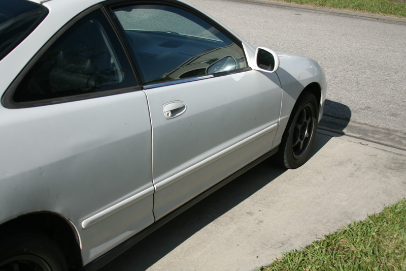

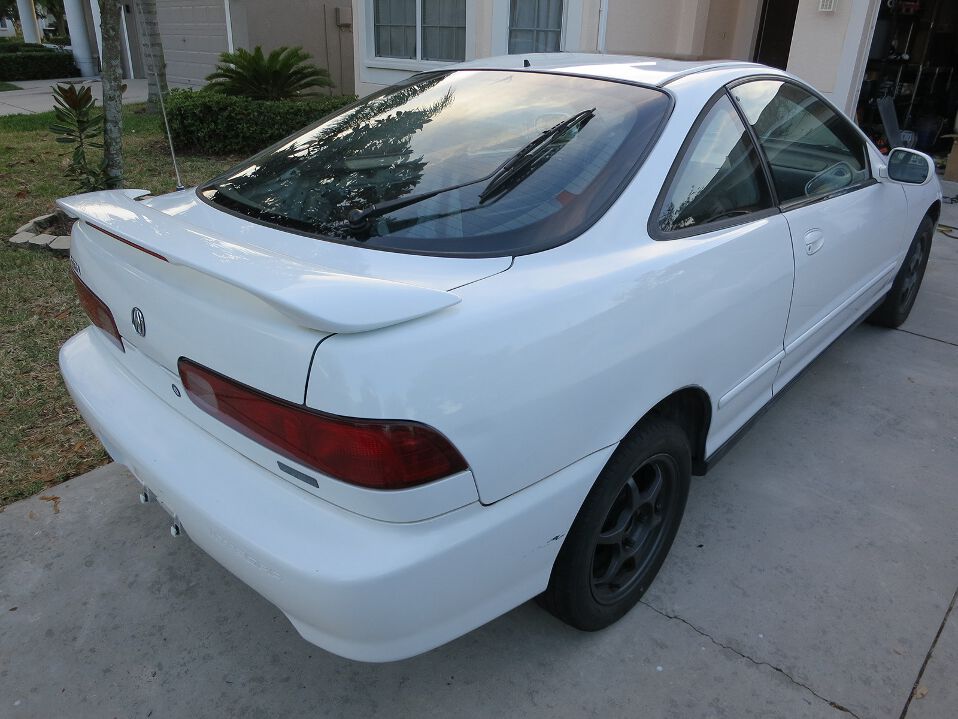

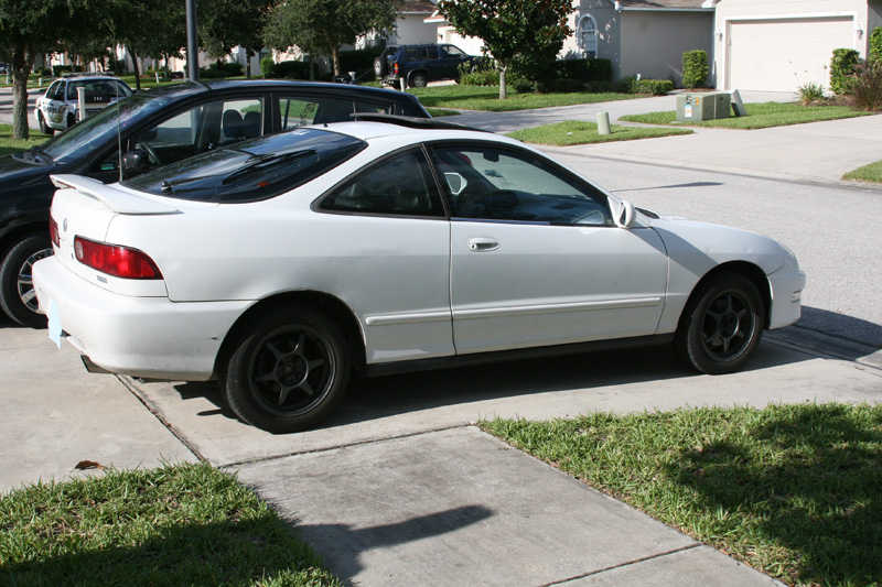

At 144K indicated I decided to sell it.. without cleaning it of course. Some interest but I never cared enough to move forward.. pics from then..

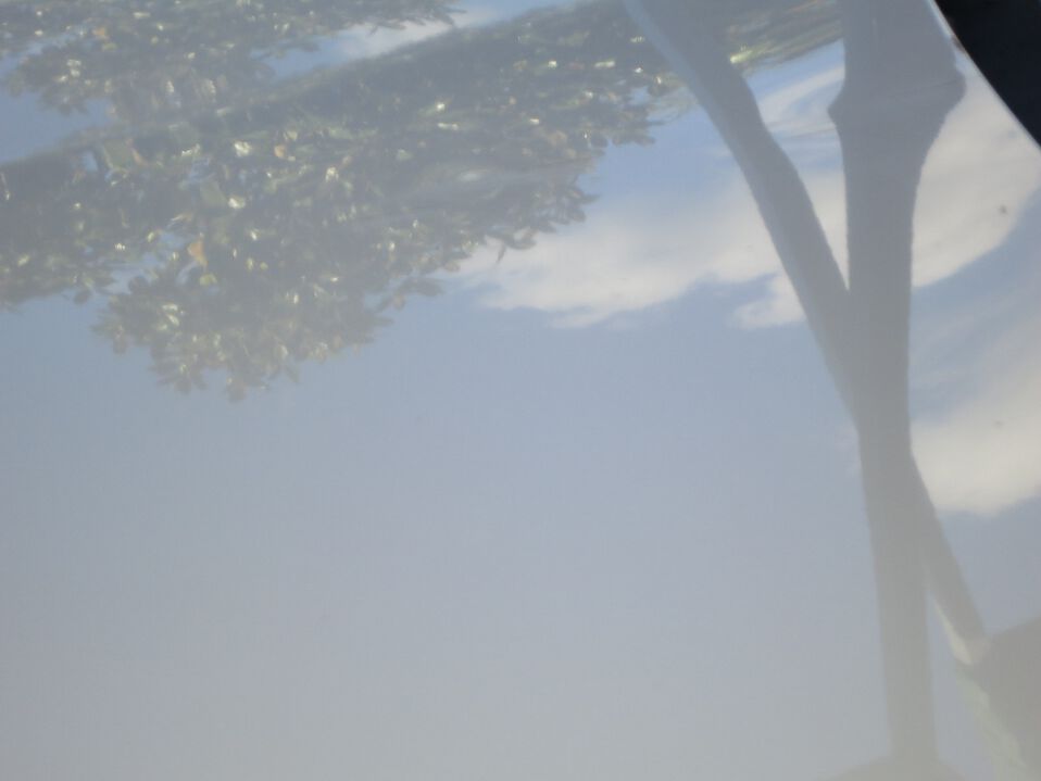

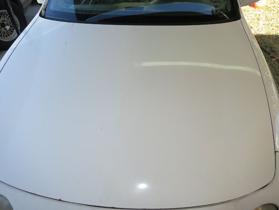

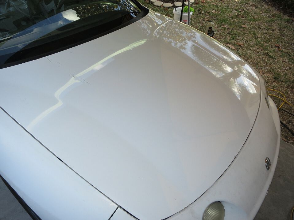

Eventually (shortly before buying the BRZ) I decided to actually.. well.. use a DA to buff and polish it.. plus fix the rollbar holes and other holes with the OEM plugs, silicone, undercoating spray, and aluminum tape..

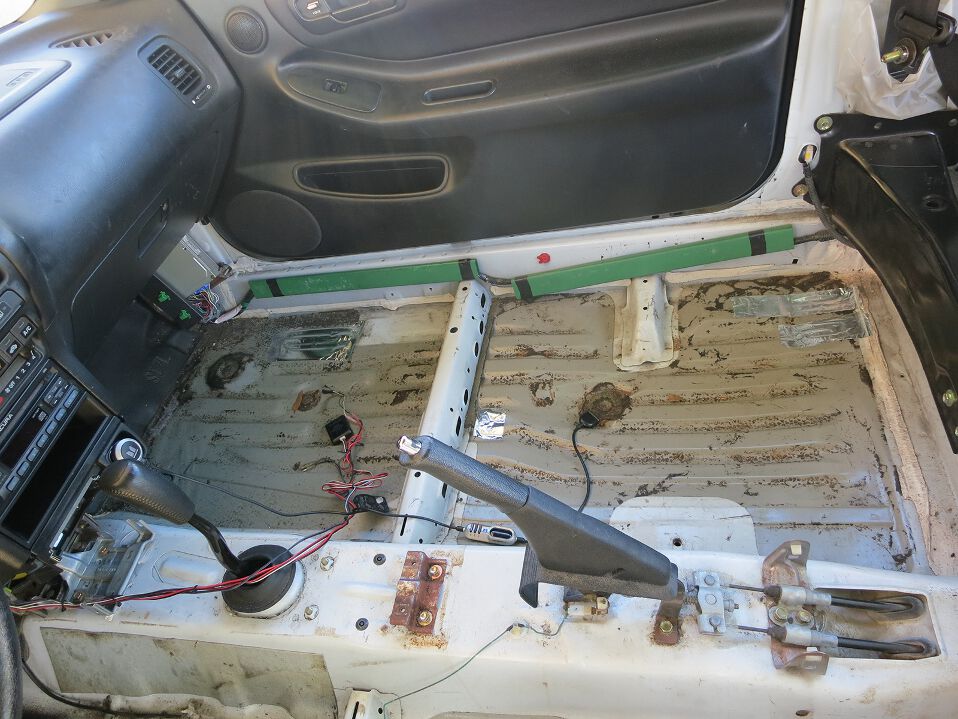

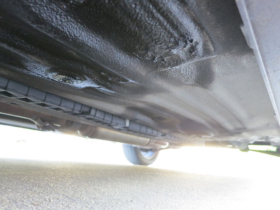

Paint...

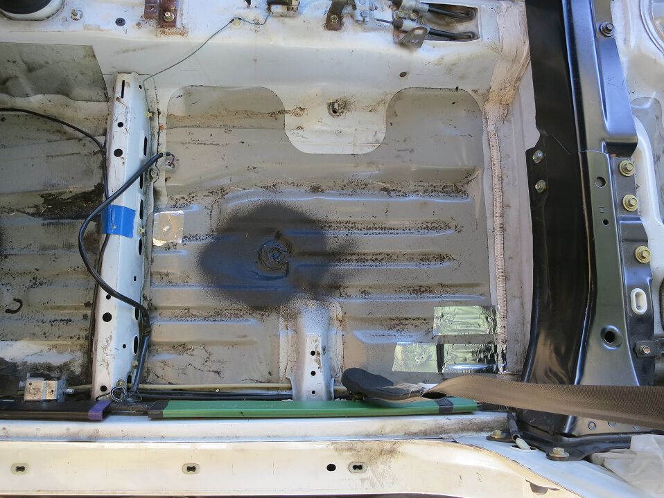

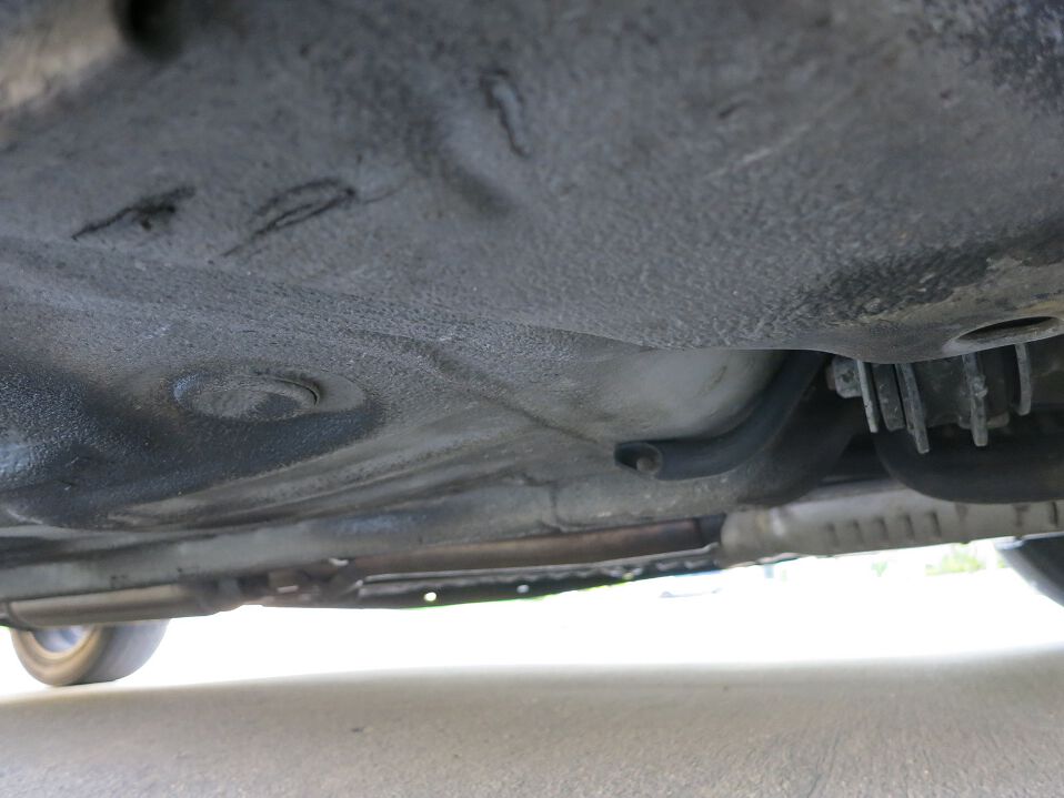

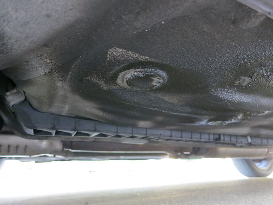

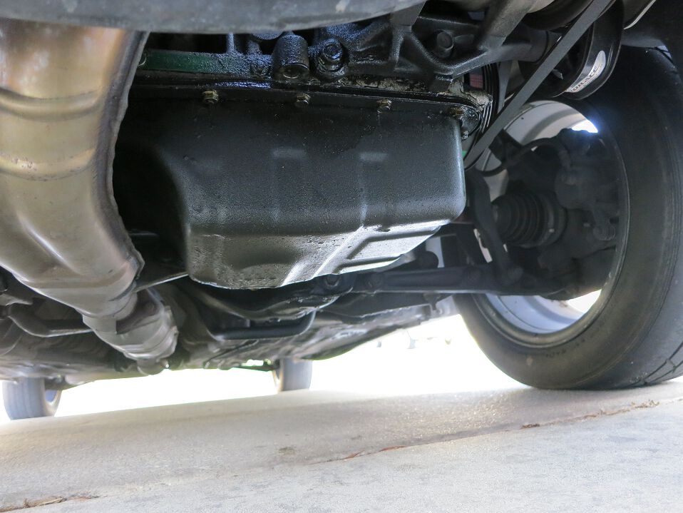

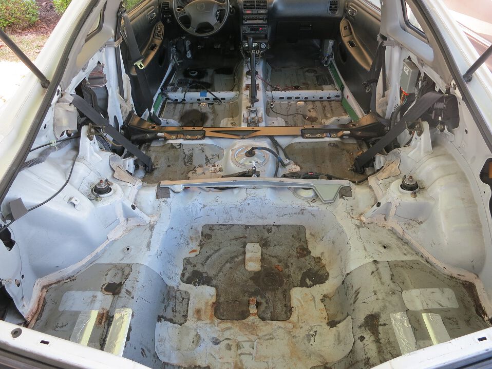

Undercarriage/roll cage holes... ripped out subframe..

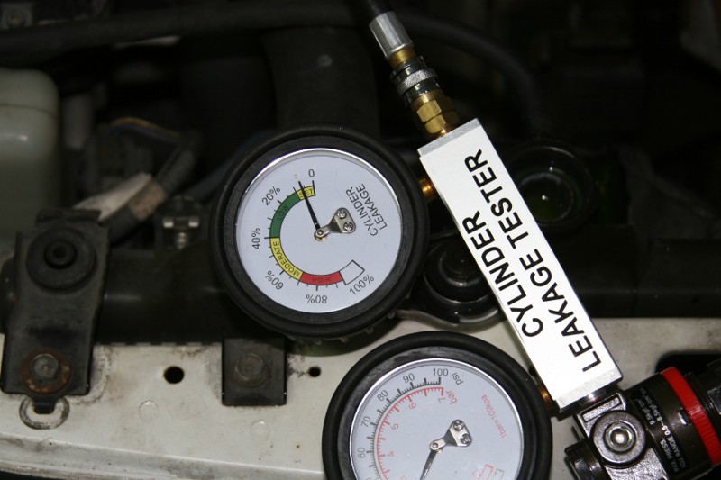

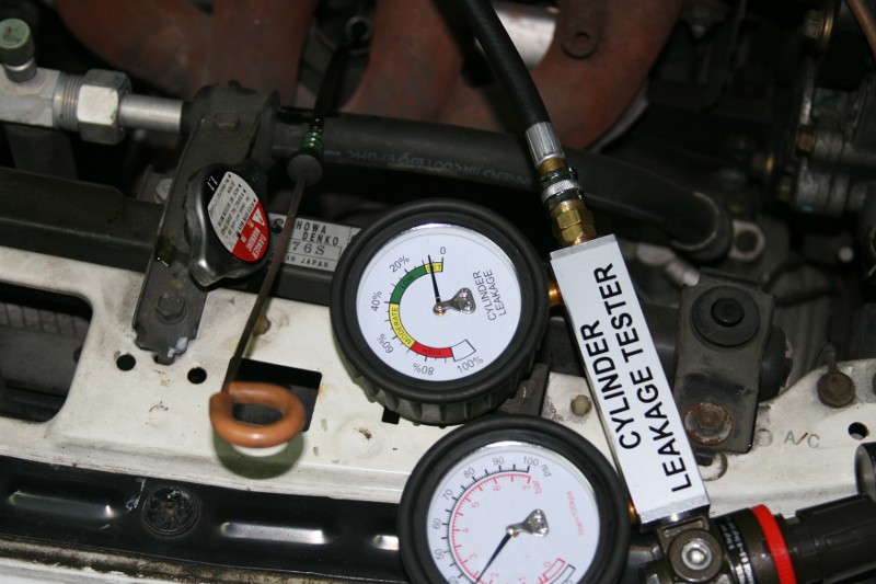

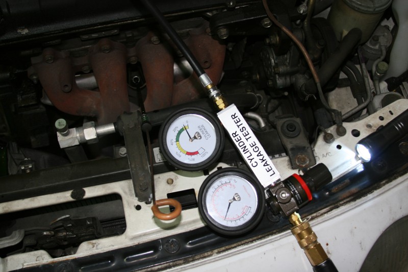

Leakdown results from about 6K ago...
Cylinder 1:
Cylinder 2:
Cylinder 3:
Cylinder 4:
Not bad considering the mileage and usage it's seen

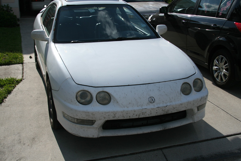

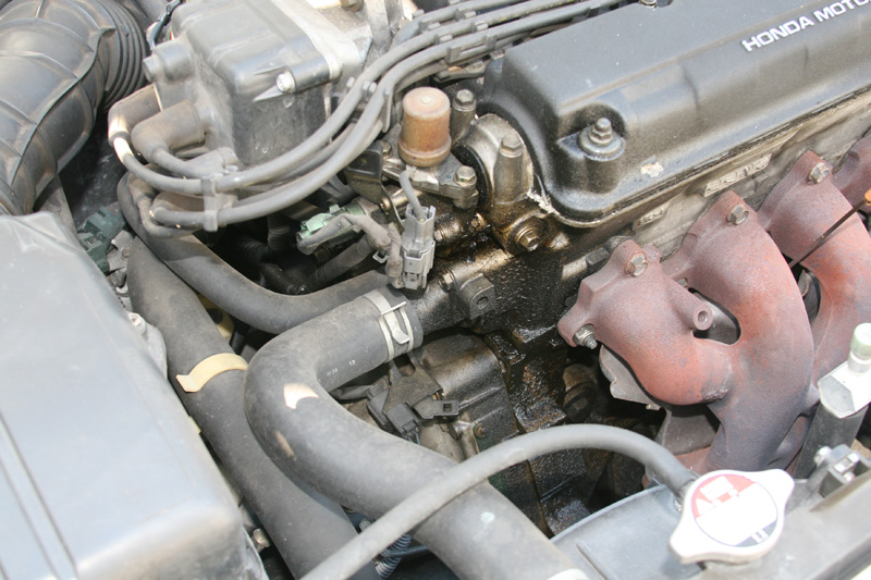

Eventually a buddy of mine was going to buy it. So I fixed a bunch of oil leaks (dist o ring, cylinder head plug, valve cover gasket, oil pan gasket, a couple others), fixed input shaft bearing, welded the subframe, etc... I'm sure I have some pics somewhere.. but I don't know where.. so skipping ahead...
So for the rebuild I decided I could do this is in one week and proceeded to order a ton of new parts. About $2,000 in just OEM Honda parts (all hoses, gaskets, rear ITR calipers, some control arms, seals, timing belt/water pump/associated bits, etc).

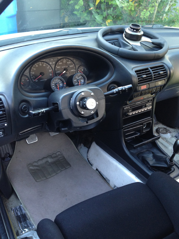

Skunk2 shift knobz y0
Momo race 350mm wheel

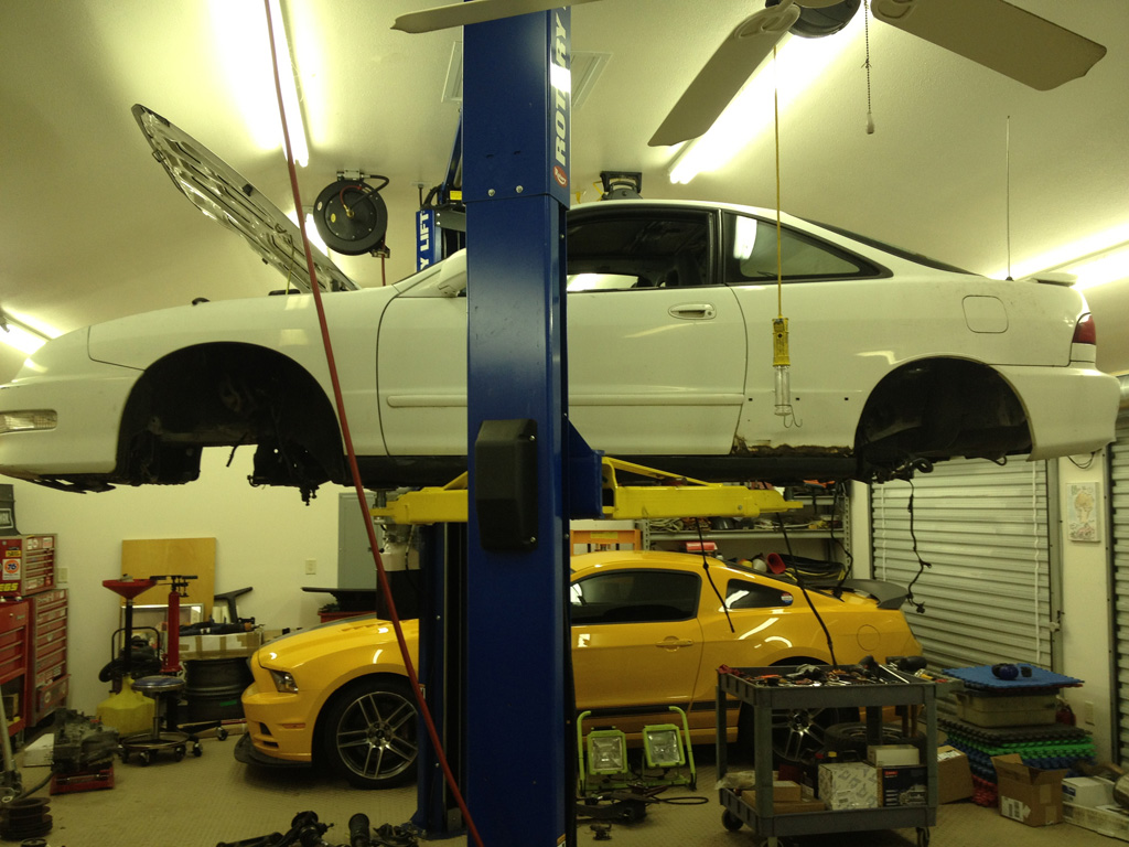

Everything removed (most of the interior, engine/trans gone, no suspension, etc)

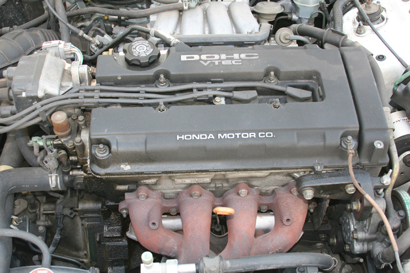

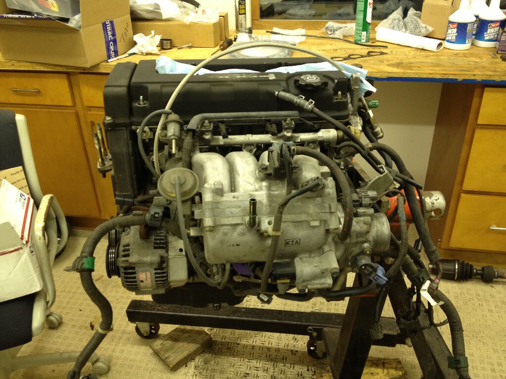

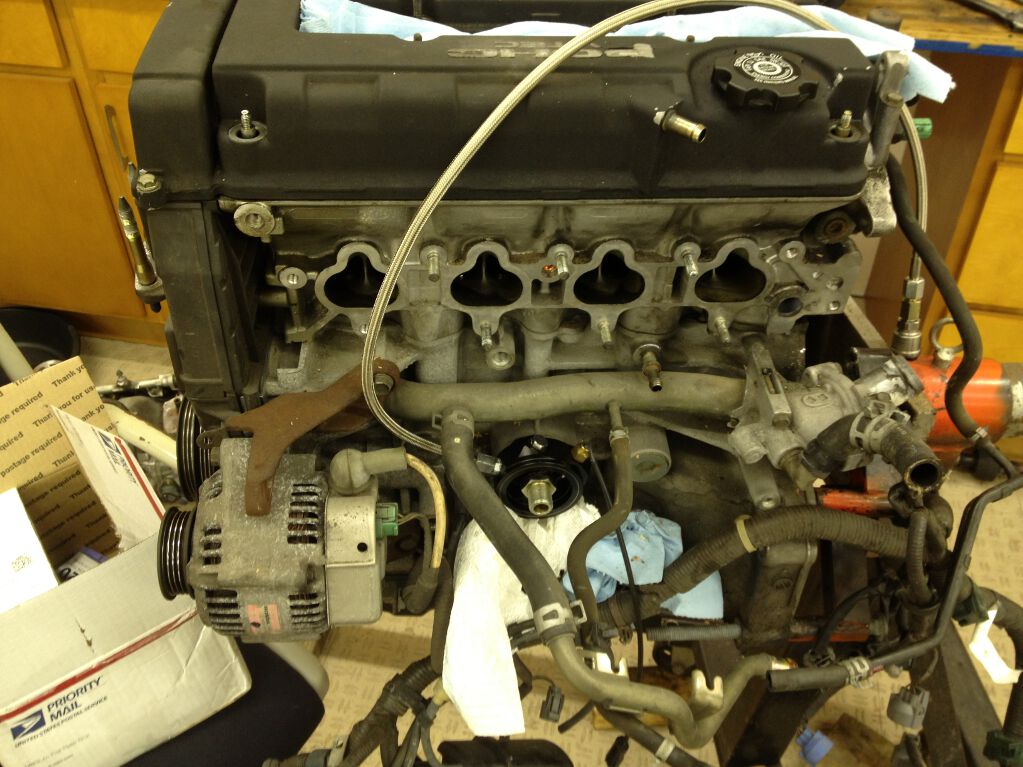

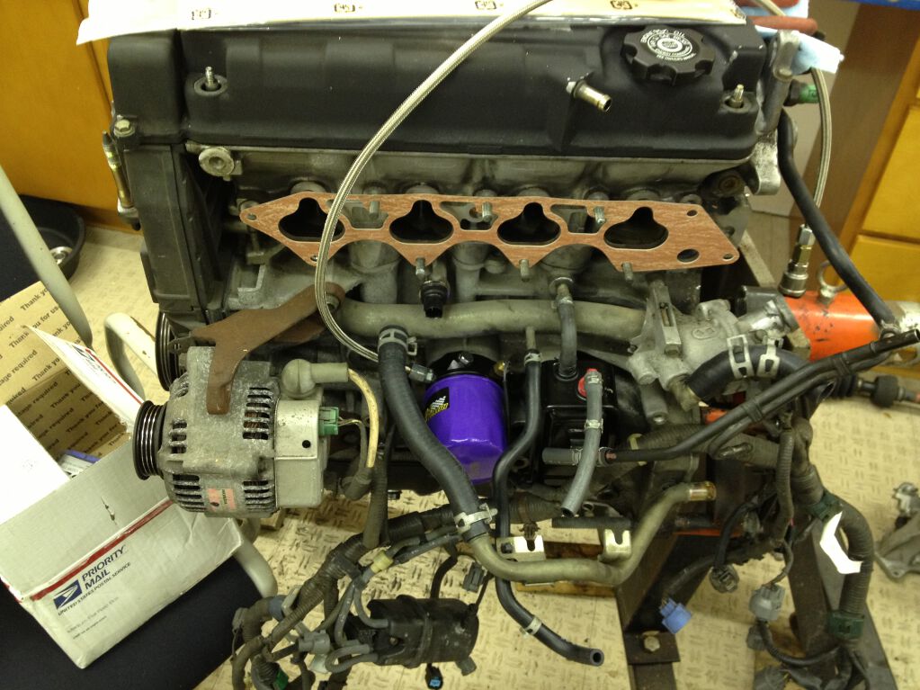

Cleaned off IM gasket material, installed sandwich plate, still has old hoses...
Oil filter installed, new gasket, new hoses, new PVC, breather box grommets, o-ring, joints, etc..
Intake manifold reinstalled (hard to torque that thing, should be "good enough" lol), wiring reconnected, vacuum lines reconnected (I haven't replaced those, probably should but then seem soft enough :shrug: famous last words I'm sure )

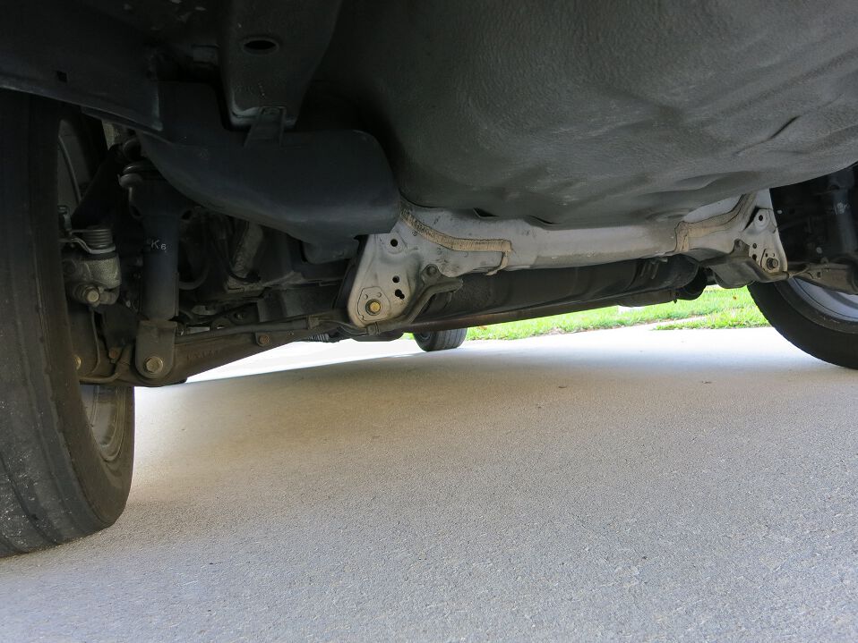

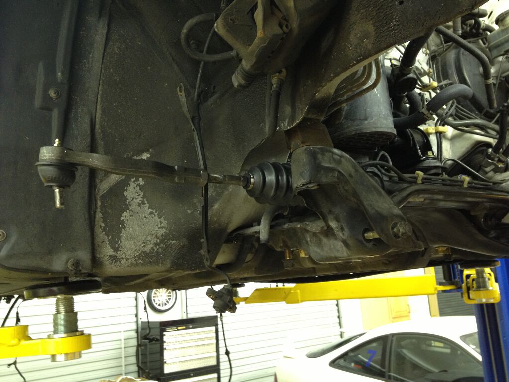

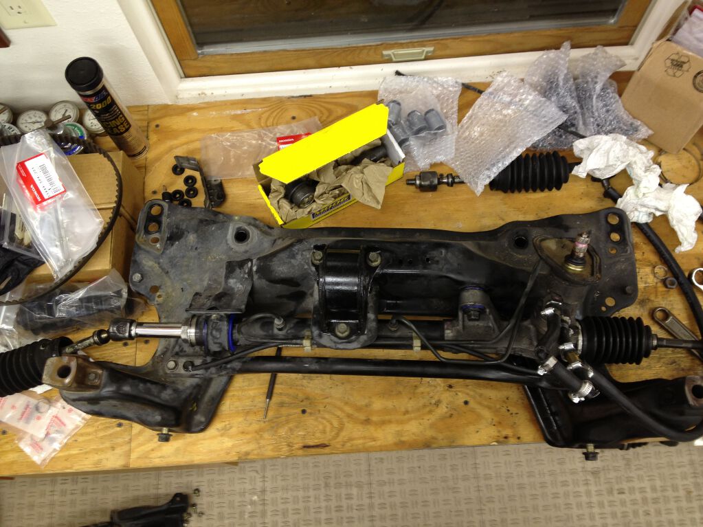

Steering rack related stuff...

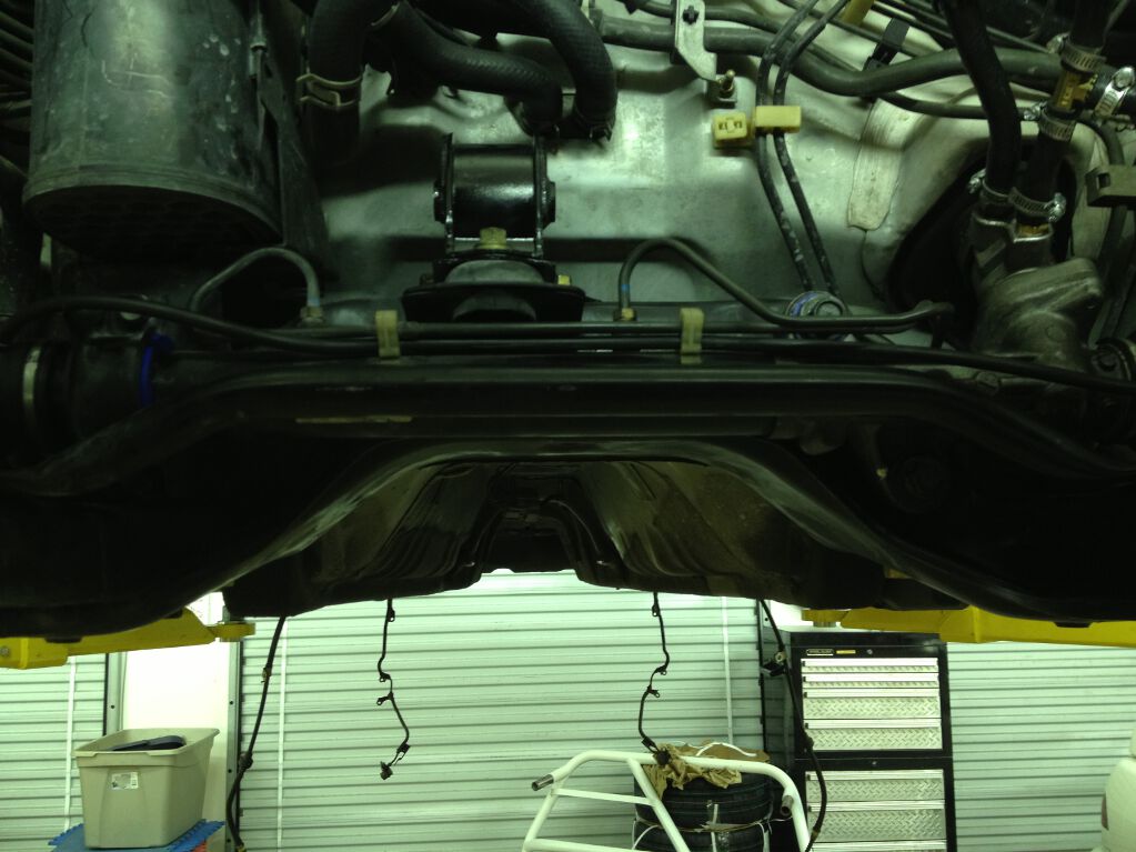

Subframe dropped, new bushings installed, one inner and outer tie rod replaced with new vent tube, bellows/bands/etc. Ghetto power steering bypass/loop.
Subframe reinstalled in the car with both outer and inners replaced, bellows, etc.
Pass side tie rod...

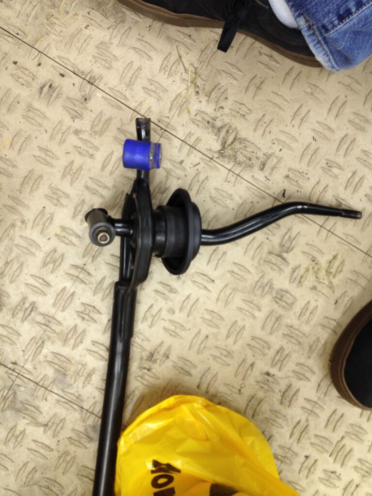

And then the shifter stabilizer/etc.. replaced both dust boots, the collar, o-rings, bushings (where the linkage connects and the white thing around the shifter ball).

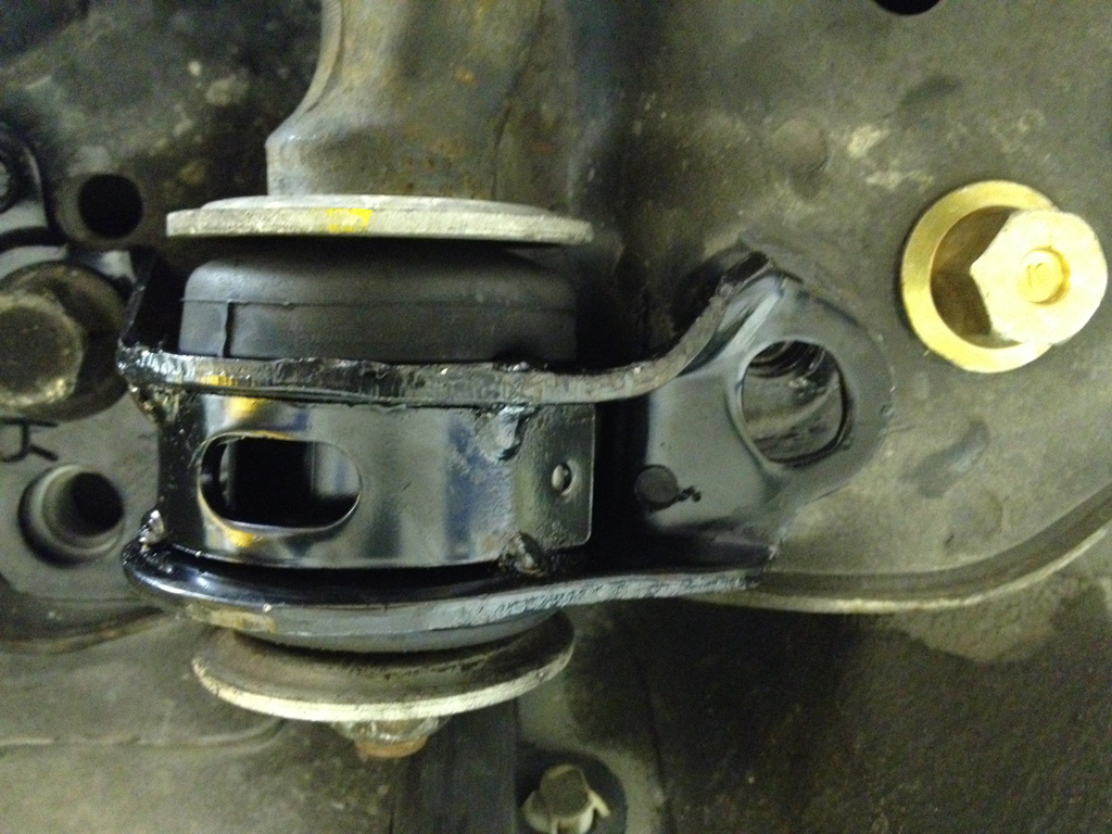

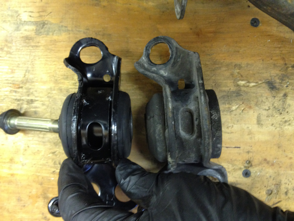

Shitty hardrace compliance bushing didn't fit on one side.. forgot to deal with this so far.
Comparison of original one and hardrace one:

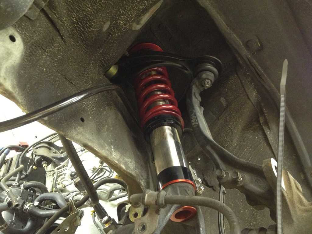

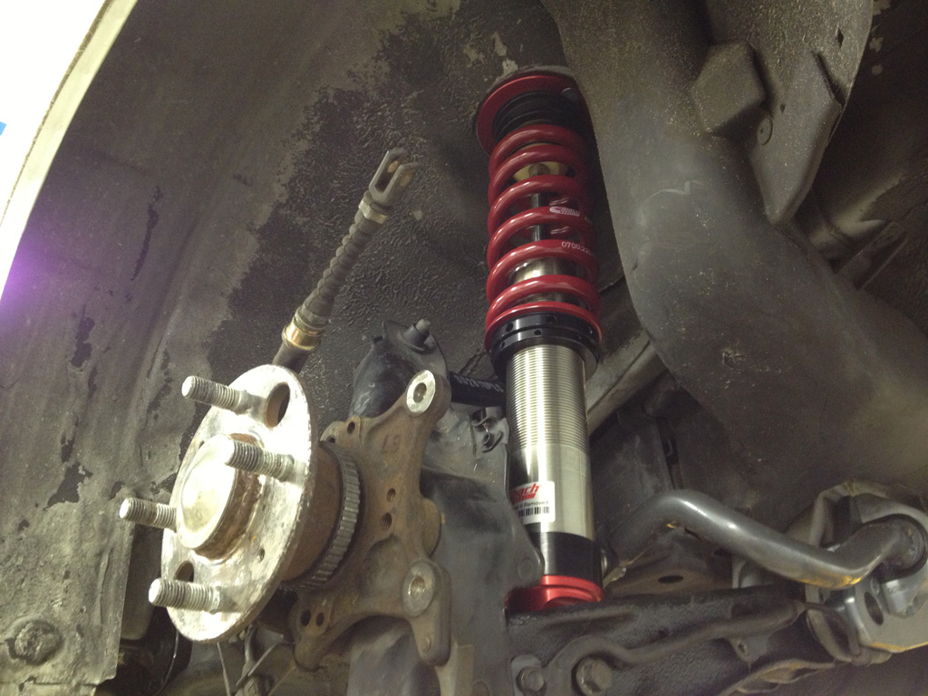

Suspension mounted. Thanks to @_MrK for shipping them to Dave “Twinkle Toes” 

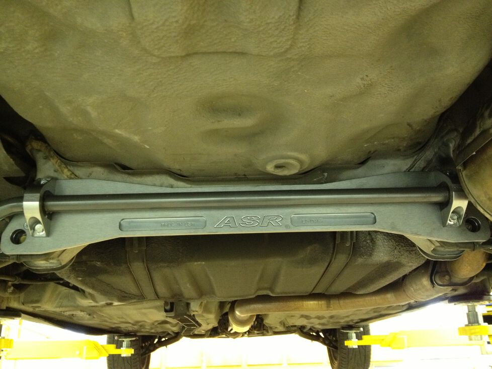

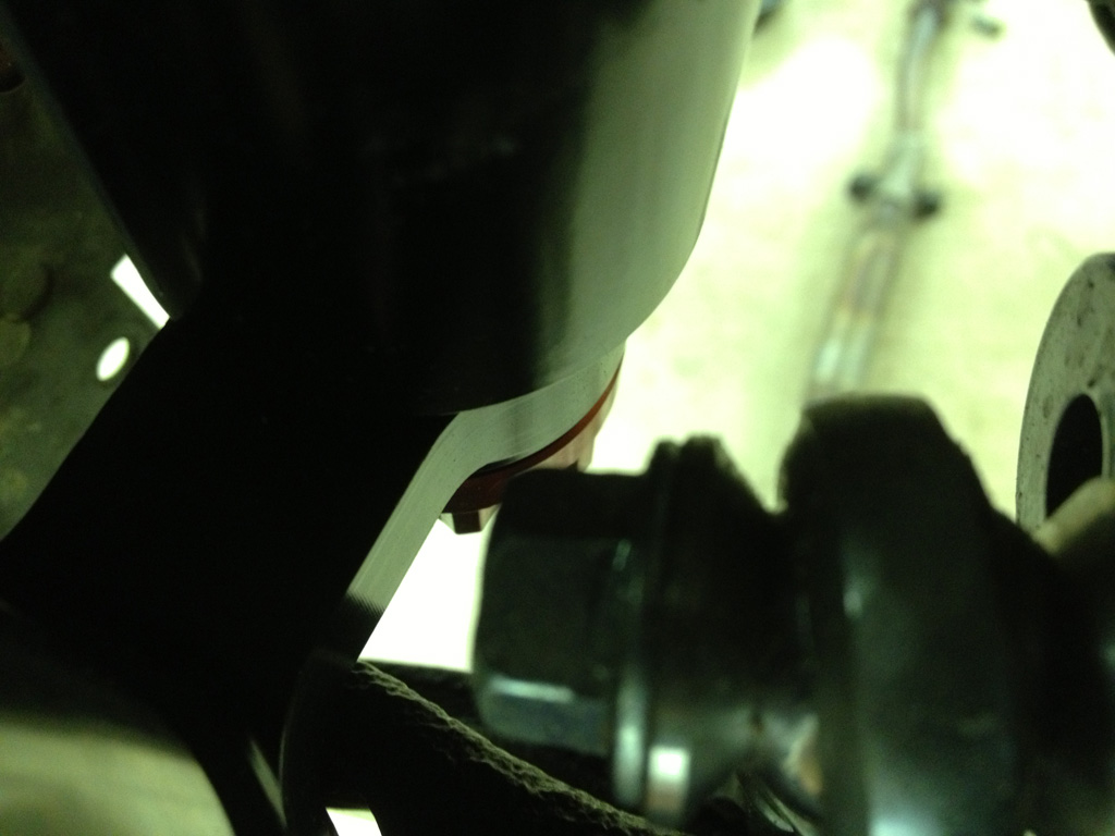

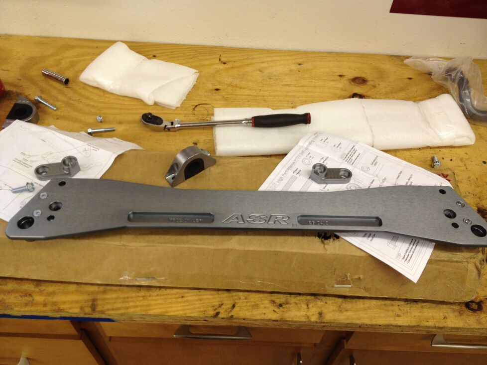

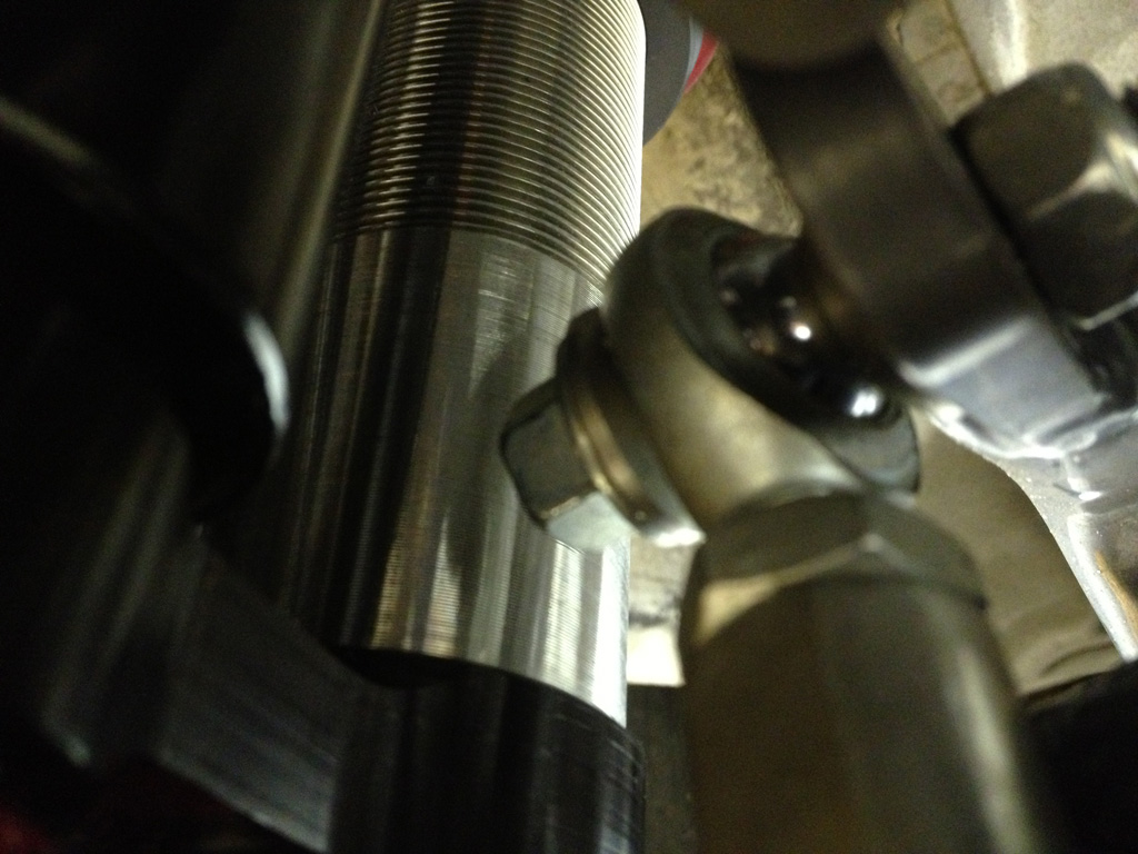

Tight clearance between rear R2s and ASR RSB endlink bolt:

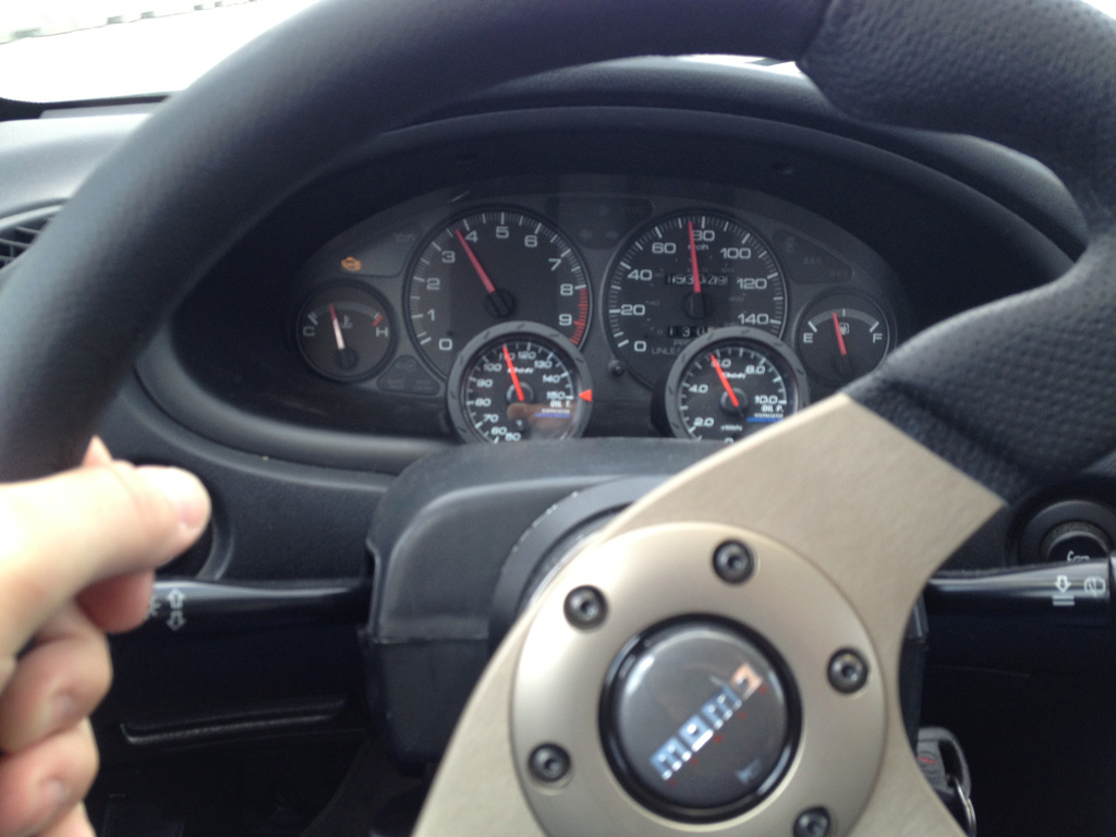

Defi Oil Temp/Pressure gauges.

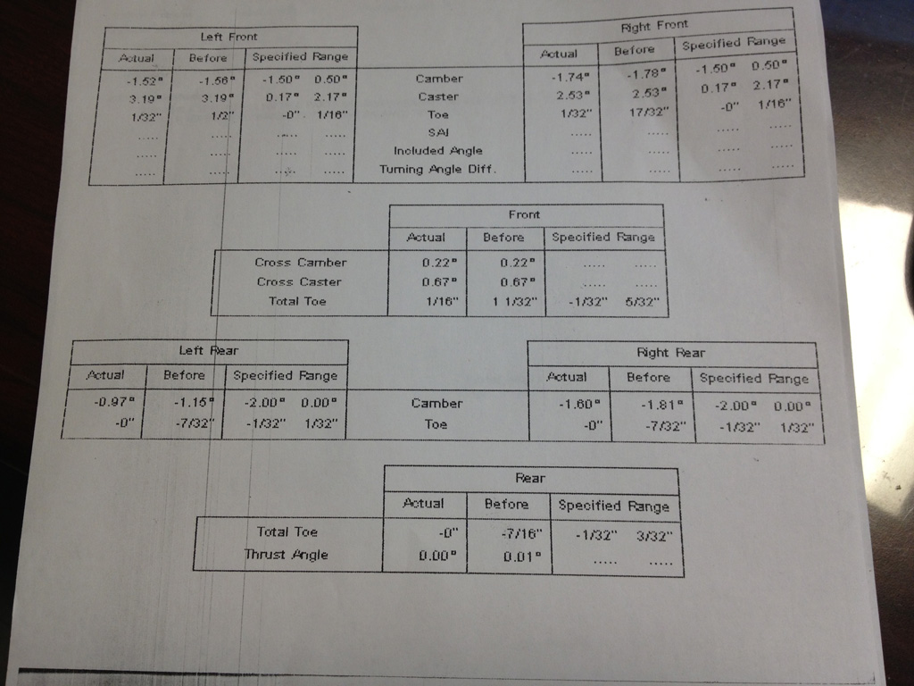

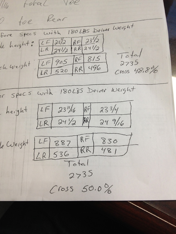

Alignment.. check the awesome before specs!
Corner balance. Weight with 180lb driver and a full tank (minus 3 miles between station and shop) is 2,735, so approx 2,475-2,500lbs without driver/gas.
So the car is ready to go. Rebuild took 8 days. It's been sitting for a few weeks since then until I got it aligned and corner balanced today. Drives much better now
