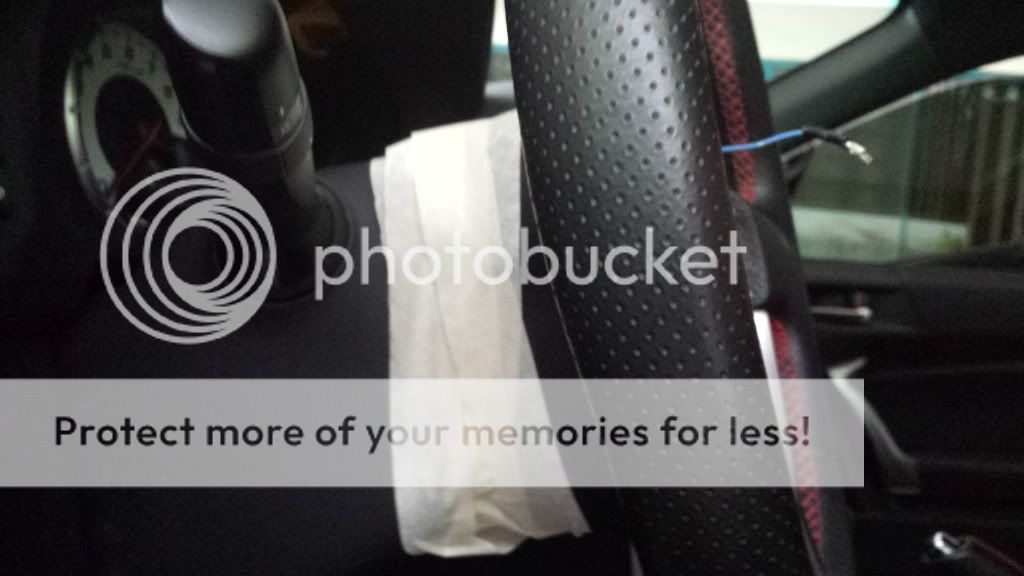

Before or after removing the airbag tape the backing of the steering wheel. This will ensure that the steering wheel remains centered.
