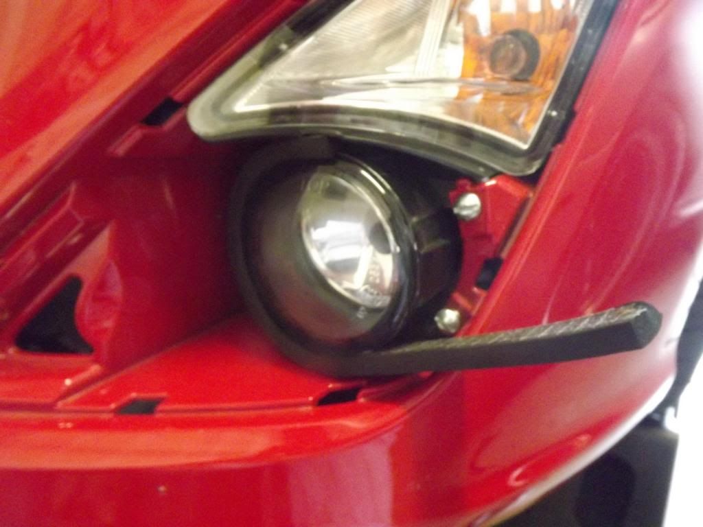

Remove bezels from car. After bezels have been removed, cut a piece of weatherstripping out that will go around the housing and place it with half the width sticking out over the edge of the housing:

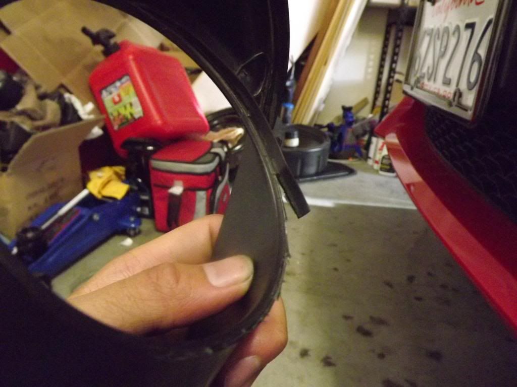

On the bezels, cut the excess plastic off the edge of the hole to make it flush:

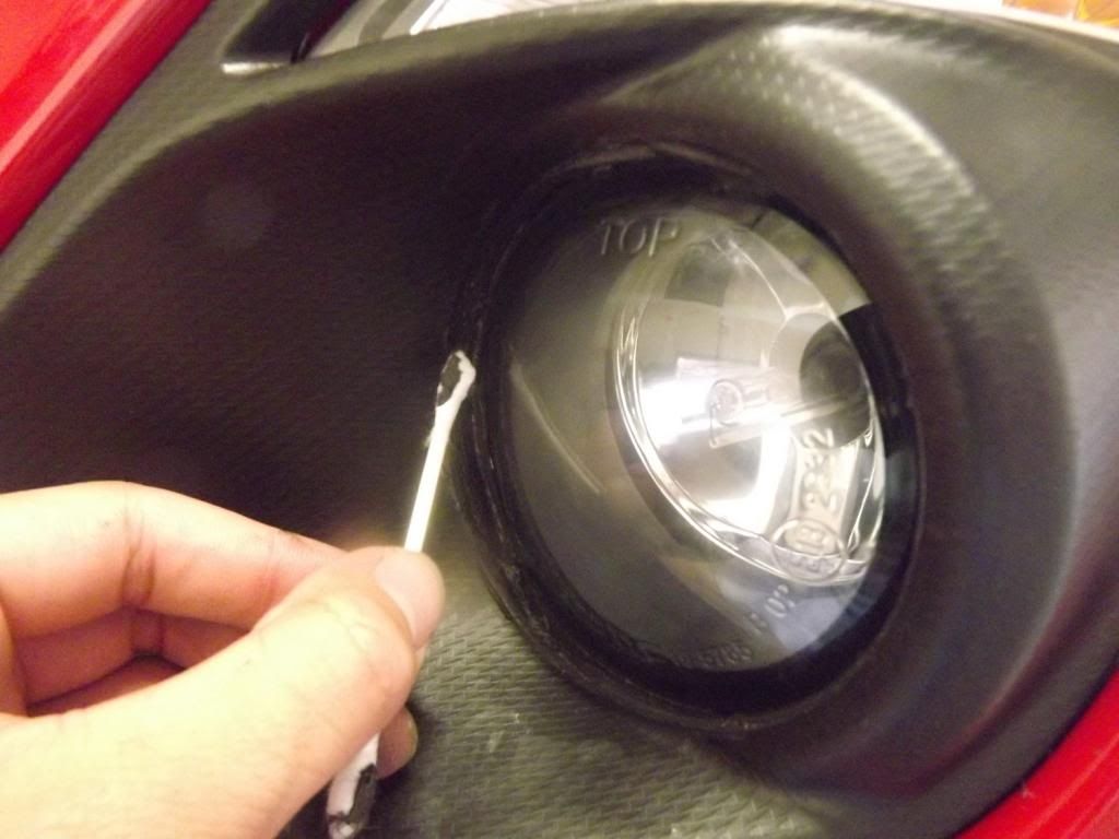

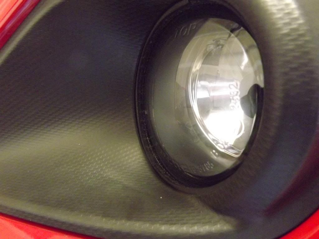

Fill in the remaining gaps with the rtv sealant/gasket maker.
Clean with cotton swabs and let cure 1 hour before driving.

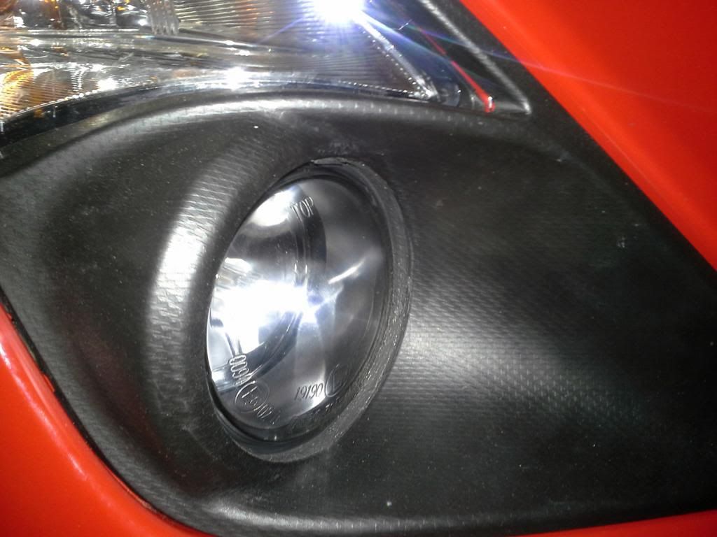

After 3 hours:
The RTV fully cures in 24 hours. I would wait that long at least before a car wash. Good luck!

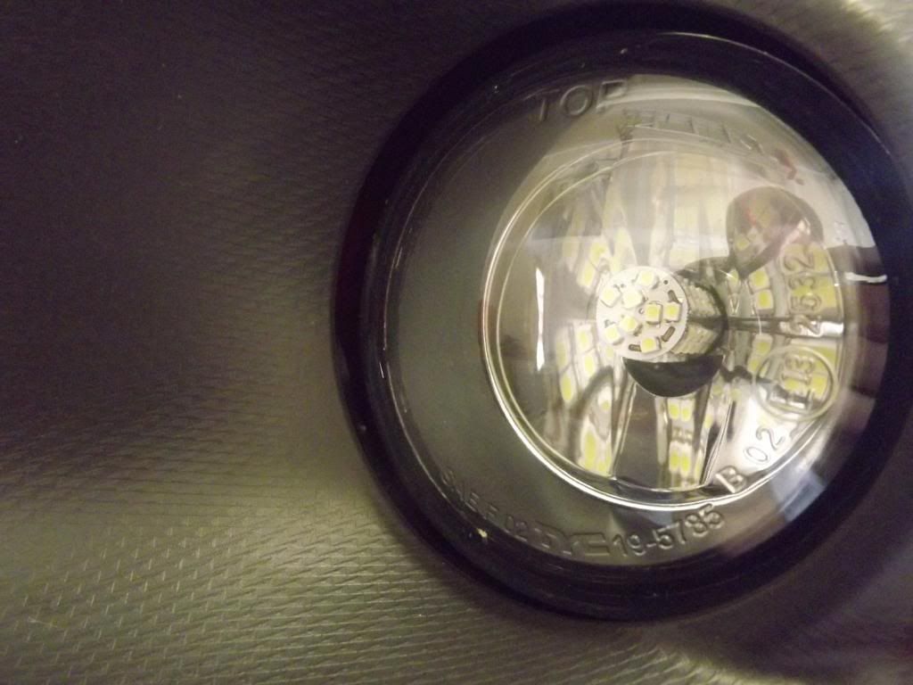

All kits have that gap. although this looks nice I dont see the point since air can no longer flow through to help keep the temp down. At some point the heat from those h11 bulbs are going to distort the assembly.
Noticed your using leds so I guess it no longer applies.

it works fine for your led bulb, but my h11 hid bulbs runs extremely hot. Although i would love the look without the gap, i have to leave it for ventilation :\
