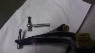

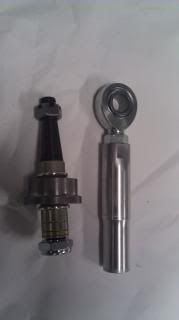

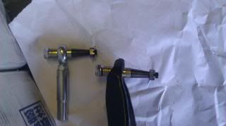

we have been doing this for the last 8 months and the sig records the results
Stock arms modified allows 3"+ drop to be corrected with included bump steer correction tierod ends.
before installation
or our full race arms (increase in NVH as all bearings are now metal).
These are track, camber, castor, roll center, and antidive adjustable.
