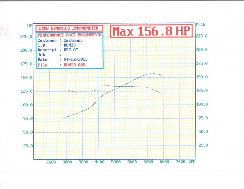

pre-tune.

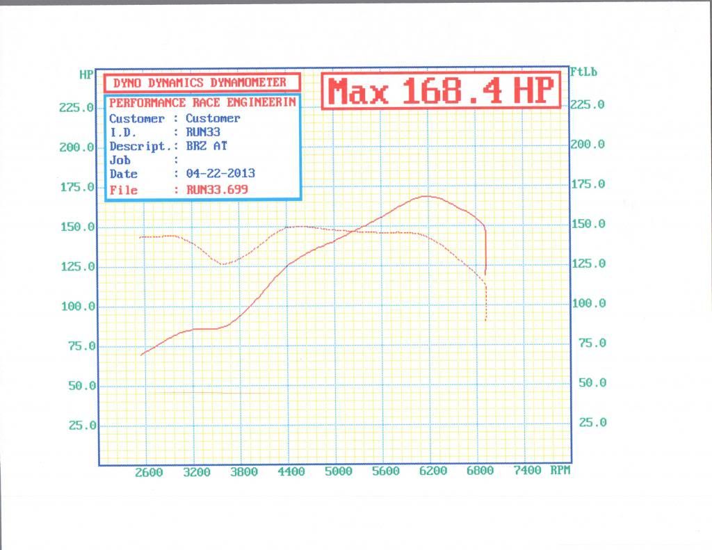

BRZedit tuned (the 3,5k dip was due to the AT converter locking up, and tuner didn't quite get the pedal timing right)

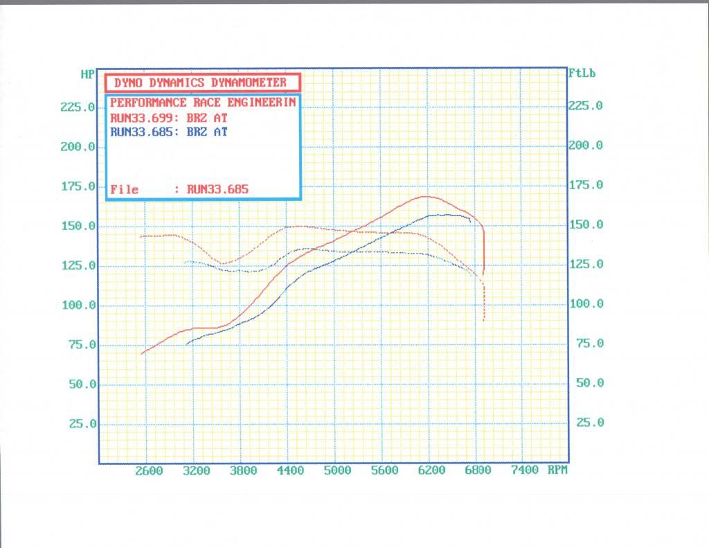

Comparison chart: Blue line is before tune, red line is after tune.
Biggest gain was the 15 torque I gained in the 4k RPM region, and 12HP top end.
My buttdyno feels that about 4.5k rpm, the car pulls harder and the power seem to be more smoothed out. By smooth, its hard to explain, but it feels as if "patches" of power loss and torque dips are much more smoothed out.
After WOT 1st gear to 2nd gear, the drop to about 5k RPM in 2nd gear pulls pretty damn good now.
I need to mess around with it more since I only drove it home from PRE, and I should be able to give a better feed back after the next AutoX event.
Over all I am pleased with the tune, and yes I know the power loss compared to MT does indeed suck. The torque converter will rob about 5 ~ 8% HP compared to MT.
This is still a conservative tune, so it is set to have my AFR to taper a bit so its not running too lean over 6k.

Get some headers on that bad boy and that dip should go away!
