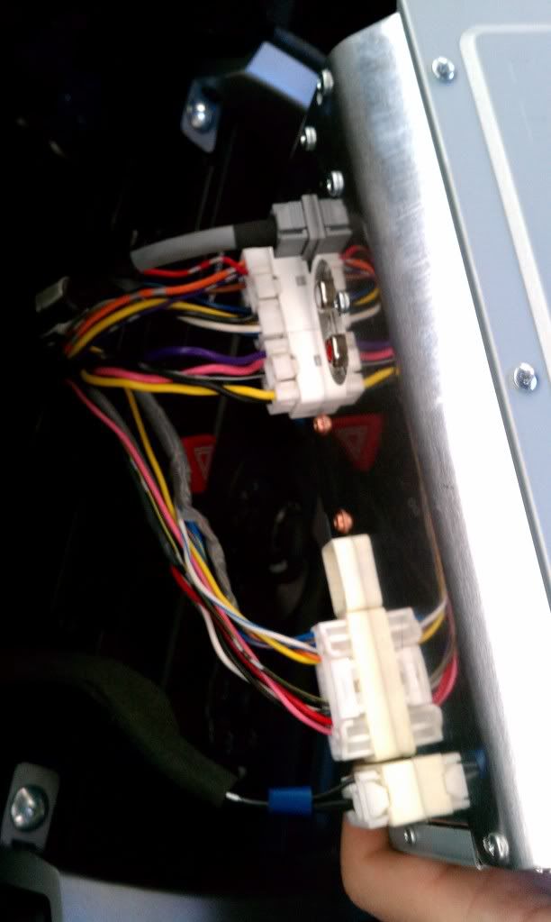

does anyone know what is this harness for, the second one, bottom to top? the 20 pin, is it really usefull, i have been searching for pinouts with no luck, i think the mic is there, but what else?
would this be accurate?
http://ae64.com/20-pin-pinout.htm
