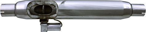

I'm going to look into the Helmoltz too if I get a catless header & exhaust.. but those equations look like jibberish to me.. just tell me how many decibels does it drecrease the noise level at 3500 rpm WOT?
Also something else that I came across.. VaraFlow Muffler! It'd be great if you could adjust the sound of your own exhaust! But I don't know of anyone who's tried this product before..
